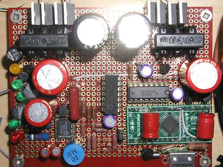

I tried this mod and posted some impressions on the AOS forum
I'd like to say a big thank you to ecdesigns for sharing this, IMHO with this mod the TDA1543 is the best I've heard it!!!
Before the mod I was using 2k7 Riken I/V, 1k5 Riken Ref , 8v supplying the TDA1543 using AN8008
I built the TDA1543 + ecdesigns mod on a separate piece of vero and tapped into the I2S lines

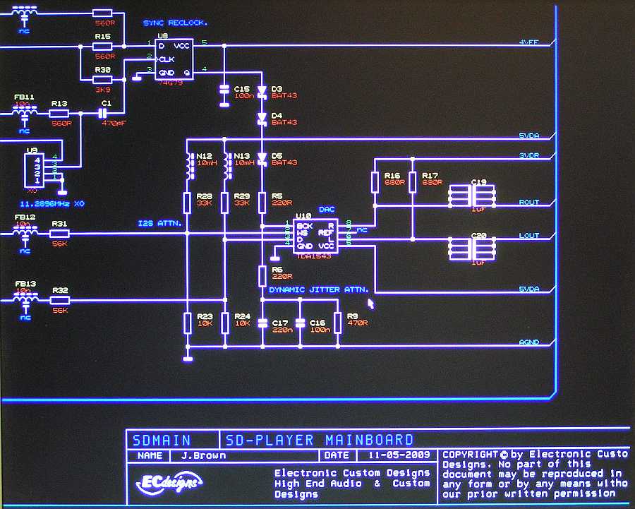

LED biased instead of battery per EC's new design?
Hey 2A3SET,
Pls visualize as it isn´t absolutely clear how you mean. Sounds interesting though.

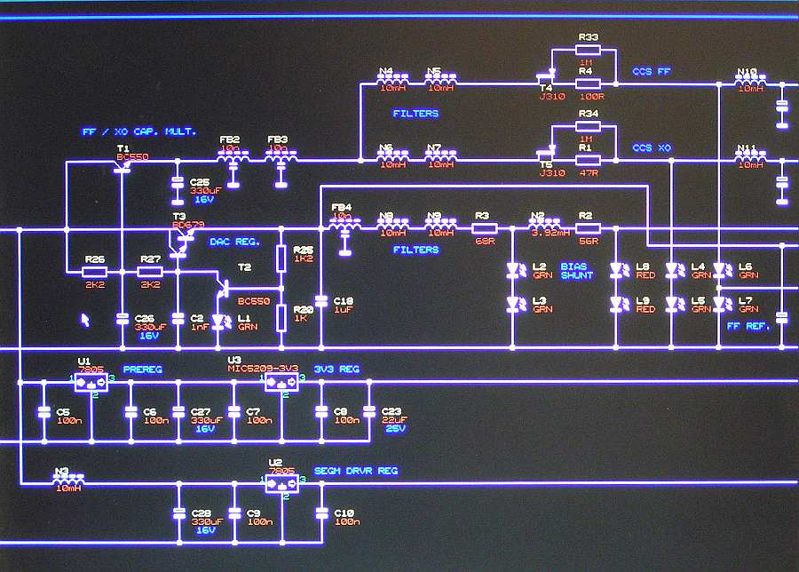

Here is EC's power reg design with LED bias
Here is EC's power reg diagram with LED bias posted in the ultimate 1541 thread. Two green LED set the voltage to 4V, then another two Red lower it to 3.2V.

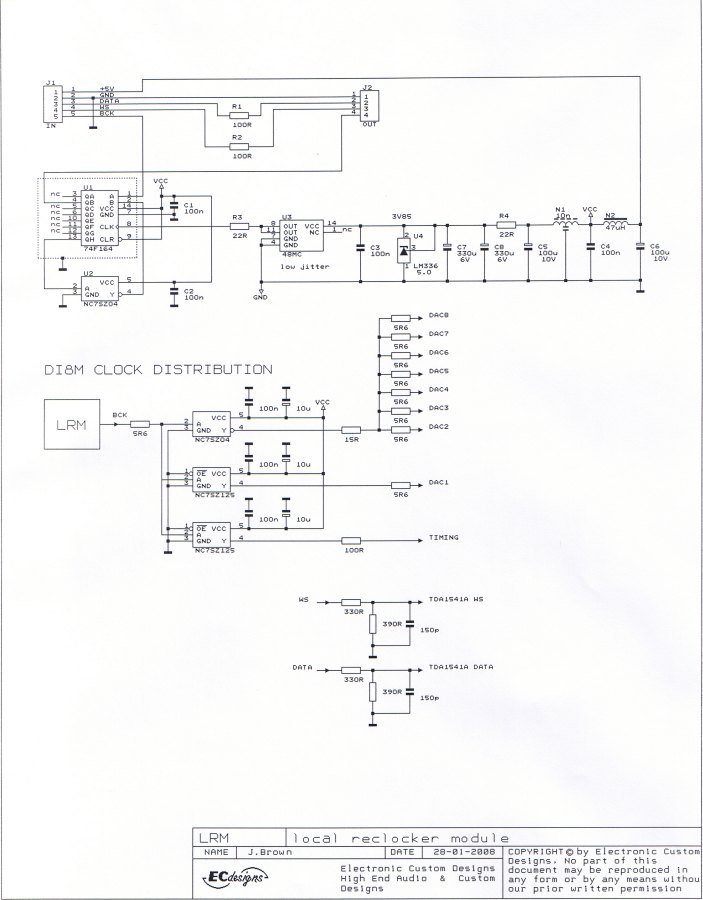

The others are async reclock part and dynamic jitter attenutator.
