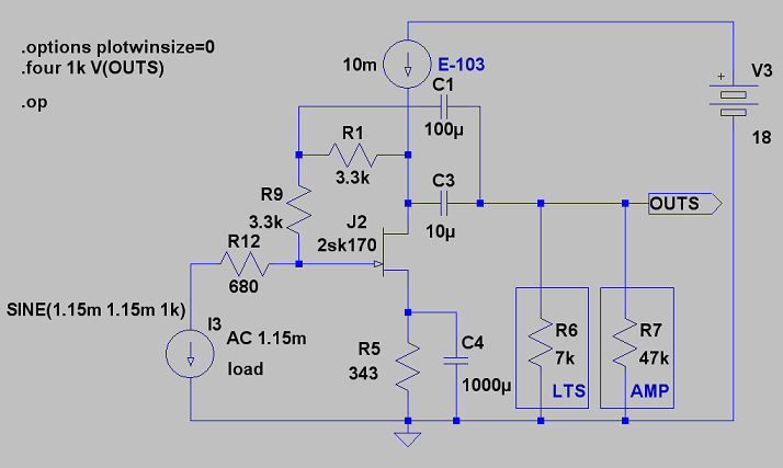

Tolu,
before you dump the 1543 you could do a minor tweak. Cut the two 2200p caps(green squares) and parallell the 1k I/V resistors with 5,6k each. If we assume 5V loading the I/Vs should be 860 ohm together with 1k ref.
Next step is to change the output lytics with plastics.
Below is an idea of a buffer where the reference-voltage is fed via the 680ohm feedback-resistor. It sims great due to the "triodish" way of working with just above 12dB gain. Zout is ca 200ohm
