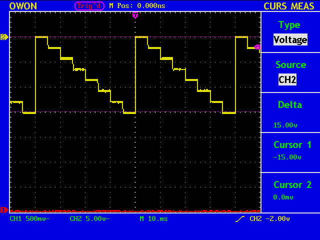

Fixed PLL divider now to 2. I get a clock signal of 200Hz. Now I can fit two grid steps in the 100Hz cycle :D
Still may need to add the phase adjustment RC network.

The reference signal in the previous post is the input to the comparator. I'm actually using a back to back transformer to get 220Vrms to drive the anode.
Today I etched the grid driver. See attached. I can get 15V peak to peak biased from +5V to -80V. I will increase the gain of the grid driver as 15V seems a bit low when it comes to power triodes...
I will post the updated diagram when I get the chance to draw the updates.

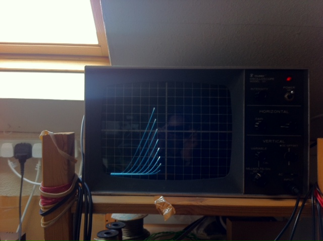

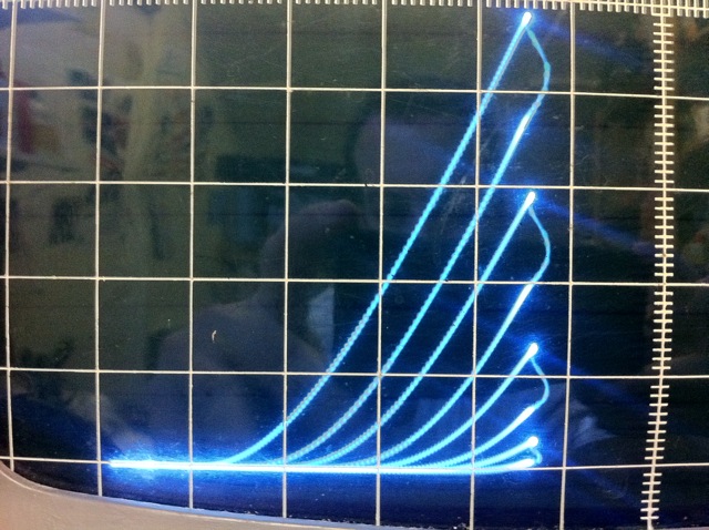

Great progress today! Hooked everything up in my messy workbench with a bit of long cables and precarious connections but anyway: it works!
I may need adding the phase correction as Alfredo suggested, but have a look at the attached image. Plotted four pairs of 46 in triode mode with great linear curves....:cool:

What kind of x-y display is that? It has a big screen. Or is it the picture that makes it look large?

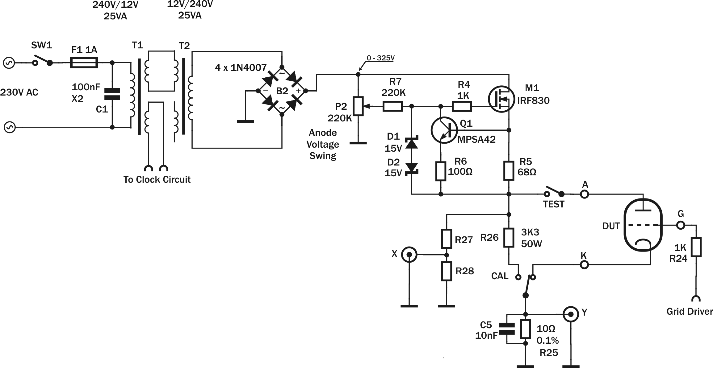

I'm using a current limiter in the Mosfet source follower as per circuit diagram attached. Currently is set to 100mA and you can see that the trace becomes brighter on the scope screen when this limit is reached.
How can you improve the PLL frequency stability? I believe that is part of the headache of synchronisation of this design.
I have a slight issue which is the trace appears to be double. I guess is this a result of lack of sync or do you think there is some other problem here?

I don't have stability issue with my PLL. You could play with the RC values as per the datasheet to improve the lock response. Dont know if the rectification makes a difference to the stability of the schmitt trigger. My schmitt trigger puts out a stable 50% duty cycle 60hz signal when fed by the low voltage 60hz sine wave.
There shouldn't be a double trace at all. Have you tried doing the phase adjustment?

The +-100 is unreg as the LME doesn't really care (from what I have seen).I am using two 70V power transformers connected in series, using the connection as center tap where I will inject the bias.
The +- 14V is a regulated power supply with a LM317 and a LM337.
The Bias supply is a variable regulated supply with a TL783. The whole thing is floating so I hope I can use it as a negative supply.

I'm using a 10 ohm cathode current sense resistor bypassed by a 10n capacitor. Then feeding the differential voltage to the similar dif amplifier that Goote posted early in this thread. This 10x amplifier provides also an inversion of the signal as my oscilloscope didn't have one...

Had a terrible day today: XY scope died and managed to fix it and re-calibrate somehow. I found that is the scope circuit which is creating the double traces. No idea of what could be, but probably will require a lot of effort to find the root cause. Considering that it costed me only 25 pounds I'd probably leave it as it is...
The other thing I found was that it takes some time for the PLL to stabilise. Not sure if this is normal or expected, however when I do vary the grid signal driver it appears to have some interference with the PLL and takes a bit of extra time to get back in sync. :confused:

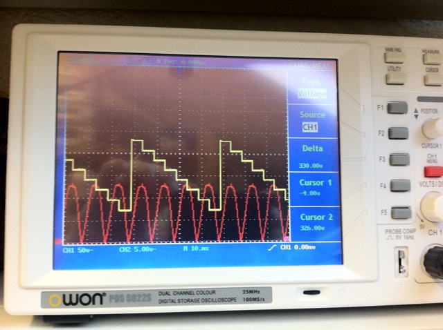

Today I finished the driver board and did a quick test. BTW, a few weeks ago I received a new Rigol DS1102E oscilloscope. I like it a lot. The display is not as clean as with the Analog scope but it has many nice features, especially acquiring the data for the computer. It is what I am planning to use to capture the curve data.
A 15 Volt PP signal, 1 Volt/step
A 150 Volt PP signal, 10 Volt/step
Alex, I also played a little with the PLL and the filter. I found that if you add a resistor of 100K-300K above the capacitor that it locks very quickly.
