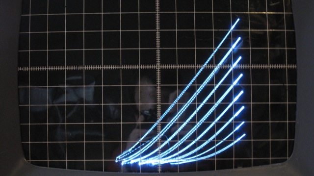

With help (and a lot of patience) from Steven Parfitt (TheGimp) the belated project of my curve tracer is coming along. Still a breadboard setup but works.
Clock is derived from rectified mains (clock of 100Hz in UK) and 8 curves are plotted. Refresh is acceptable, but not perfect. However, the circuit is much simpler this way.
Attached is a sample test of a 45 valve
Will post more details later...

Looking good Mogliaa

Originally my plan was to produce a negative and positive grid driver to enable testing of power tubes with positive grid current. TheGimp helped me out in designing the driver with op amps, MOSFET stages and feedback loop. I gave up when trying to stabilise the circuit so ended up with a simplified version with op amp to set bias and a couple of P MOSFETS.
The staircase is a CD4520 counter from the mains clock as per Merlin's design.
Anode sweep is also mains rectified and a MOSFET in source follower driving the valve. Have a pair of 230/24V back to back transformers which after rectification give about 350V max sweep.
At the moment the blurred lines or double lines on the curves are due to the breadboard noise and long cables. My current sensing resistor is 10 ohms which then provides the Y signal for amplification via a differential amplifier and inverter as per Goote's design above.
Need to etch the PCB and see if gets ok in the end, with a sharper set of curves once everything is tightly wired and shielded.....

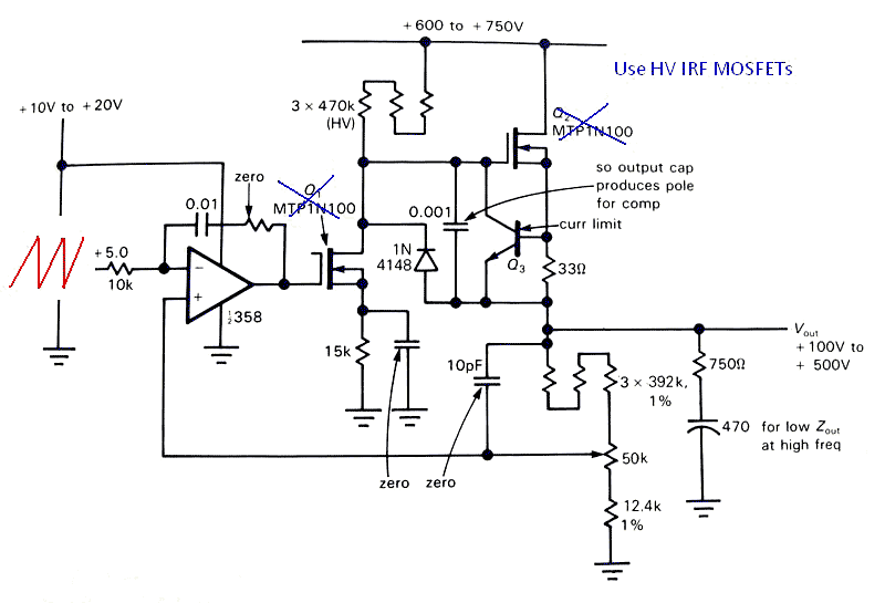

I used a variant of this supply from "The Art of Electronics" for my tube tracer article in AX about 9 years ago -- but I explicitly set the bias for the first MOSFET -- if you work with the loop compensation you can get a very linear HV supply which will swing 400 or 500 volts. I used a 10 bit DAC for the ramp generator:
Attached is what I'm using as the grid driver. I feed the output of the CD4520 counter resistor ladder on to the op amp. With this circuit you can easily generate all ramps required starting from 1V steps. Is handy enough and reduce complexity of the overall circuit.....
Hi Jackinnj
Is your article available somewhere for download?
On your drawing, are you talking about biasing Mosfet itself or about shifting the ramp up or down within a range (with no amplification).
Alfredo

I think i need something similar to this, but need to play with the LME49810 rails.
I think the ground connection needs to be virtual otherwise I would loose the benefit of the full voltage swing.

1) I don't think that they have PDF's of the article -- it's ancient history at this point and I know a lot of things I would do differently.
2) The steps were generated by a 10 bit Maxim DAC and I just used a bit-banging RS-232 program to generate the steps -- quite slow back then. There several ways to bias the first MOSFET -- but you can just get a DAC with an outboard reference provision.
