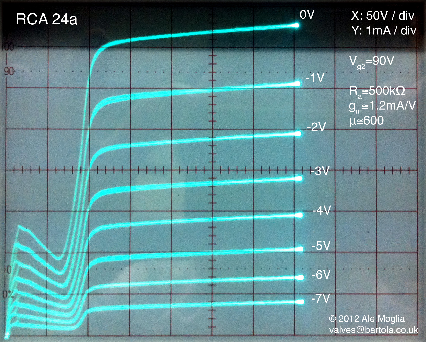

Nothing new to report... but here are some shots I took today with and without power grid/RF interference, quite a big difference as you can see...

Second trace looks really good. What is the difference between the two, just interference?
Have you tried removing the grid stopper or using 10/100 ohms? Lower value will definitely help specially if you are using a ferrite bead in the grid cable just right at the socket pin. If you are careful enough not to overheat the grid you will be able to see a proper curve for 0V grid bias.

Nothing is different other than the time of day - during business hours, I get crazy interference, basically rendering the tracer useless.:mad: I tried the line filter too, alas it's no use against such outrageous level of interference...
BTW, the valve shown is a 5881/6L6 type triode-strapped and the vertical scale is 50mA/div. My plate transformer is already running out of juice, so I can't go much beyond 300V at the moment. All the cable for the sense lines are shielded, and ferrite beads are place close to the pins of the individual tube sockets. The grid stop resistors are selectable 100, 1K or 10K, but I need to move them closer to the tube pins when I re-do the layout. When there is no interference, I can almost get away with no stopper, with the darn interference, even 10k can't do anything...

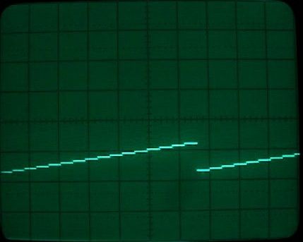

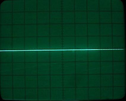

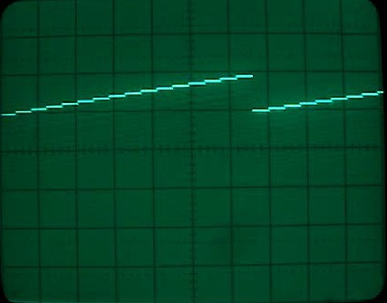

Hi Jaz
I do have control in the positive area although I rarely use it. I use the bias level all the time to match against the zero curve.
I have three pictures, the zero reference, one step family below zero and one above it. I do have individual control of step size an steps per family. Vertical is at 20V/division.
I also recorded a short video so you can see the operation.
link to short video
