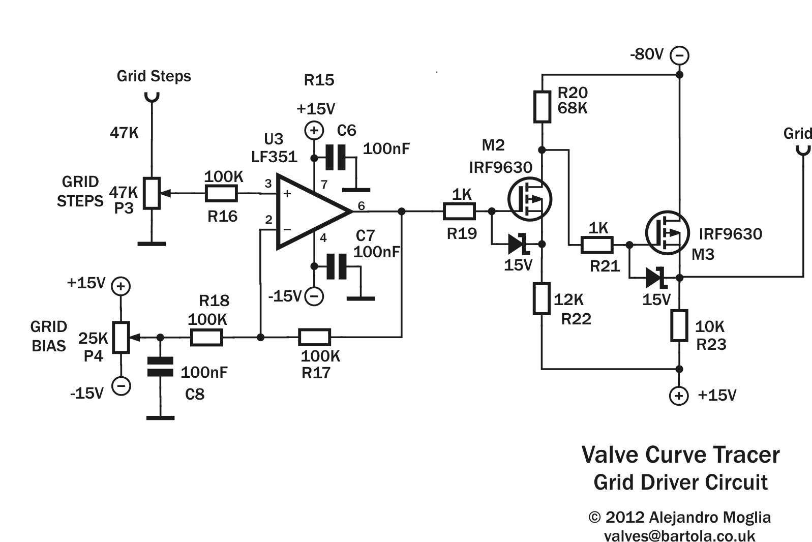

Thanks, guys! Couldn't have gotten this far without your guidance... I am still struggling with the grid drive circuit, the leftmost curve that you see in fact is not quite at Vg=0, since the circuit breaks into oscillation as Vg approaches zero let alone going above zero.
Ale, on your schematic, you showed the IRF9630's as two source followers, is that what you are using? In my version, the second 9630 is driven from the drain of the first 9630 instead, otherwise I could not get the swing required.
Alfred, I do have plate limiting resistors like the Tektronix (and your schematic), I just did not turn it up far enough when the shot was taken.
Here is the latest gate drive circuit (taken from one of drawings from TheGimp), it sims fine, but does not work as is in my setup...

Hi Jaz,
Here is the driver. I think I ended up adding a drain resistor in the output mosfet to protect it in case of grid shorts. Other than that, this works brilliantly for me...

I tried your values just now, and the result was the same... Vg=0 gets distorted when the grid current begins to flow. No problem with the small signal triodes since they don't draw much grid current (at least the ones I tried).
Also, even with 15V on the source, it still does not pull above 0, so no way to trace Vg>0, I'm still not sure why that would be the case, as the sim showed that it should be able to pull above 0.

I do see that your drawing shows the grid signal being taken from the Drain. Ale shows his on the Source. It probably makes a difference.
It is taken from the source, I just flipped the FET's on the drawing. If I can get the LME49810 and an appropriate xfmr, I may give your version a try.

Hi Jaz,
Well, not sure what bias voltages you have on the FETs. Are u using same power supplies, 5 instead of 15V will make an impact and you will need to change the resistor values.
Looking at your first step is clearly sign of grid current. What grid stopper are u using? I have a switch to select from 0, 100 and 1k resistor I think. I do play with it when this is the case...

Ale,
Everything was the same as your drawing. The grid stopper was 1K, tried 10K as well - same result. As I already made a mess of the breadboard, I will re-do it again properly and see if the wiring/layout makes a difference.

Yes, I deleted it. I thought I had found a solution to the grid drive (pulling above zero), but it turned out to be short-lived. This was what happened, I did some tests with an IRF840 as the source follower and put +100V on its drain, -100V on its source via a 22K resistor. The waveform looked great without the TUT, when I plug it in and switched on the heater, then the top step got squashed again, anyway, now I can get a solid Vg=0 but not much above that, I don't understand what's happening, need to go back to the textbooks to see how the heater voltage affect the grid, why is it acting like a clamp on the positive grid voltage? Will report back once I get a handle on it, or if you already know the answer, kindly share it with me.

I think what you're experiencing is a lot of grid current. When near 0V or above you will get current flowing through the grid and this creating a voltage drop across the grid resistor which will turn off the FET depending on the bias used.

Hi Jaz,
Simply because the grid/cathode space become a forward biased diode when a positive voltage is applied to the grid.
The grid becomes a small anode and "sink" some so called "grid current".

Hi Yves,
I will let all it sink in. In the meantime, also found this:
Grid stoppers with AB2 which is relevant to the discussion, I think... It appears that I went overboard with the drain voltage and using a large NMOS like IRF840 probably isn't a good idea either (well that was what I had on hand), so I will try a smaller source follower at lower voltage and move the grid stop resistor closer to the gate (too far now with long wires). Getting there, slowly but surely...
