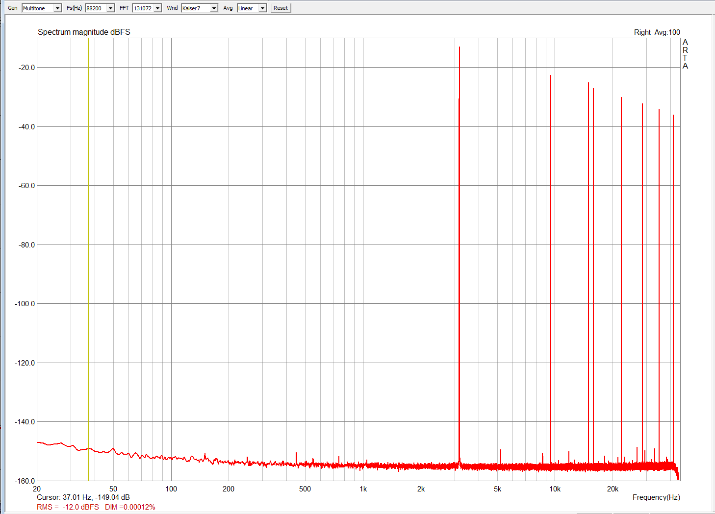

I have just made a test on an RTX6001 (from the prototype series) using ARTA. In ARTA the level was set to -11.5 dBFS to get a read-out level of -12 dBFS. See the attached. Settings like the ones shown in post #1251.
