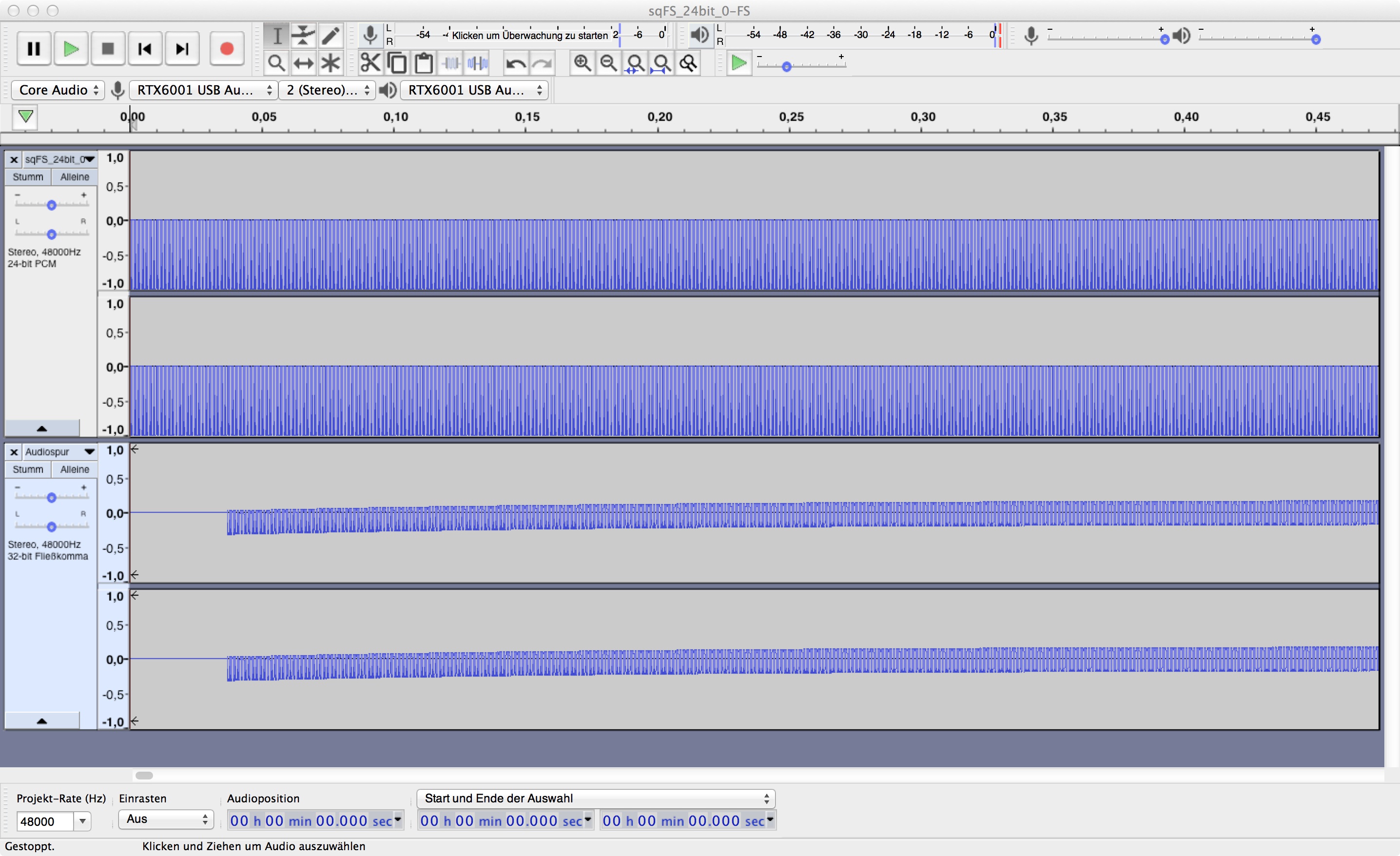

There seems to be an auto DC-offset correction. See the following picture, a loopback recording (lower tracks) of a "0, -FS" square wave (upper tracks).
You see that the mean value of the recording rises such that the mean is finally zero. For measurement purposes this is an unwanted "feature" for me. But I fear that is an feature of the ADC chip itself.
P.S.: settings out 0dBV, in 10dBV, DC coupled.

The ADC has a high pass filter with a 3 dB cut off at 1 Hz. This filter is enabled in this design and the 3 dB cut off is documented in the User Manual. And it cannot be disabled by the SW.

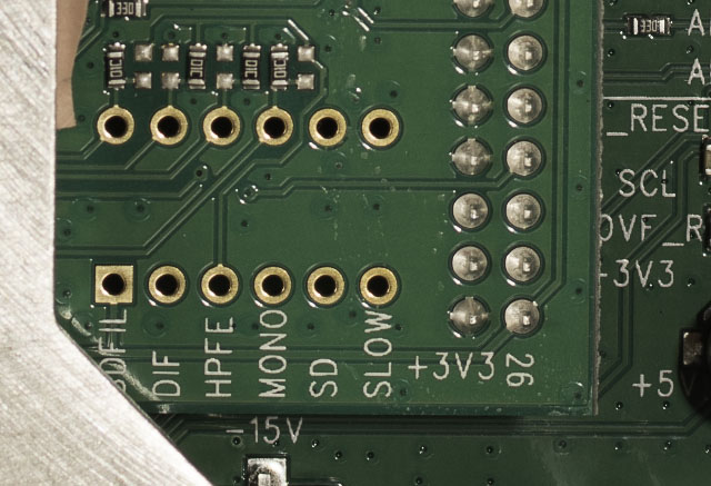

If it can't be disabled by software, is there a hardware hack to achieve this?
The HPFE pin 19 of AK5394A controls the built-in high-pass filter.
There is a pin on the AK5394A that controls the filter. I'm not sure how stable the DC is on the chip and associated electronics. I'm pretty confident that it NOT be zero without adjustment and probably not stable enough to stay at zero even if adjusted. This is a different type of hardware.
Probably, it should be easy with some unofficial support
The controls are accessible via the PCB:
Looking at the AK5394A data sheet, the filter is enabled if pin 19 ("HPFE") is high, and disabled if the pin is low. Hmmm... can I just pull the HPFE pin in your photo to GND without breaking stuff or affecting performance in any other way? Jens, what are your thoughts about this?
