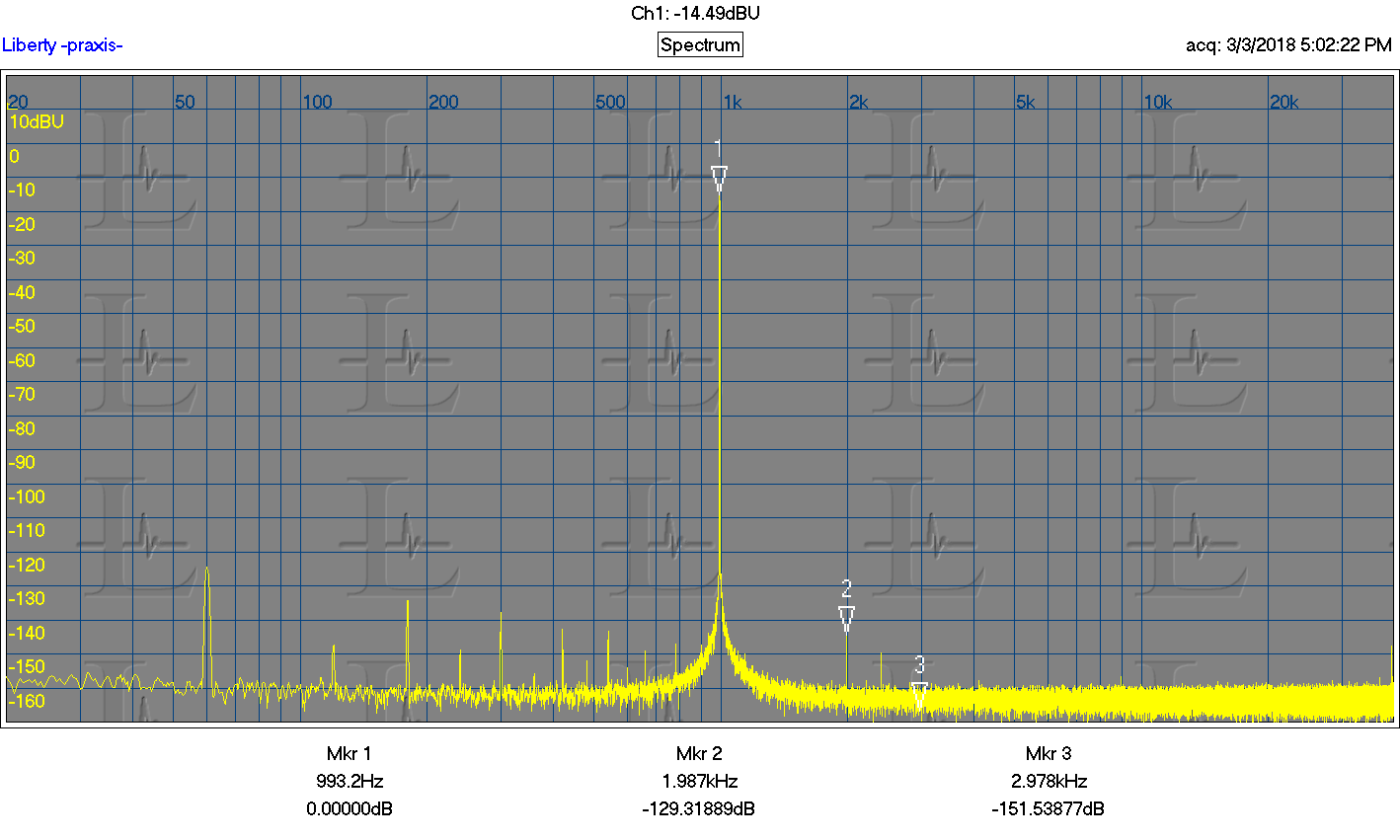

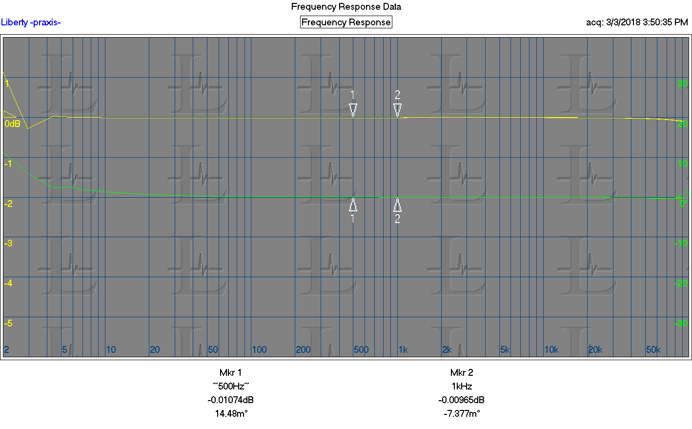

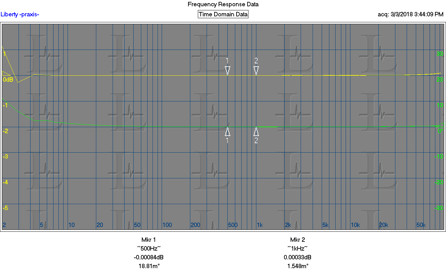

I just did a quick test with Praxis of a chirp based response. I did it with the reference and test channels reversed as well to look for differences. As you can see from the plots (which have no corrections applied) the results are essentially perfect. No errors above 5Hz. (I'm AC coupled) The impulse plot show a 1 sample long pulse so not interesting.
Praxis only uses the windows sound engine so no ASIO.
Third plot is distortion using a Victor 994Hz oscillator as the source. Level is -15 dBFS. The source is about 2.5V The only harmonic is H2 at -129 dB.
If Praxis is using a reference channel, the frequency response should have a rectangular high end cut off and totally flat regardless AC coupling. The phase would basically be as flat as the grid lines.
Looking closer at the graphs, the normal and reversed channels do have some frequency and phase difference.

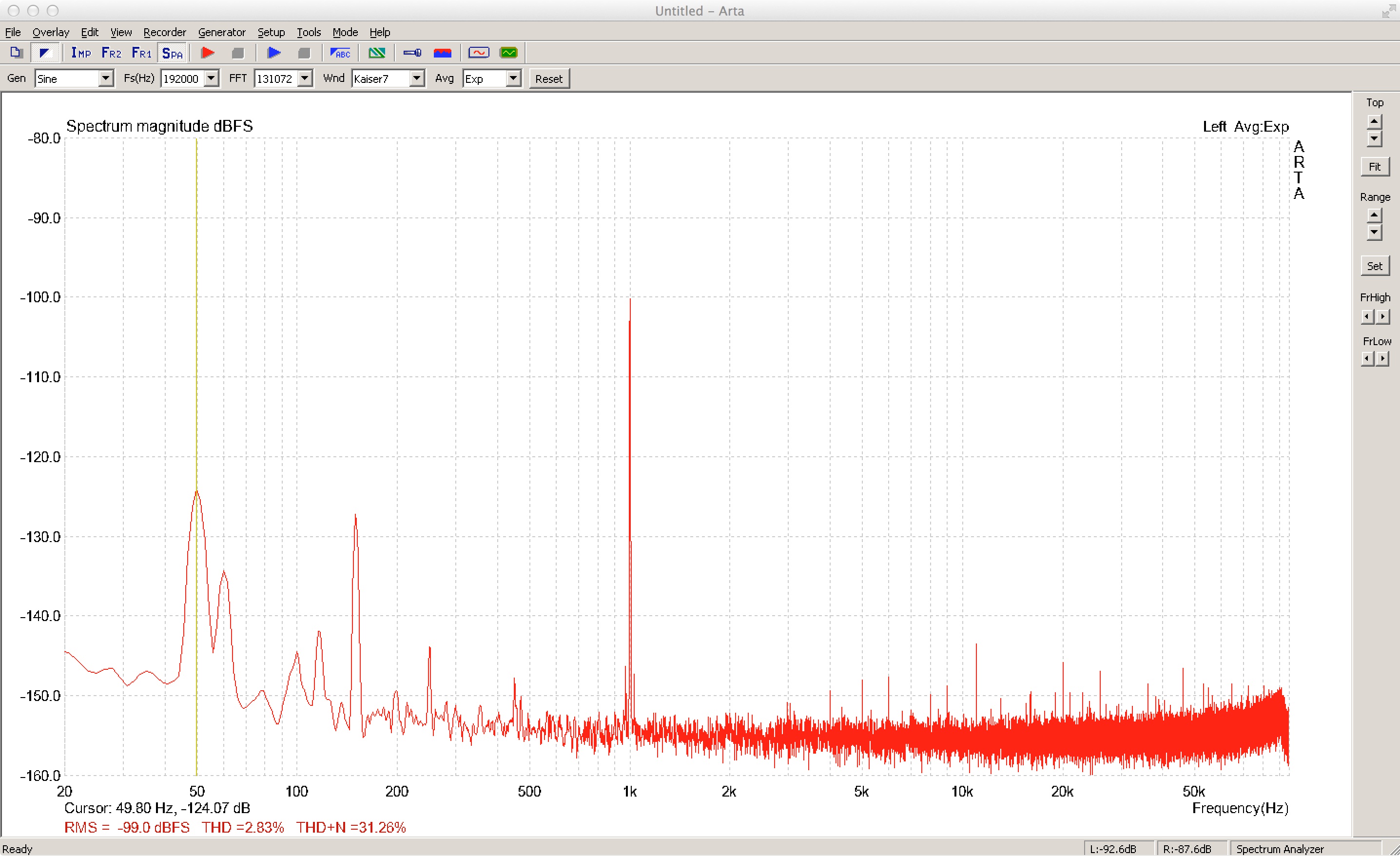

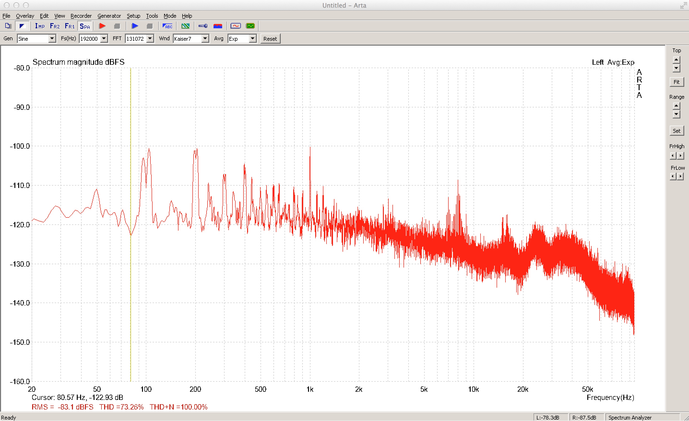

Just a wild idea... could you use a small coil/inductor across the resistor in the ground wire? That wold give virtually 0 Ohm in the ground wire at audio frequencies, but the HF stuff would still see the resistor.
Yes this helps to a certain extend, it turns out that you even can leave the resistor away and couple only by the inductor, this do not change much.
There ground connection with 22R resistor only (red) over ground connection with 33uH inductor (green). The pictures are not entirely comparable, with the previous as I had the screen of the XLR connector not covering the connector for the modifications below.
An other possibility to get the noise floor down is to connect the screen of the cable with an resistor (here 110 Ohm) to the XLR connector and connect the ground wire directly to the dedicated terminal.
If I choose an 620R resistor, for connecting screen, the noise floor get up a little.
If I connect the screen by the inductor the noise floor is up again.
If I connect it with an capacitor the noise floor goes crazy.
All is with 0dBV input setting connected to the DAM playing a -100dBV signal.
