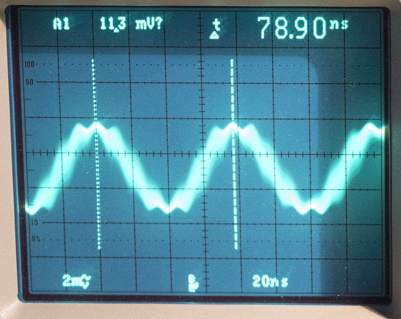

With the suggested coil probe I found a signal correlated to the higher noise floor:
So the oscillation is of about 12.7MHz. There is some higher frequency component that is independent from the RTX-setting.
The displayed curve goes away if I go away with the probe from the termination. It goes also away if I remove the shield of the XLR connector (i.e. get the lower noise floor). I get a similar picture with the first cable.

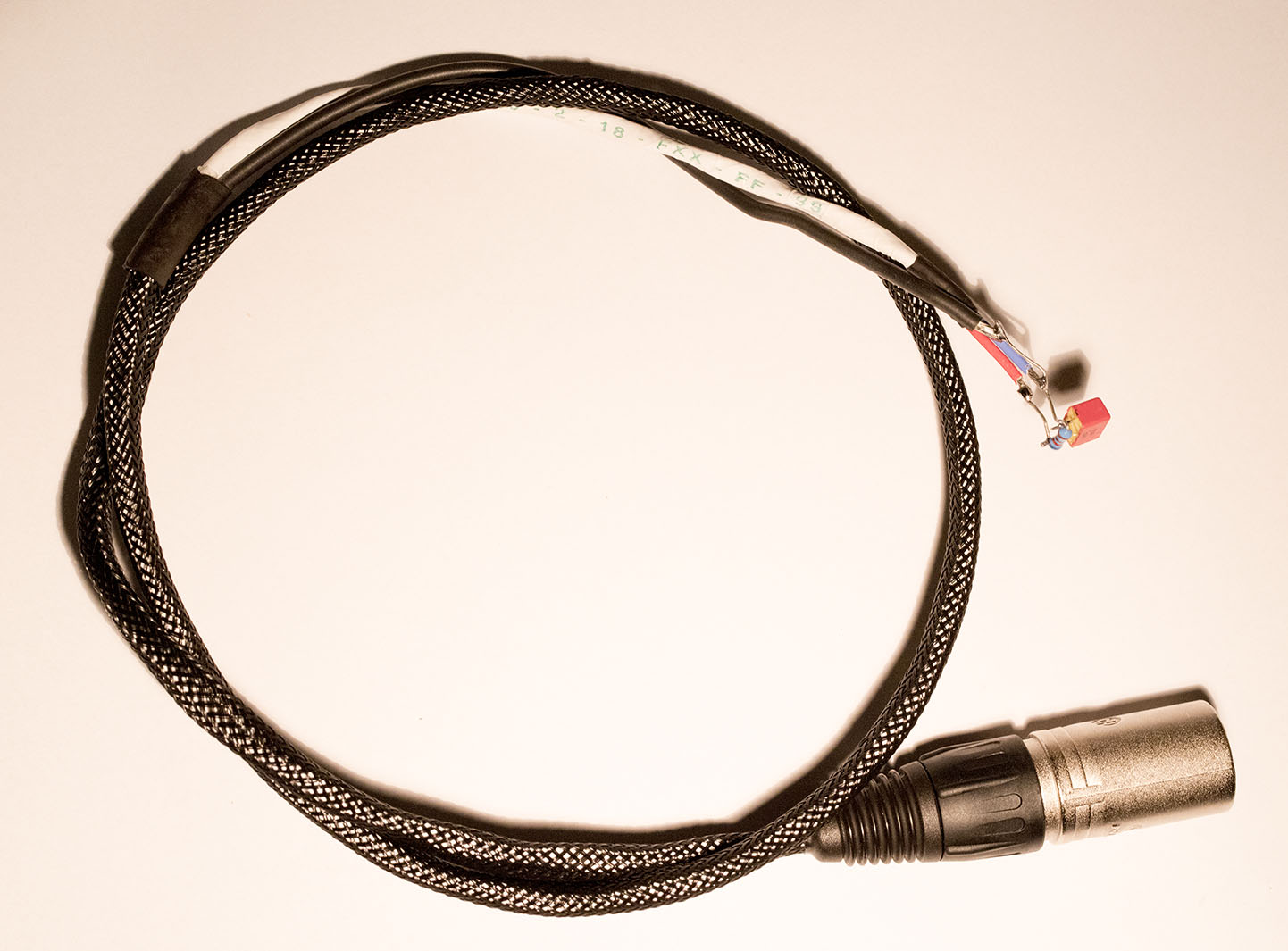

Here a picture of the coil probe. It has an inductivity of about 0,4uH.

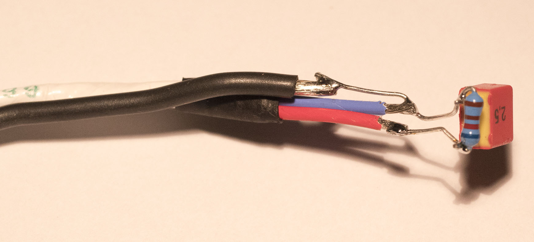

Here a picture of the termination of the cable.
And here the cable itself.
The cable with the balanced pair (white sleeve; twisted red,blue cable) is 18AWG (0.8qmm) wire as well as shield and has double isolation PTFE over Kapton. Red is to XLR-pin-2, blue to XLR-pin-3, shield to XLR-shield. The black ground cable (XLR-pin-3) is 16AWG (1.5qmm).
The length of the cable is about 80cm.
You get the best reading of the oscillation, when putting the coil right on the red and blue cables just before the termination.
The first cable was a microphone cable with an RCA connector on one side, thinner wires but shorter.

The current termination uses a 1.5nF WIMA FKP cap.
I measured the DAM with the coil and get a frequency of 11.4MHz. The DAM has a 1.2nF NP0 cap.

Ehm. The coil was setup to pick up RF emitted by the oscillating stage.
The coil is not supposed to be connected to the input of the analyzer.
Its should be connected to a third party control instrument (scope)

Sure, I did connect the coil to the scope.

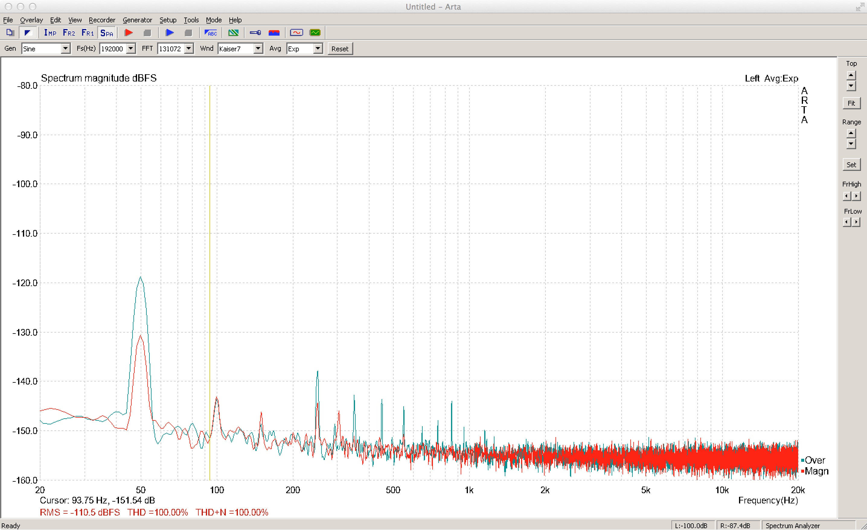

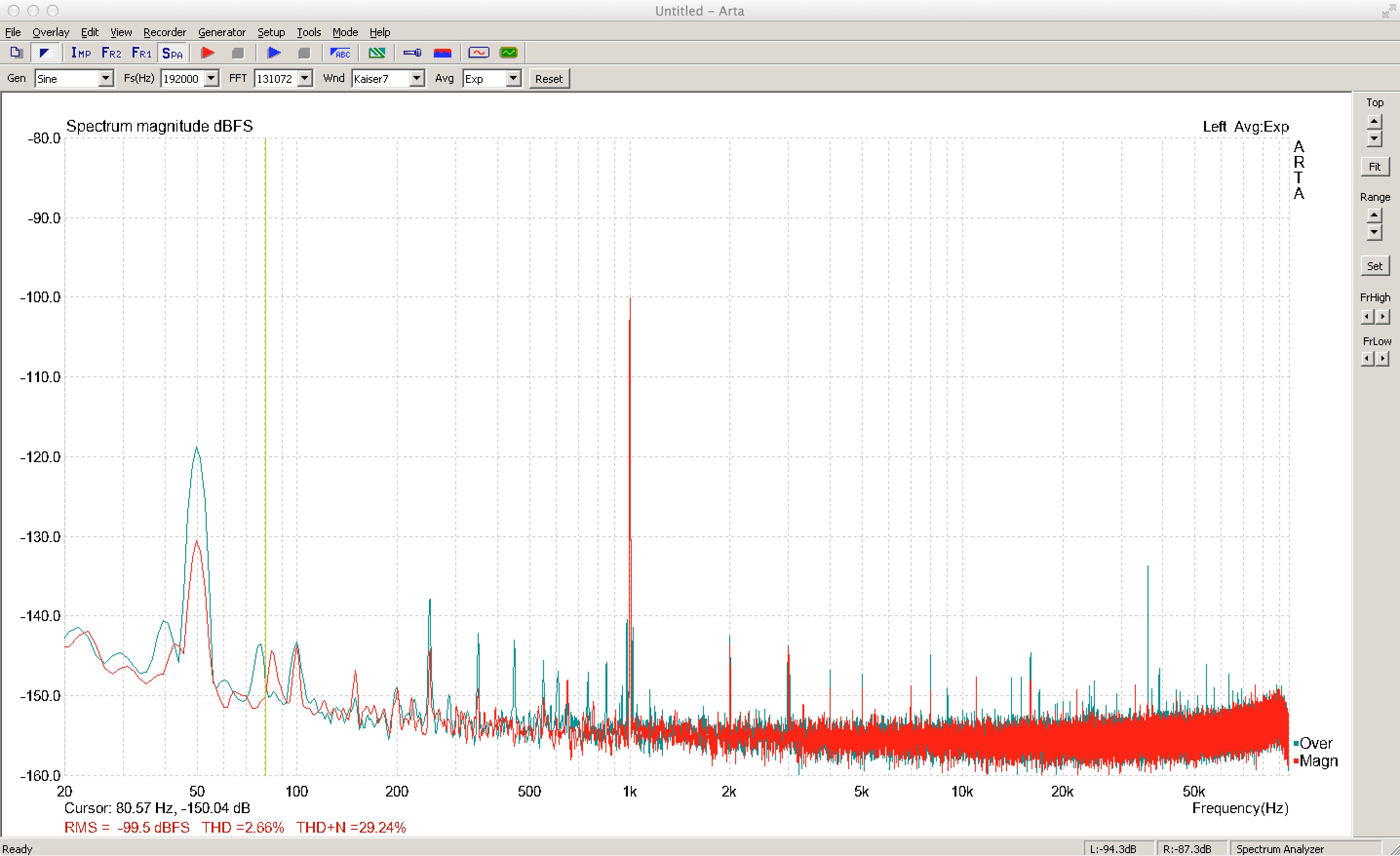

I also tried the setup with a resistor in the ground cable. With the resistors at the hand, I had no effect up to 4 Ohm, from 22 Ohm onward the noise floor was down.
However when leaving the dummy setup with the termination and going back to the DAM I noticed that with the Rane No 17 like cable and 22R in the ground cable, while the noise floor was down, I had problems in getting the 50-Hz artifacts down (no signal playing). I tried several connecting points at the DAM, the best I got was the green curve. With a standard pin-1-3 shorted cable (red curve) this looks better.
And when playing a 1kHZ -100dB signal there were signal related peaks with the Rane No 17 like cable and 22R in the ground cable (green) that are not there in the pin-1-3 shorted cable (red).
So the question is, what is "real"? Is the Rane No 17 setup more sensitive, or does it produce more junk - at least with a resistor in the ground cable??
P.S. the input switch was set to 0dBV.

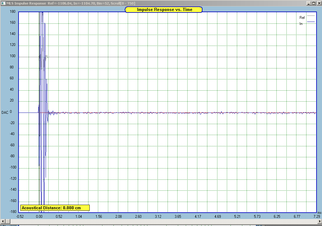

This in a screenshot from SoundEasy impulse. The connection is left channel balanced output connected to both channel input using a short split wire assembly. Left input channel impulse is used as reference to eliminate sound card effects from measurements. The right channel is the data channel which is shown in the lower amplified x8 impulse. As you can see, the right channel has quite some noise.How do you calculate the CSD?

This looks like something is wrong either with your wiring or the processing in the software. Since both channels receive the same signal, the deconvolution of the two input signals from each other should give a perfect impulse. You're seeing quite a lot of ringing.
Can you do the measurement without the split wire? Use one wire from left-out to left-in, and one wire from right-out to right-in?
Can you do the measurement without using one channel as the reference for the other (i.e., without deconvolution of the two channels)?
