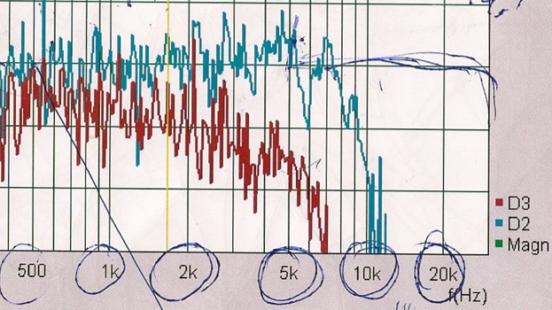

The change in my last,or maybe latest diaphragm is 30 stripes or leads,in a 40x170x6,5mm frame.I will show how the frame is build later.And the folding tool too.
Bernt
Black is THD red 2`Harmonic.

You should figure out why the distortion increases above 4kHz before you relax and stop building and only listen.
In real life the distortion are not decreasing above 9kHz like your measurement indicates.
The displayed measurement of THD will decreasing with frequency due to the way it is calculated.
With my AMTs this decreasing amount of THD shows up as the THD are falling with frequency even if the THD in real life are steady.
Your measurement indicate - THD are 30dB down at 9kHz - but I expect THD are much higher than your measurement - specially above 9kHz...
If you figure out what causes the distortion then you can relax.

Yes there THD decreases from 2.5kHz...
Due to the harmonics are removed step by step due to the mathematics....
So truth is => a even level of THD will show up as decreasing level above 2.5kHz... If THD shows up as a even level or increases with frequency then there are trouble..
Attached a picture showing (wrongly low distortion) THD (2nd and 3rd) of my AMT.. I understood that this was not possible, but in reality the THD was slowly decreasing up to above 20kHz.

You are right RayCtech,there are some distortíon over 5Khz.It is not the measurements tool.I have tried to change amp to a classD too.No difference,just a bit more 2`Harminic.

Looks like +20dB 2nd and +30dB 3rd harmonic before the measurement limitations fades out (down) at 9kHz.
The fact that both 2nd and 3rd harmonic are behaving identical in the measurement above 9kHz are strange as the 3rd harmonic should have decreased in level due to the measurement bandwidth limitation - at a lower frequency than the 2nd harmonic.
The 18kHz peak in the SPL measurement may indicates some kind of breakup / oscillation...
And may be the cause for the rising distortion....?
I have observed breakup / oscillation / resonance in diaphragms, in the metal / magnet assembly, in the "folding" cassette.
The breakup / oscillation / resonance in the metal / magnet assembly have I observed in branded AMTs, and then the metal / magnet assembly will emit a high frequency sound if you hit / tap it with something hard.. I have measured the emitted SPL level up to 60dB in branded AMTs that are caused by this breakup / oscillation / resonance in the metal / magnet assembly....
