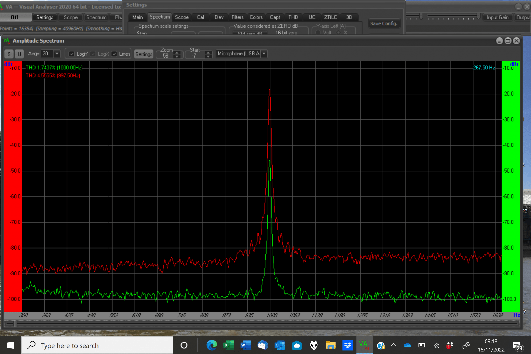

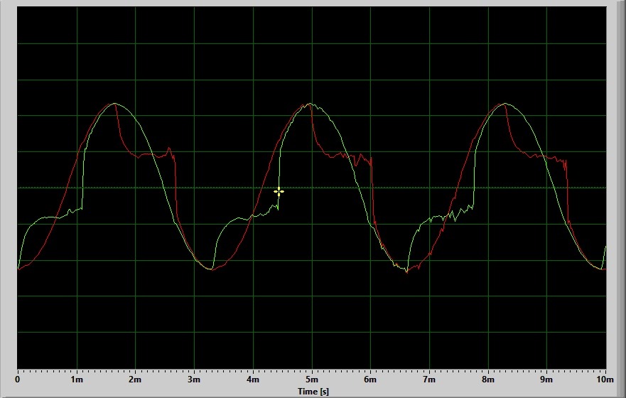

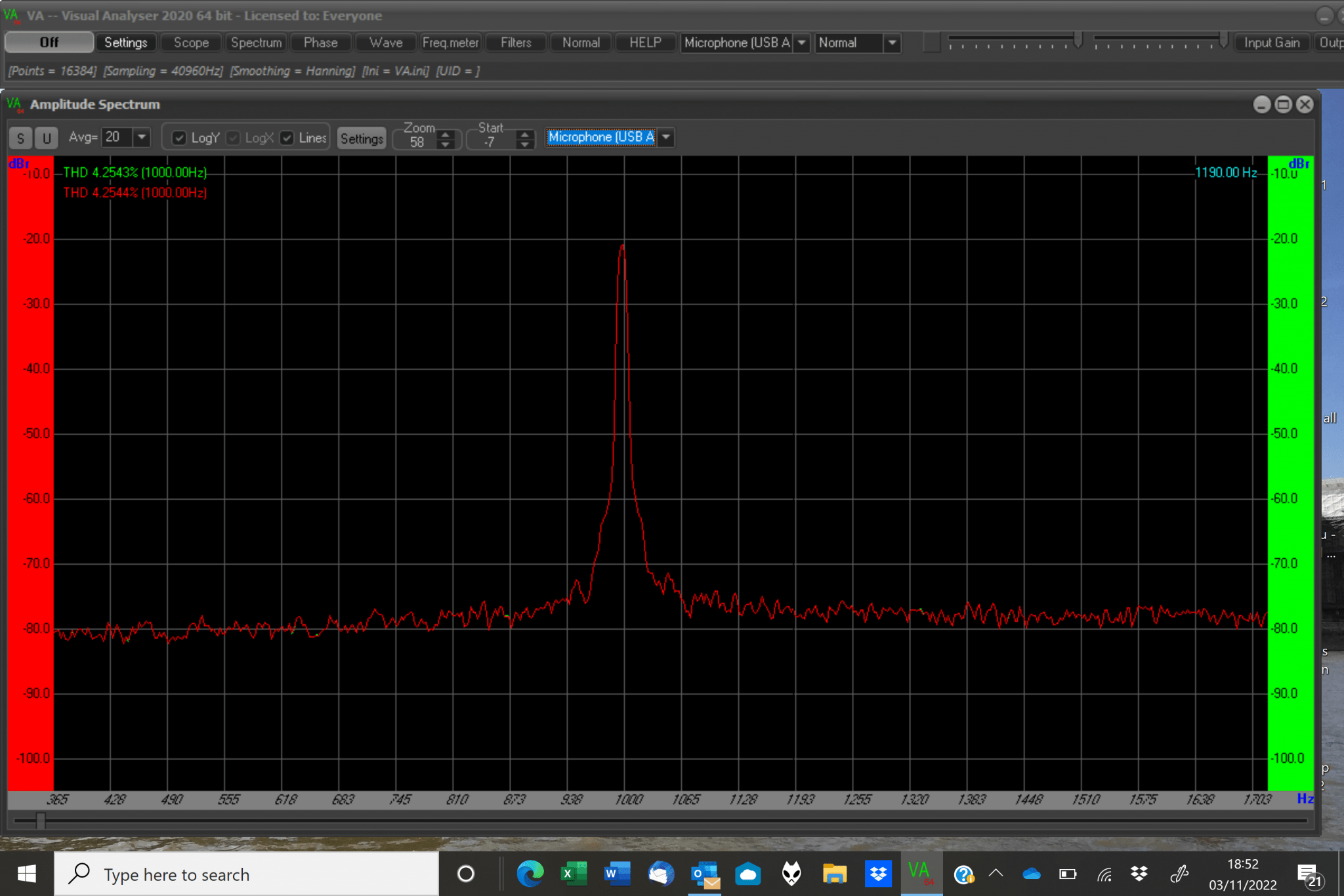

I understand it. However, it may be very difficult to find what causes these side bands.If you zoom in on the 300Hz fundamental there are a couple of sidebands visible at about -50dB if you want to improve the arm further find out what is causing these and you will hear an improvement in clarity. If you look at the plots in my post #4836 you can see the sidebands at 8.5Hz -47dB. These were caused by the OEM CW and its dynamic damping, basically decoupled CW. I made a new CW and stub that rigidly locked and the sidebands just about disappeared.

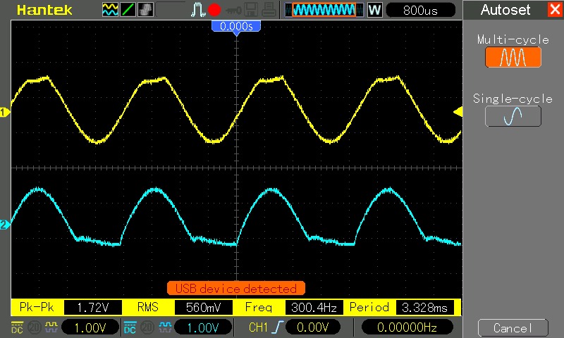

I also used my oscilloscope to see the waveforms of this 300 Hz track. In my air-bearing arm thread, I tested the trackability of my air-bearing arms by using different test LP and different waveforms. They looked pretty good though. But for this 300 Hz waveform, it doesn't look too good. Maybe it is time to roll up the sleeves again. But at this moment, I don't have a clue where to start with.
Warrjon,

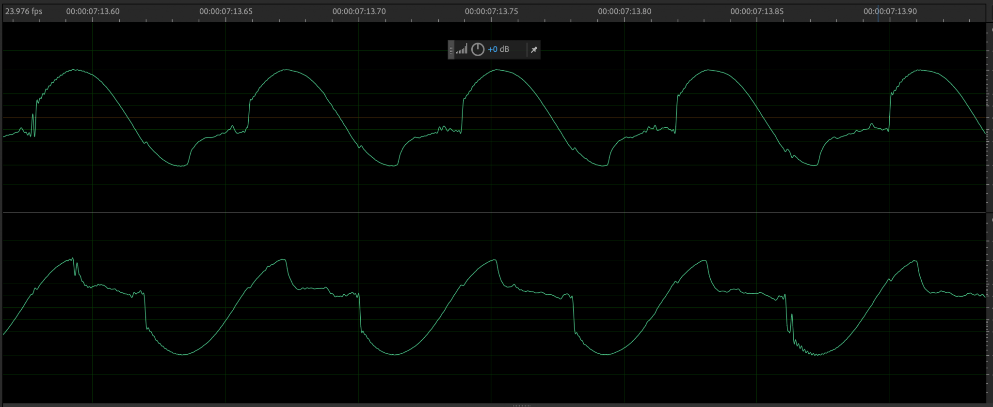

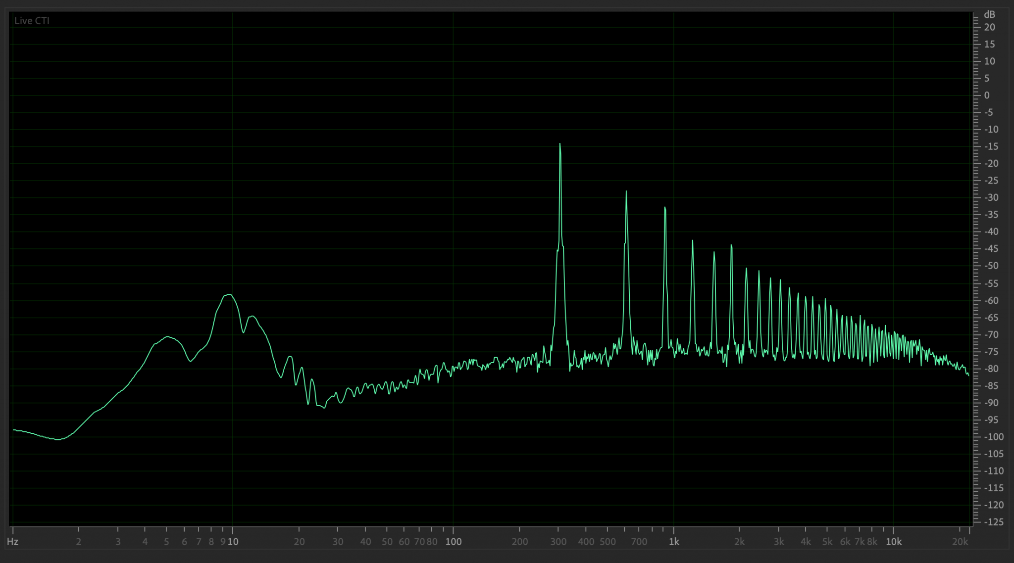

I also run the same 300 Hz without RIAA. Since I don't have a microphone preamp to connect the oscilloscope, I had to use a USB audio interface with a PC. I recorded the signal in Adobe Audition. Here is the result. It doesn't look too good either.
This is frequency analysis.
I have no idea what causes this. It probably will take a while to find out the reason. I understand that most commercial tonearms companies don't publish such test results. But I will try to solve this imperfection.
Jim

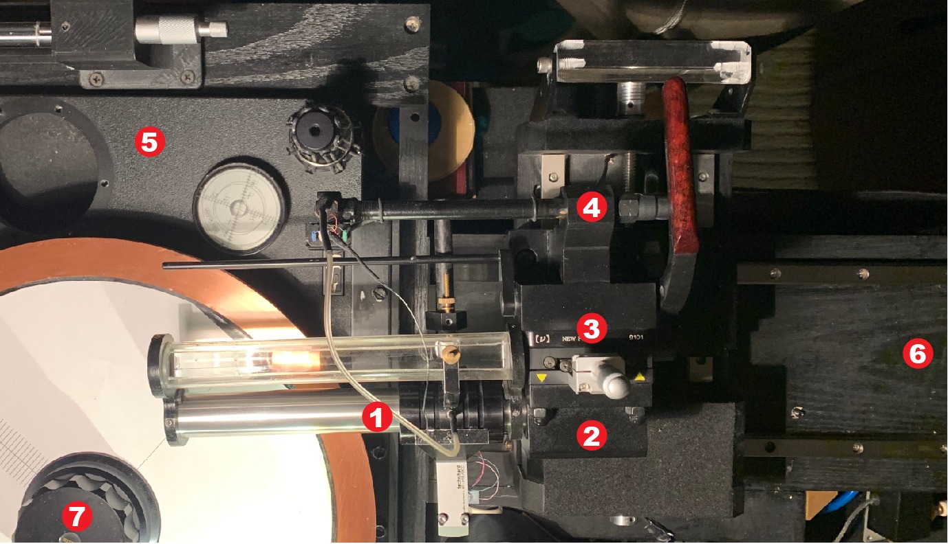

In the meantime, I got a mechanic stethoscope and really like it. I listened to these spots on my air-bearing arm.
It is no question. The sound level is the loudest at spot 1. The sound level at spot 7 is the 2nd loudest. This indicates that the center clamp is important. Then, the sound level at spot 2 is the 3rd. The sound levels at all other spots are almost the same and almost inaudible.

In terms of indicating good coupling (if this is desirable) the path between 7 and 1 would seem to be expected to be at similar levels. Also finding a way to compare 1 with the moving part of the air bearing, would be very educational. Although I don't use an air bearing i have a similar relative position of the lift mechanism which allowed me to briefly apply the stethoscope to the carriage by guiding it from the fixed part of the lift bar. Subjectively the mobile side on the carriage was the loudest and the fixed rail side 2/3-3/4 of that level, seeming to me to indicate good coupling.In the meantime, I got a mechanic stethoscope and really like it. I listened to these spots on my air-bearing arm.
I am afraid to let the probe touch the moving air-bearing. The risk may not be worth taking. Anyway, the energy from the cartridge will be certainly transferred to the headshell and moving part. For my air-bearing arm, there is no arm wand. So, detecting if the energy will be transferred through air film is meaningful. I understand if I know the sound level on the moving air-bearing, I can compare the level on the shaft. However, as I said before, it is too risky to do that. Even if I can find a safe way to listen to the air-bearing, it still involves uncertainty because I can't quantitate the level of sound.In terms of indicating good coupling (if this is desirable) the path between 7 and 1 would seem to be expected to be at similar levels. Also finding a way to compare 1 with the moving part of the air bearing, would be very educational. Although I don't use an air bearing i have a similar relative position of the lift mechanism which allowed me to briefly apply the stethoscope to the carriage by guiding it from the fixed part of the lift bar. Subjectively the mobile side on the carriage was the loudest and the fixed rail side 2/3-3/4 of that level, seeming to me to indicate good coupling.

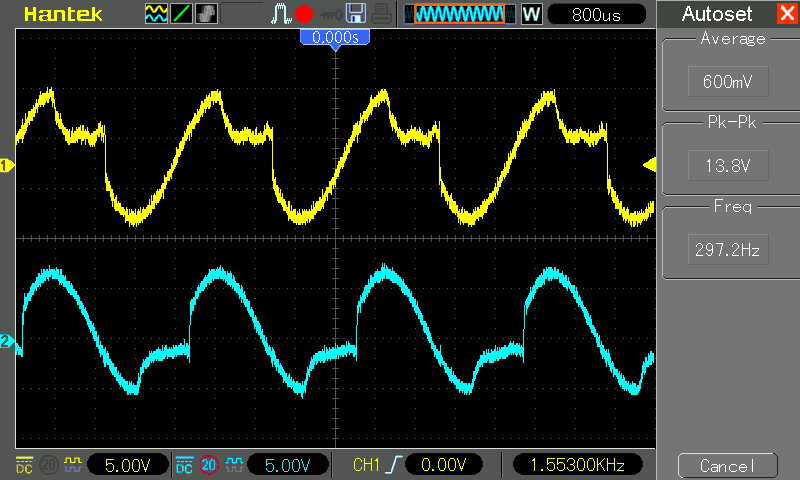

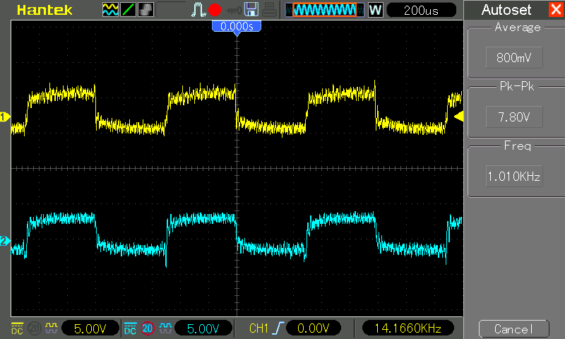

I used CBS test record to test the traceability today.
First, I did a square wave test. The result isn't perfect, but ok.

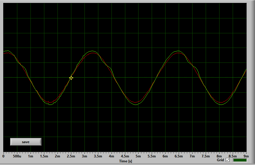

On the test LP, there is a 300 Hz track starting from +6 dB to +18 dB. The arm tracks the wave fairly well up to +15 dB. It was getting worse at +18 dB. Here is a screenshot at +15 dB.
I may try to rearrange the counterweight to see if it makes any difference later on. It will be nice if I can see a trace of the same track for other well-designed arms, so I compare them with mine. I guess commercial tonearms may never publish such test results.

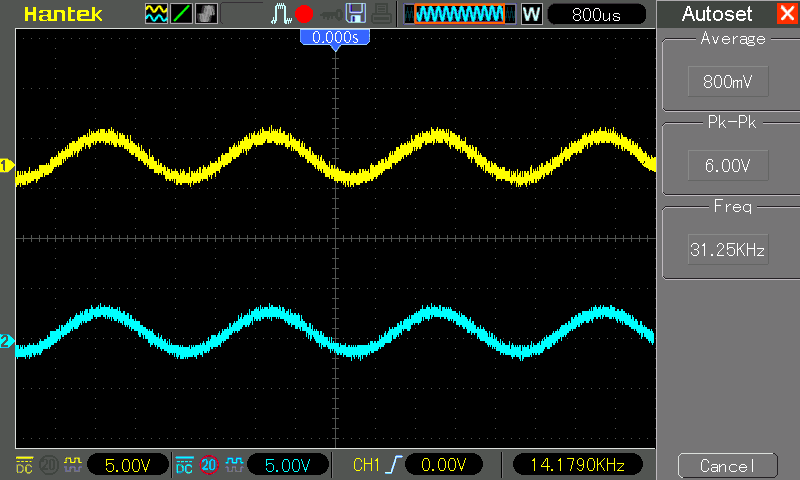

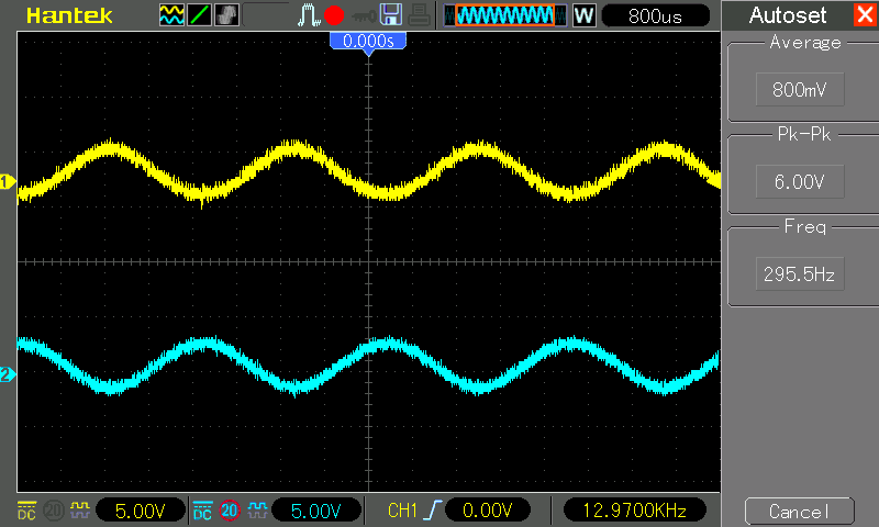

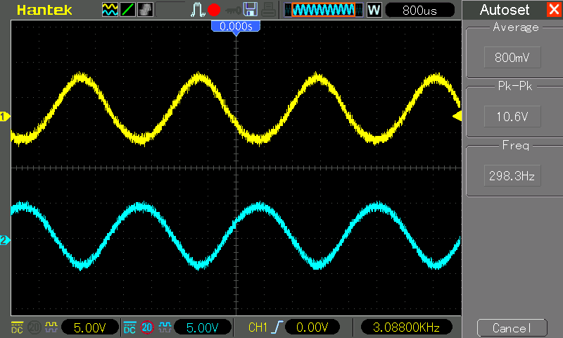

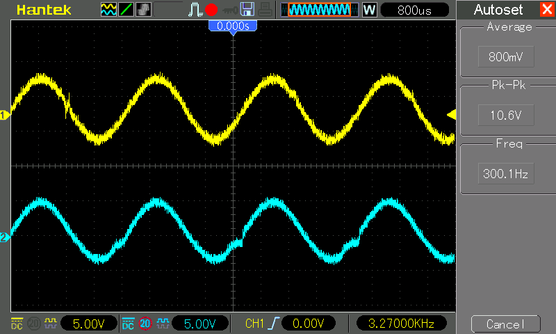

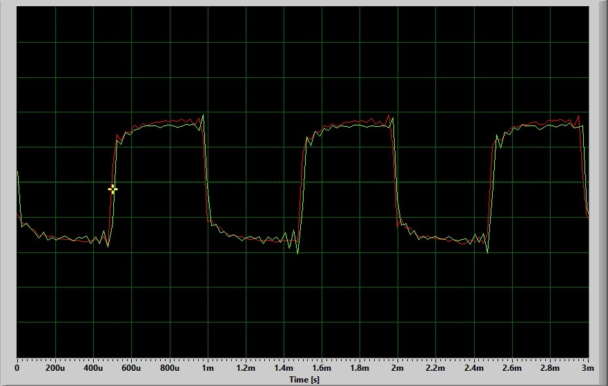

I tested the tracking ability of my 1" air-bearing arm today again. The tracks are from CBS Test Record because I realized that there are two groups of tracks. One group is lateral and another group is vertical. Here are the results. The vertical trackings seem all fine.
Square Wave
300 Hz lateral 6 dB
300 Hz Lateral 9 dB
300 Hz Lateral 12 dB
300 Hz Lateral 15 dB
300 Hz Vertical 6 dB
300 Hz Vertical 9 dB
300 Hz Vertical 12 dB
From the test results, the mistracking happens in lateral tracking. It is understandable. The results also indicate that at 15 dB, the arm tacks one channel correctly the meantimes mistracks the other channel.
Jim
