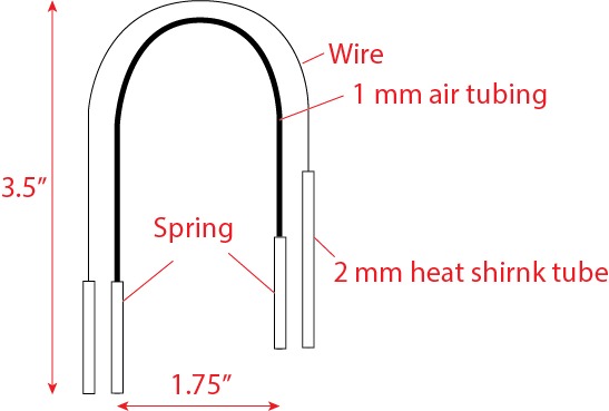

However, I can see there is one very important and critical implementation that needs to be improved, i.e., the arrangement of the air tubing and the wire. I have done many experiments. My arrangement of the wire and air tubing improves the movements of the air bearing greatly.
Here is an image to illustrate how I arranged the wire and air tubing. I think it is the best possible arrangement as I know. One option is to add two springs. These springs are from retractable ball pens. I don't use springs now.
First, it seems to me that you aren't using the air tubing I recommended in this thread. Personally, I can't find anything which is better than the one I recommended. I think it is a must to use the air tubing that I recommended to ensure high performance. If you live in the States, you may pm me your mailing address so I can send you a foot of said air tubing to you for free.
I used wire from my Sennheiser 600 headphone. If you don't have a similar wire, I would recommend using 34 g enamel magnet wire, 3 strands for each signal. I also saw the Litz wire on ebay. I haven't had any experience with this particular Litz wire, but it looks like it will work just fine.

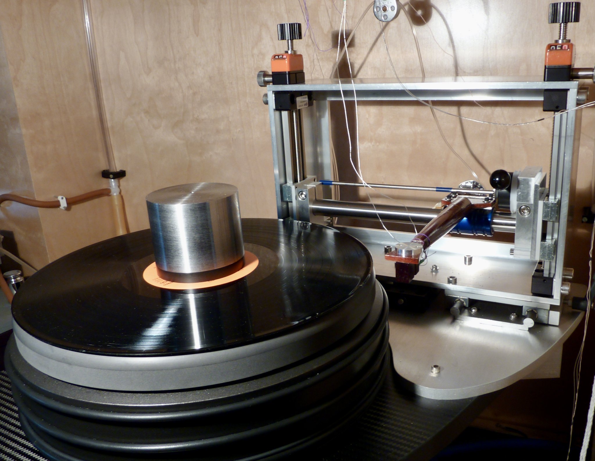

Hi esls,My implementation, which owes much to many. The only real innovation is precision tangentiality, which is easily adjusted to 5 microns or so. On the fly, not that this matters much.
Very nice job.
Are the two vertical extrusions from a company called 80-20?
Are the two orange/black units right angle drives?

esls,
230 grams is on the heavy side. If possible, it would be nice to control it under 200 grams. However, if the vertical resonance is 11 Hz and the horizontal is 7 Hz, it should be fine, especially with Koetsu cartridge. I use epoxy to glue the arm directly on the air bearing in order to save some mass. Your arm wand seems like a solid wood one. If you can make it hollow, the mass may be reduced.
My air tubing is 5/16" all the way from the compressor to the arm, and only the last 5.5" is 1/32" tubing. I have no problem with the pressure. I know the airflow will be limited. But for an air-bearing arm, it is an advange. Air bearing requires high pressure and low flow. 1 mm tubing may be a little heavier than 1/32" tubing. I believe it makes no difference if you make the same arrangement as mine. In your current arrangement, even a 1/32" tubing may drag the bearing sideway because the tubing may be too heavy on one side.
A Koetsu cartridge with an air-bearing arm, if you can stand the maintenance of an air compressor, you will never go back to conventional arms.

Jim, thanks for your further thoughts. I want to change cartridges and make fine but solid azimuth adjustments, so I used an elastomeric glue from Chemlink, M1, to glue an aluminum plate of 2024 alloy to the bearing. A platform on the wand then screws to this, and shims are placed between the bearing plate and the platform. Since the base of the triangle formed by the shim, the bearing plate, and the wand platform is 45mm, and combinations of shims allow 0.0005" increments, adjustments on the order of 1 minute of arc are possible. The connection is more solid than the connection of cartridge to wand. Adjustments of the vertical sleds with the knobs at the top are capable of +/- 1 degree without overly compromising horizontal balance, so this provides an easy way to translate readings on the vertical sled counters to shim size, which allows for progressively fine azimuth. Long answer as to why a simple gluing job won't quite work for me.
Wand is in fact hollow. Next one will have a bigger void for reduced mass, exactly as you suggest. I'm not experiencing obvious air tube drag, but that doesn't mean there's no room for improvement. I will shorten the 1/'32" tubing in such an attempt.
Next two wands are going to be a lighter Panzerholz, as discussed, and a sapphire tube with suitable plate and platform. 2024 Al? 7075 Al Temper 0? Must think some more.
Also have a lighter wand, about 170g, which I used to test and to investigate the tonearm. I put a cheap Grado on this one, and vertical resonance was a bit high in frequency, suggesting that the Grado with compliance 20 needed more mass! Even so, it didn't sound half bad - wonder what one of their big cartridges might do?
As for standing the compressor maintenance, I must do that in any case for the air bearing turntable, so it's not an issue. Thank you for all your help in getting me to the place I've been coveting for 20 years.
