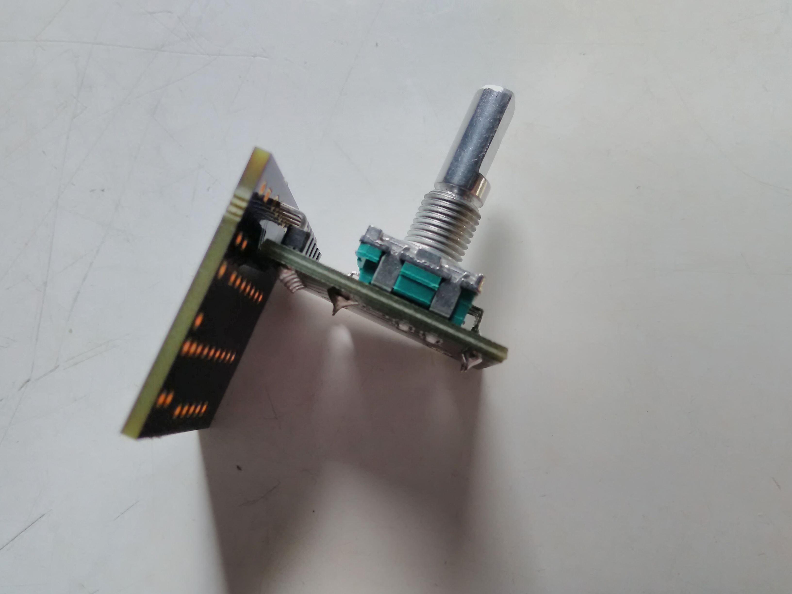

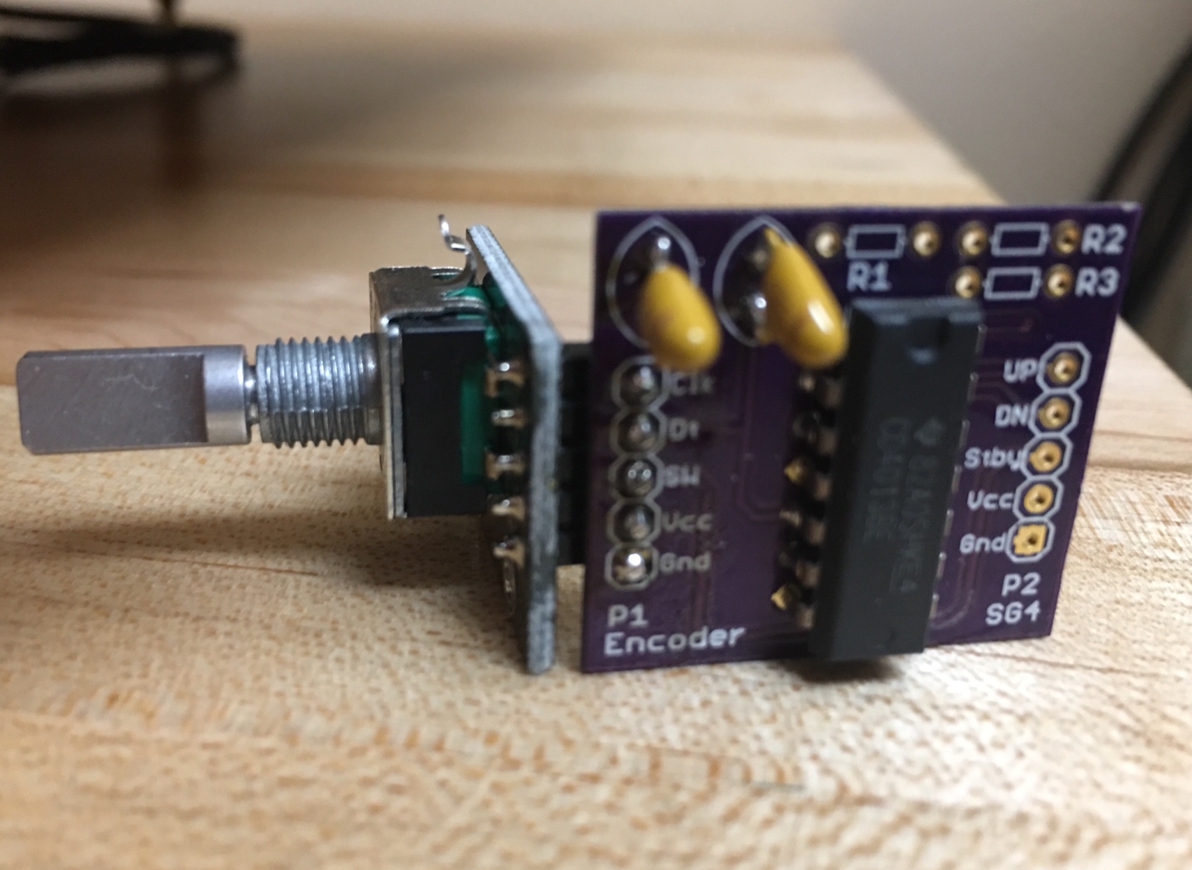

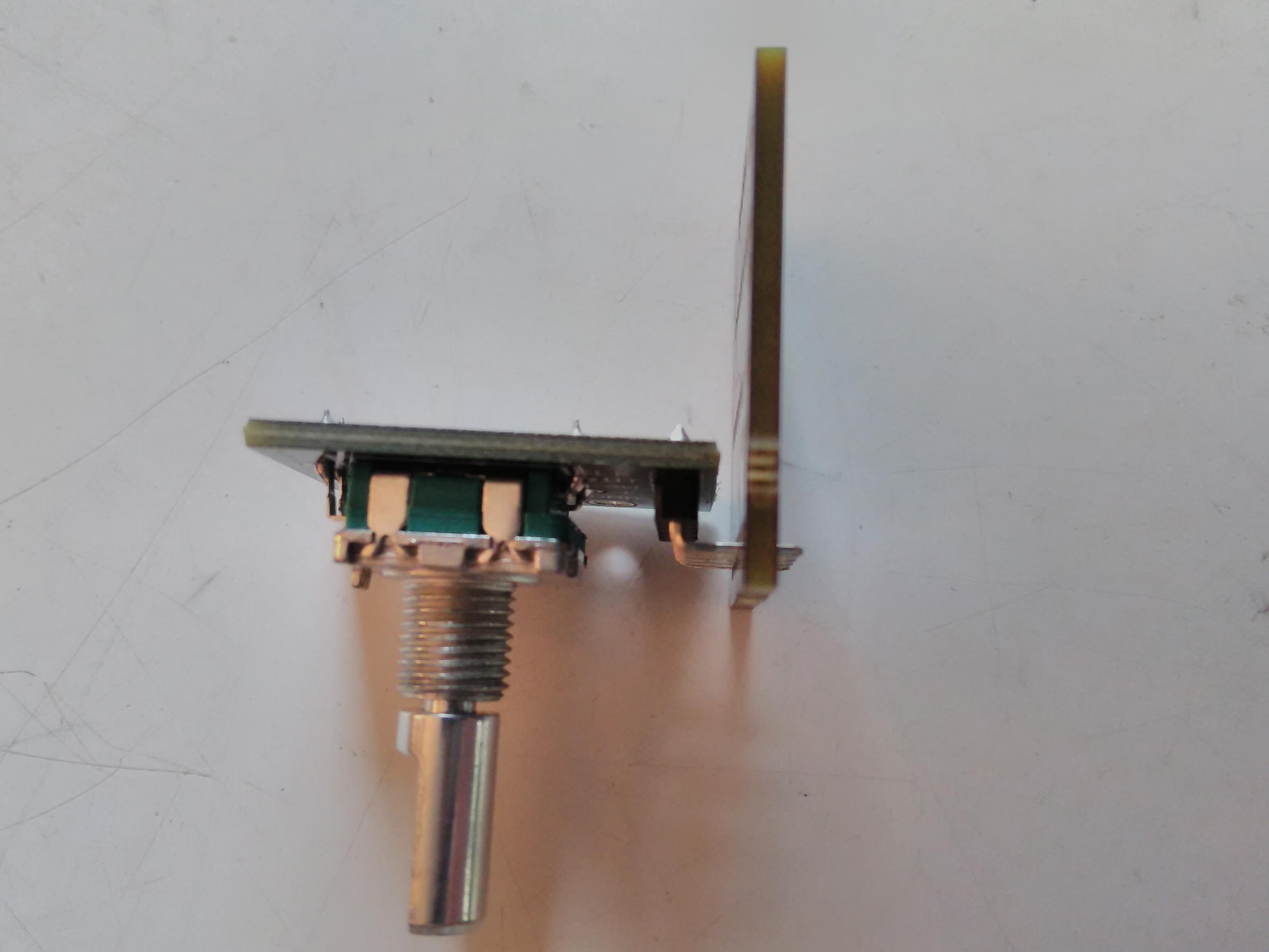

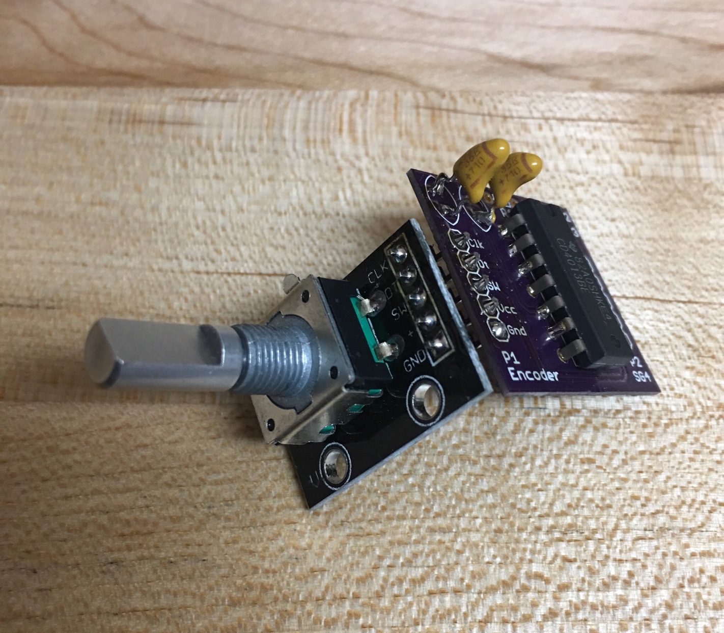

This is annoying: the roatary encoders I bought have header pins that are right angle but mounted on the top side of the pcb, making it difficult to mount on a panel.
I was not looking forward to desoldering and inserting a 5 pin row. Why would they mount them on top instead of on the bottom side? Straight pins would have been better.
Anyway I was able to file down the edge of the board and bend the pins a bit and get abour 0.1mm of clearance. I might be able to bend the pins a little more as well.
Hi Alex,
You work is correct and the same I've done for mine.
If I've the time, I intend to do a back to back with straight pins to look more compact.
