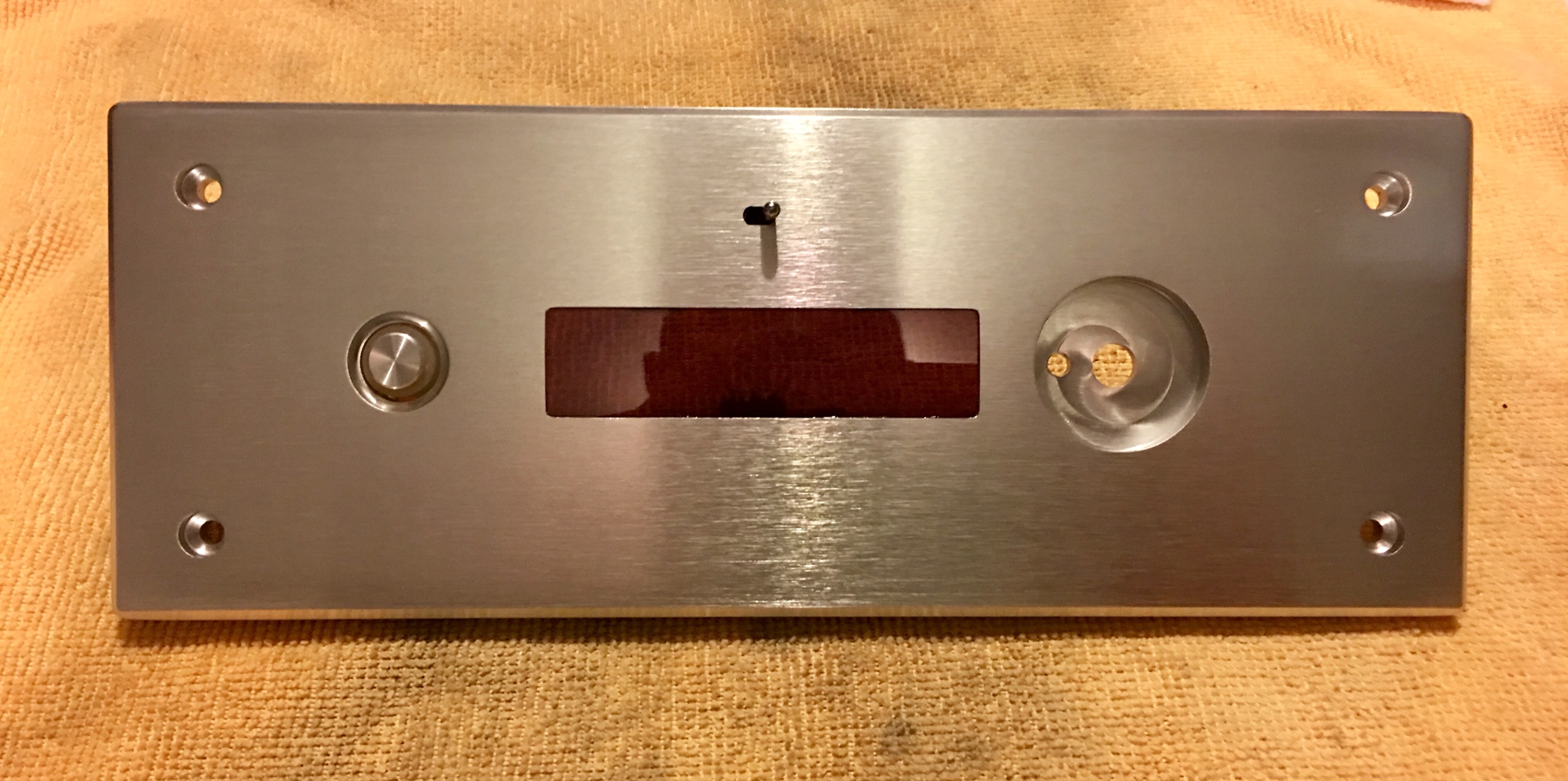

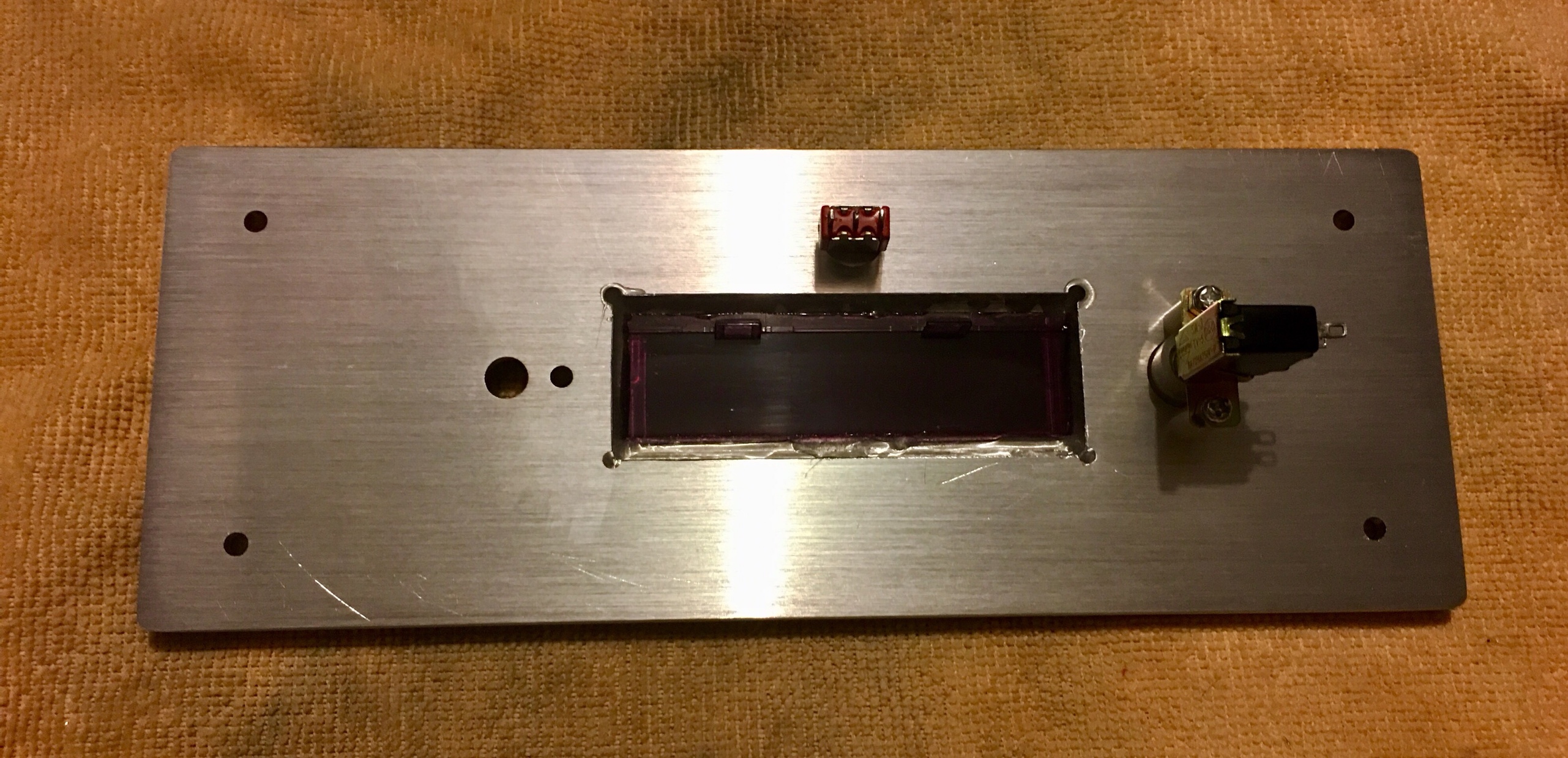

There's another mod I did to the SG4 board. I swapped out all the R10-R17 resistors that link to my alternative 0.36" RED 7 segment display and reroute the wiring to match the pinout. It works fine, just that with 330ohm, the display is brighter towards orange than red compared with another AC output voltage RED display I installed to monitor the output voltage. I swapped out 750ohm resistors and both now look almost the equal brightness (bare face, no diffuser yet).
I also use output voltage LED meter (almost same brightness and color as SG4 LED display) and have switch on the back to see Vout from each of my 2 transformers. Assume it will be used not that often, therefore I installed it on the back panel.
Front has defused taken from my old Sony DVD player. I use same box as was advised by Pyramid. Getting close to finish it.
