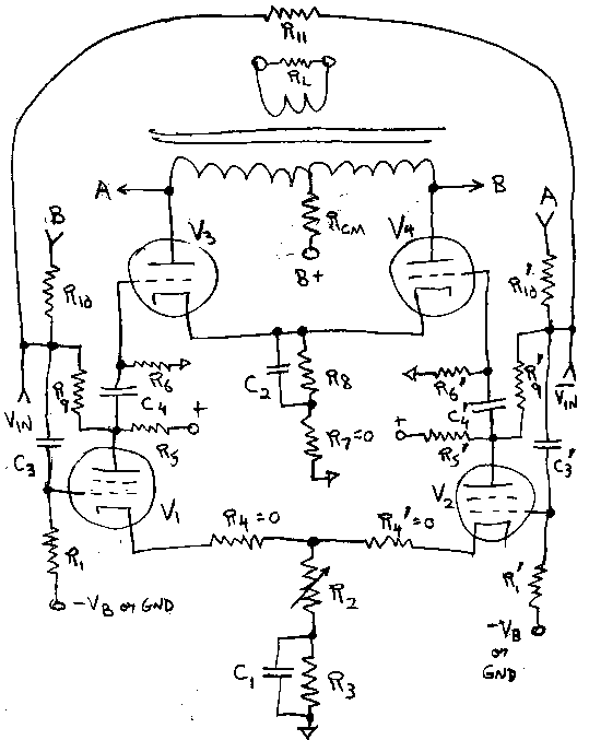

Optimising the Cross Coupled Common Mode FDBK Harmonic Neutralizer
I have attached an improved schematic for carrying out the cross coupled common mode FDBK distortion neutralizer scheme.
Since the common mode current sampled signal from the outputs is relatively small (unless we include some more Rcm, we could try say the optimum 3rd harmonic value from the Bell Labs/Kreer patent), we need to optimize the driver stage design for maximum sensitivity to it. So forget about screen feedbacks. Back to using g1.
Lowering the value of R2 increases the sensitivity to the common mode signal, but too low a value here will cause the driver stage to generate excessive odd harmonics itself. So the plate feedbacks, R10, are attenuated with a cross resistor, R11, that does not attenuate common mode signals, only differential ones. Grid 1 bias resistors R1 will want to be as large as we can get away with.
Degeneration resistors like R4, while tempting for linearizing the driver, would ruin common mode sensitivity, so they are out. If pentodes are used for the V1,V2 drivers, we may want to include plate feedbacks R9 for linearizing them. It turns out that for a single stage, no cross coupling is needed, and further, that this has the correct polarity sense for common mode error correction of the driver stage as well.
Since g1 of the drivers has some small input capacitance, we might shunt the R9 and R10 feedback resistors with appropriate small sized pF caps to preserve the attenuation ratios at very high frequencies. This is a high speed corrector after all, lets keep the bandwidth up.
As long as the outputs are not drawing class A2 grid current, there would seem to be no need for R7, so R7 is out. R8,C2 is just for biasing, any of the usual schemes can be substituted here.
Similarly, biasing for the driver stage can be any of the usual schemes, just keep common mode resistance of the grids to ground high as possible without getting into grid leak problems.
R2 is a pot for adjusting common mode correction gain while looking at a spectrum analyzer view of a test signal into a nominal load resistance RL. Adjust until happy.
The Vin grid drive points indicated are rather low impedance due to the feedbacks, so are really more like Iin points from the pre-stage/splitter. The C3 caps are situated to do triple duty for both feedbacks as well as input DC isolation.
You might notice now that the resulting schematic is stunningly close to the Citation II except for UL mode pentode outputs. Is this just coincidence?

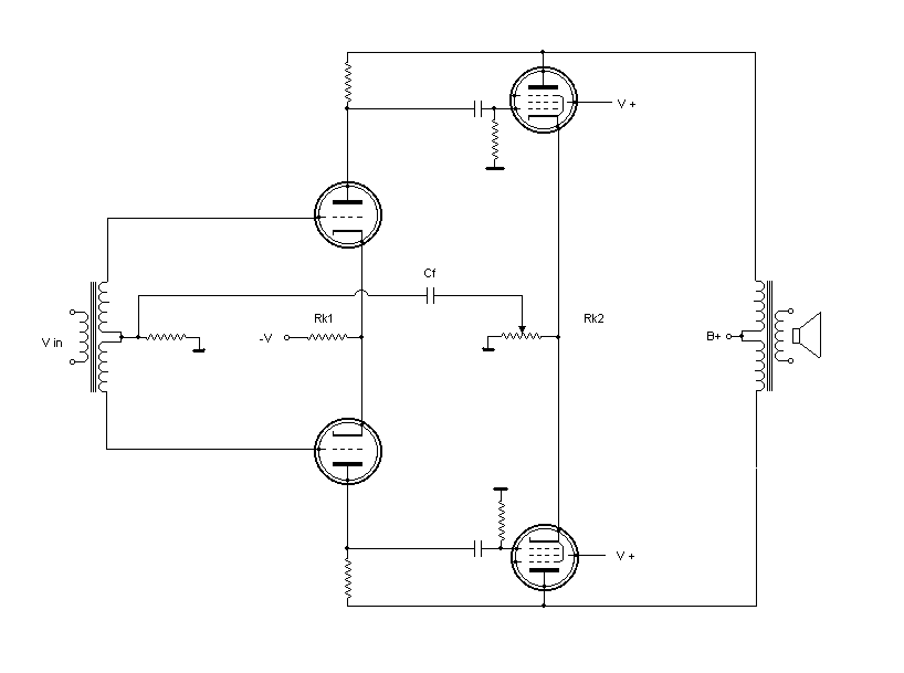

Would this principle work?
See att.
The common mode signal on Rk2 that originates from the penthodes will feedback trough Cf to the cathodes of the driver and thus form a common mode neutralizer.....
As a bonus the partial feedback can still work.......... or does it?
See att.
Markanica:
"Would this principle work?"
Interesting, but I think it may have a problem, maybe quite solvable.
With the original cross coupled scheme, an unneeded increase in an output tube conduction causes the common mode voltage of the drivers grids to drop, reducing their current and thereby the lowered gain in the drivers to compensate.
In your scheme, the Rk2 voltage would increase, then be conveyed to the driver cathodes by Cf, and lower the current in the drivers as desired. But I think Cf and Rk2 will place a very low impedance on the tail of the drivers, causing them to generate excessive odd harmonics themselves. We would like to keep the driver tail resistance as high as possible but still get sufficient common mode feedback effect.
I would suggest that the Rk2 voltage be used to control the current level of a current source in the tail of the drivers. (or alternatively control a current source dumping into the driver tail resistor.) This would keep the driver tail impedance up for low distortion in the driver itself, but may give exceptional control of the common mode gain effect. I think this may be on to something useful.
Don

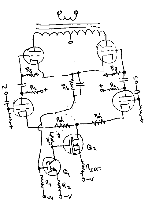

I have attached a possible scheme to use the output cathode current to control a CCS in the drivers. Rather hurriedly put together though, it definately looks dangerous for possible bias runaway for the outputs. Needs some serious simulation effort and more thought I think.
Don
Yes, a pentode would seem a good fit for the input stage. Looks like the Citation II schematic used one too. I guess we are re-inventing it.
Mark,
Don

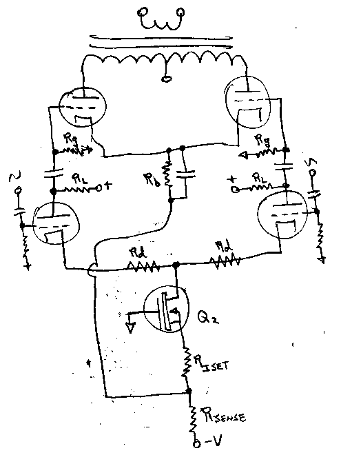

Now we're cookin'! See attached.
Q2 could be a Jfet or Ixys 10m45 or Dn2540 or Mosfet FQP1N50 or ... Pentode!
The Common Mode loop will be much faster with just one device in grounded gate or grounded grid this way. And the high impedance CCS tail on the drivers will keep them nice and linear.
I haven't bothered to draw in the cross-coupled feedbacks since they are no longer part of the common mode corrector loop. Their common mode voltage on the driver grids no longer has any effect due to the high impedance CCS in the tail. Common mode correction is done directly by current sensing of the output tube cathodes (Rsense) controlling the current output of the driver CCS (Q2, Riset). Adjust Rsense for the common mode correction loop gain control.
I would still recommend using the cross coupled plate feedbacks to the driver grids (or driver screen grids now are OK) though for the conventional local NFDBK.
Don
Don

Hi Mark,
The common mode signal is inverted between the output plates and the cathodes, so the the rk2 pickoff has the wrong CM signal polarity to apply to the driver grids. (ie, we were using the CM plate signals back to the driver grids before, so the CM cathode signal to the grids will be wrong.)
Quick check: If an output is supplying too much gain, the current thru rk2 will increase, this works its way back thru Cf and the input xfmr to the driver grids to raise CM conduction there. Increased tail current then increases driver gain. But we need a complementary decrease in driver gain to compensate the increase of the output tube. Back to drawing board.

smoking-amp said:Hi Mark,
I'm not sure I follow you here. Let's suppose the output stage creates only 2nd and 3rd order harmonics. The common mode signal will consist of the 2nd order harmonics as well as some DC. That is, if we drive the amp with a 1kHz sine wave, then the common mode signal will be 2kHz and will have shifted slightly in DC level relative to the zero signal case.
In many implementations (including those by WE) the CM signal is cap coupled back to somewhere earlier in the amp - perhaps the grids of the output tubes. The cap coupling means that only the 2nd order harmonics are present without the DC shift. So my question is this: how does flipping the phase (180 degrees) of a 2kHz signal make any difference relative to the 1kHz signal that it was born from?
The early WE (Bell Labs) guys didn't seem to think that the DC shift was part of the mechanism at work here. It might have another benefit, namely linearizing the gain as a function of signal level, but that, I think (they thought) is not part of the harmonic equalizing effect.
I have read through Don's earlier post describing the mechanism (thank you), but I admit that I still do not understand how injecting a 2nd order harmonic into the grids of a PP stage cancels generated 3rd order. The explanations that I have heard previous to this thread use multiplication as a byproduct of nonlinear mixing: adding the 2kHz signal to the 1kHz signal results in 3kHz and 1kHz byproducts. The 1kHz component either adds or subtracts from the fundamental while the 3kHz hopefully subtracts from the generated 3rd order harmonic distortion.
Perhaps all of that is rolled into the explanation presented here. It could easily be that the multiplication is just a good way of expressing it mathematically but not very helpful in conceptualizing what's going on... but I'm just too dense to see it.
