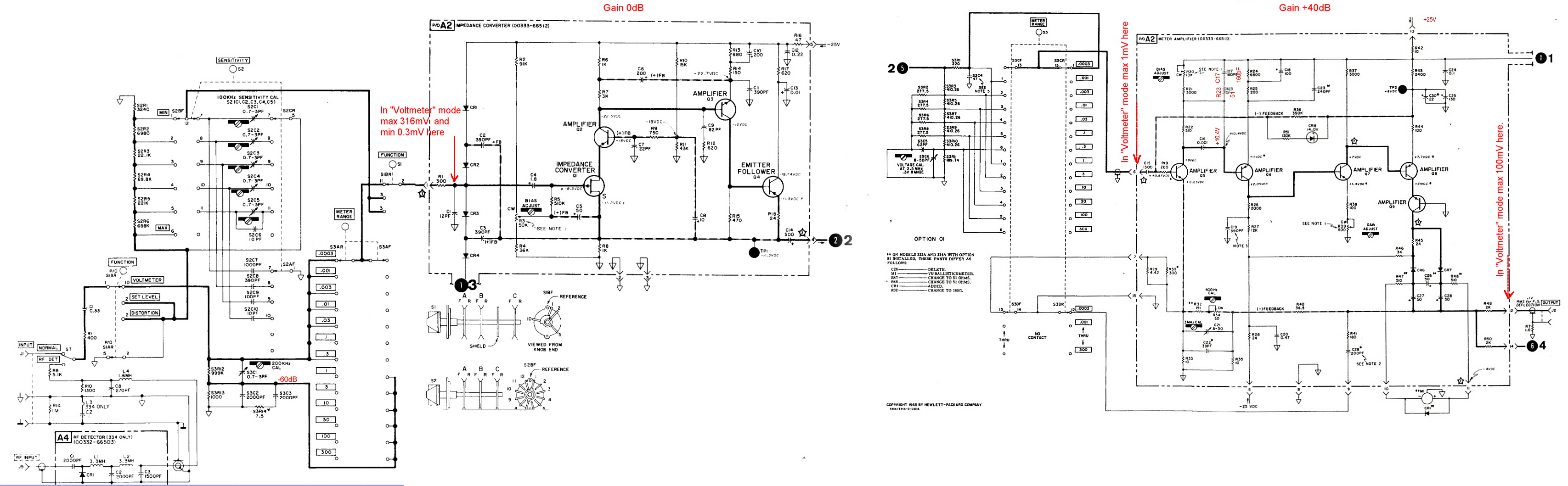

Remember the target indicator of the 330-334 family is an analog meter with a 20 dB max dynamic range. Tying it to an FFT with 100+ dB range will highlight the 80 db below the normal minimum it was designed for.
1 mV full scale will probably not work out well as a minimum sensitivity.
The gain structure of the 334 is not ideal for what I'm trying to do here.

HP-334a A2 Imp Conv - Meter Amp

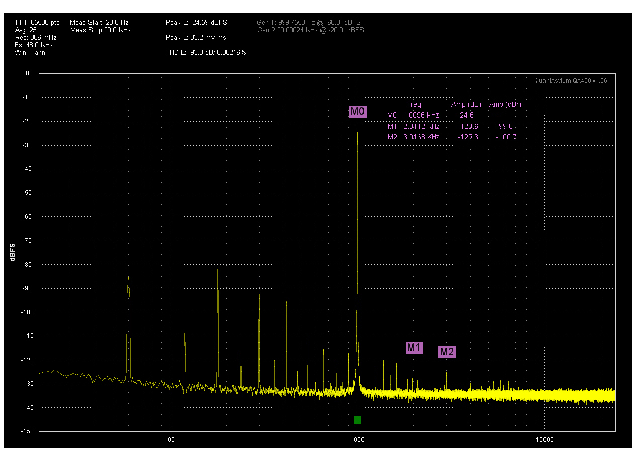

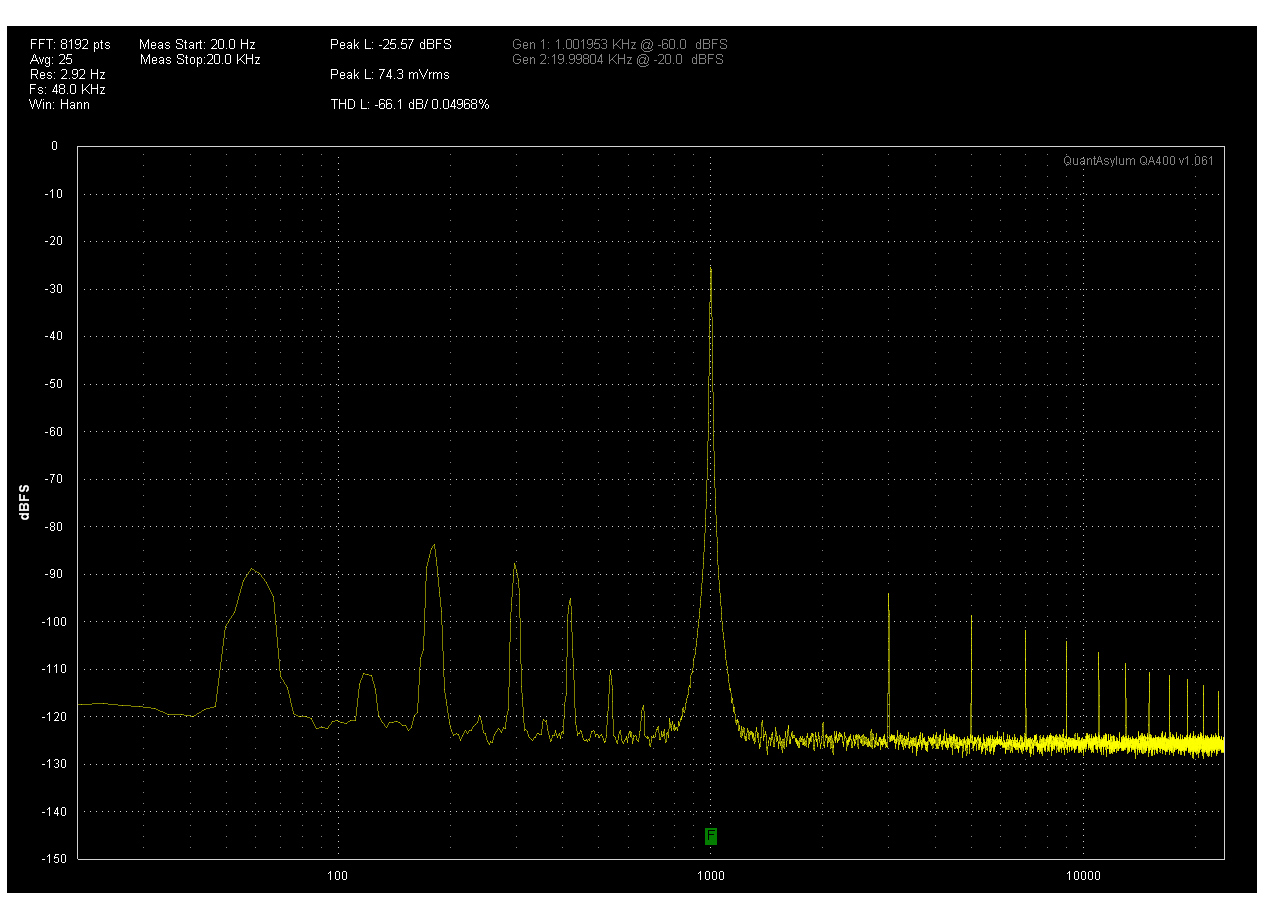

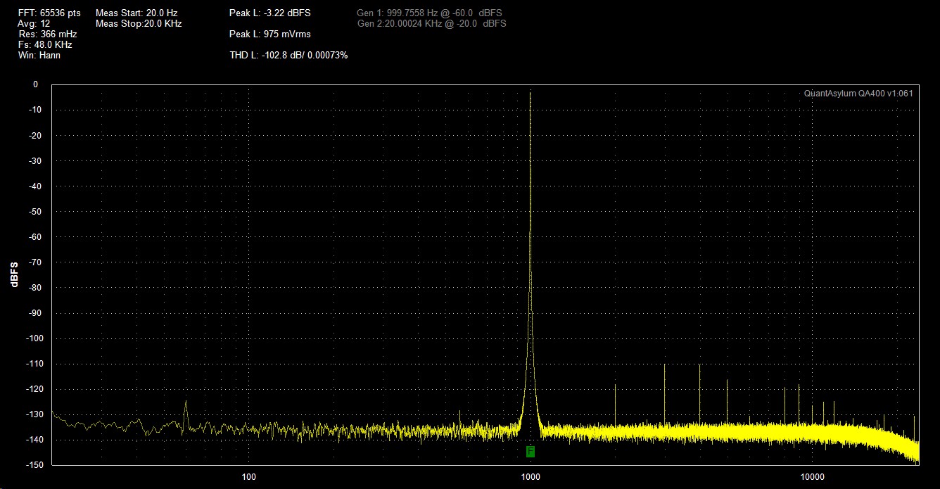

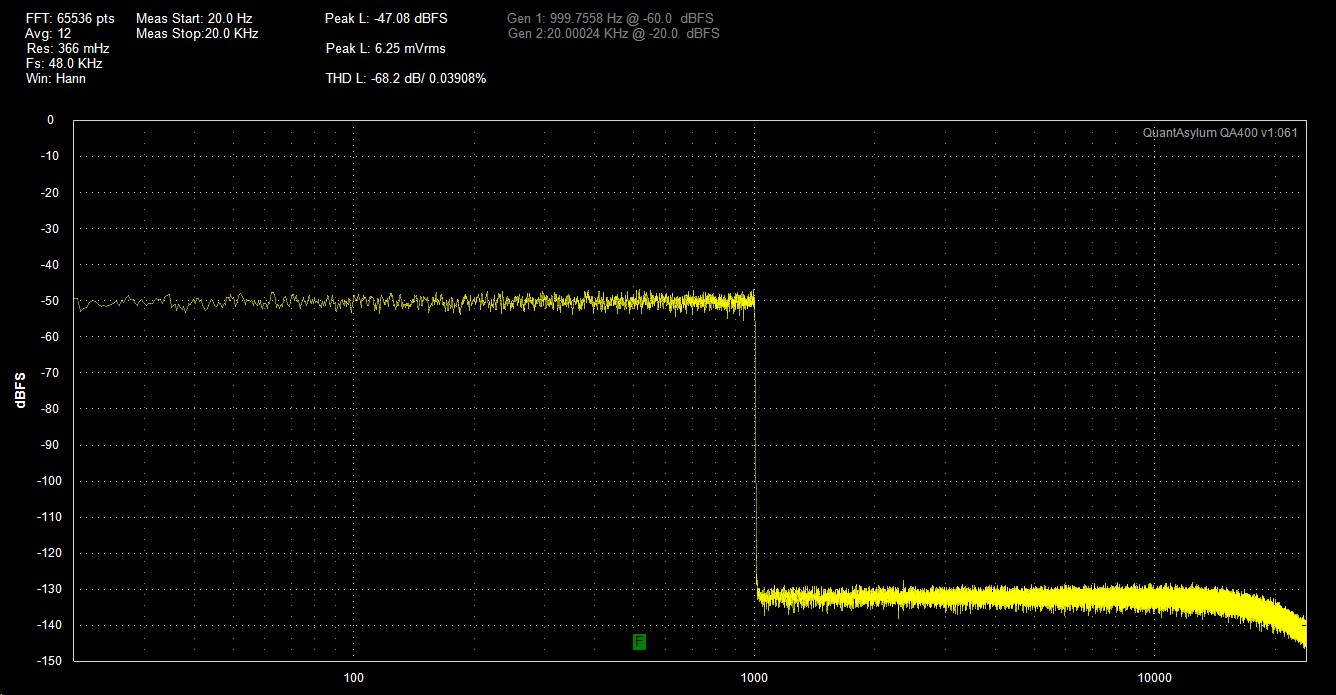

I made the changes, I wasn't expecting that big of a change.
Shocking really, the H2 and H3 down 100dB. So instead to make a buffer amp for the output, maybe I should make a new RMS meter amp.
Pics, from the left: before, after mod

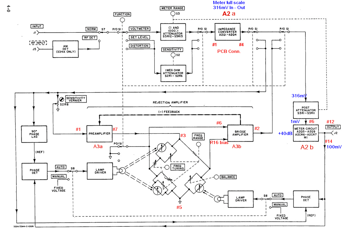

On the A2 board (Schematic in reply #505) , disconnected the meter by lifting D6 and bypassing D7.
Block diagram
Looking of the block diagram and following the signal route ,it's look like the Meter Amp doesn't have any effect on the distortion performance of the 334a.
The Meter Amp only supply the output connector and bridge nulling circuit which is at the interaction points (Lamps) are DC. Richard Moore mentioned in his greening article that, when he disconnected the lamps ,or lamp, the distortion dropped. I would suspect that's only possible if the LDR's are nonlinear.

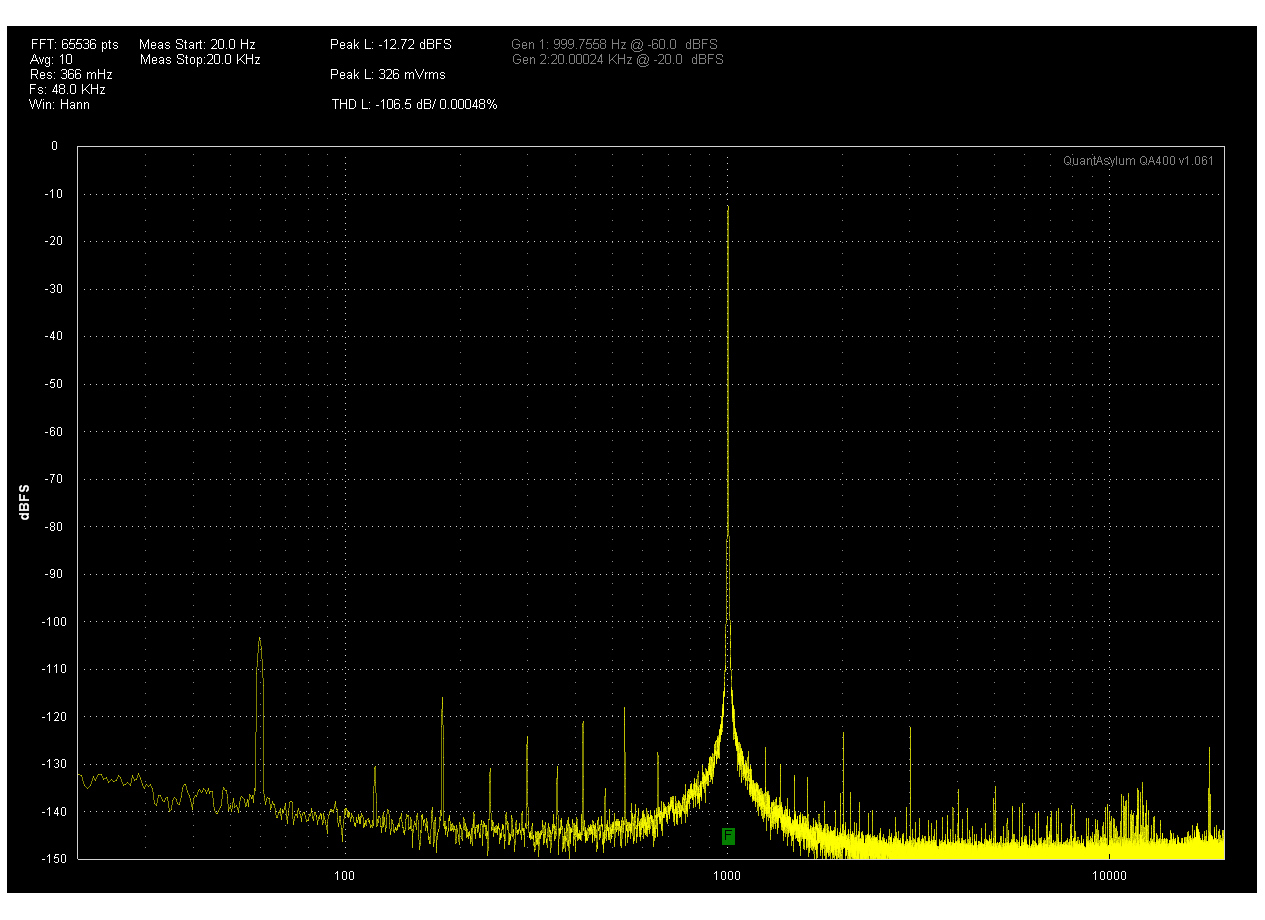

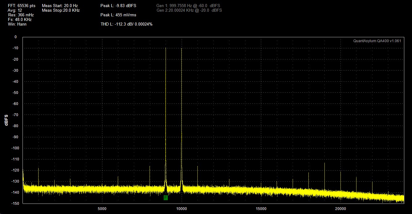

I did that before, but I don't think the THD is low enough to be a front end for the QA400.
that looks to be about as good as QA. same approx. What can be done to make it lower??
One reason I tried the 334a was its tunable notch. That part alone has good use with reducing fundemental for FFT processing.
