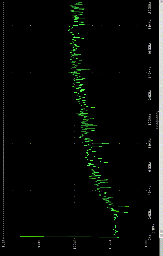

How do you go about getting a db reading from uA? You're taking the current through the load?
Yes I am measuring the current through the load. Simply out of lazyness. I'd have to scroll down a little more to find the voltage across the load resistor. Since the scale is logarithmic and the vertical lines are placed at powers of 10 they also indicate 20 dB increases.
Some more remarks to the amp. As already mentioned it is a hypothetical amp. It is capable of 1 Volt peak into 6 ohms. For this simulation it wouldn't matter whether the amp is capable to generate 1 Volt or a Kilovolt at it's output (a convenience one wouldn't have with a real-world amp unfortunately). But it is much more convenient to derive the parameters when everything is referenced to 1 Volt.
Feedback is a mixed solution before and after the output filter.

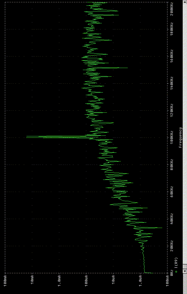

IMD, when fed with 100 kHz and 101 kHz @ -12B each.
At the output they appear attenuated by 7 dB approx, due to the output filter.
IMD products below 20 kHz are attenuated by 85 dB approx (it is in fact more, if the attenuation of the "payload" at 100 kHz is taken into account).
I know that this would be a very severe test and not even HF hash from SACD and the like would amount to this.
OTOH it is never bad if a switching amp is as immune to HF hash as a good linear amp is, in order to nullify one of the the class-d oponents' arguments.
These are just simulations of course and one would have to build the thingie in order to know how it sounds. Fine-tuning of a delta-sigma modulator might be quite a task due to the amount of parameters involved.

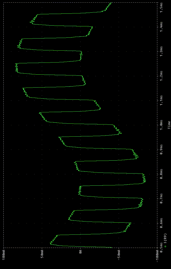

When we're at it. I also simulated 1 kHz sine-wave and 10 kHz rectangular. Both 12 dB below clipping.
The picture below shows the output signal (again current through load out of lazyness).
The noise-like switching residual, typical for sigma-delta modulation, can be seen riding on the top and bottom.

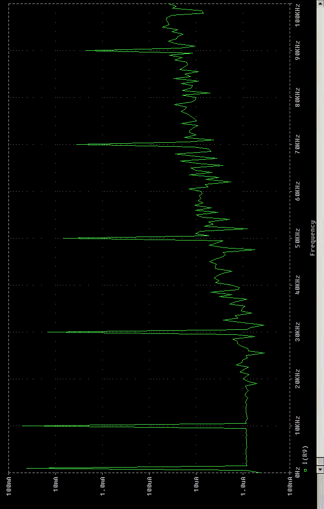

Charles,
your plots (noiseshaper like) show gave reason to suspect that your amp have second feedback loop above modulator? Of course listening is needed. Regarding UcD+2nd_loop, i left my attempt at same day when started, because sound degradation was more than expected. Probably UcD (any amp too?) simplicity is more needed for listener, then for DIYer even? (Bruno, Jan-Peter, i'm right or a not? BTW, what about yours listening with optimal 2nd loop?)
