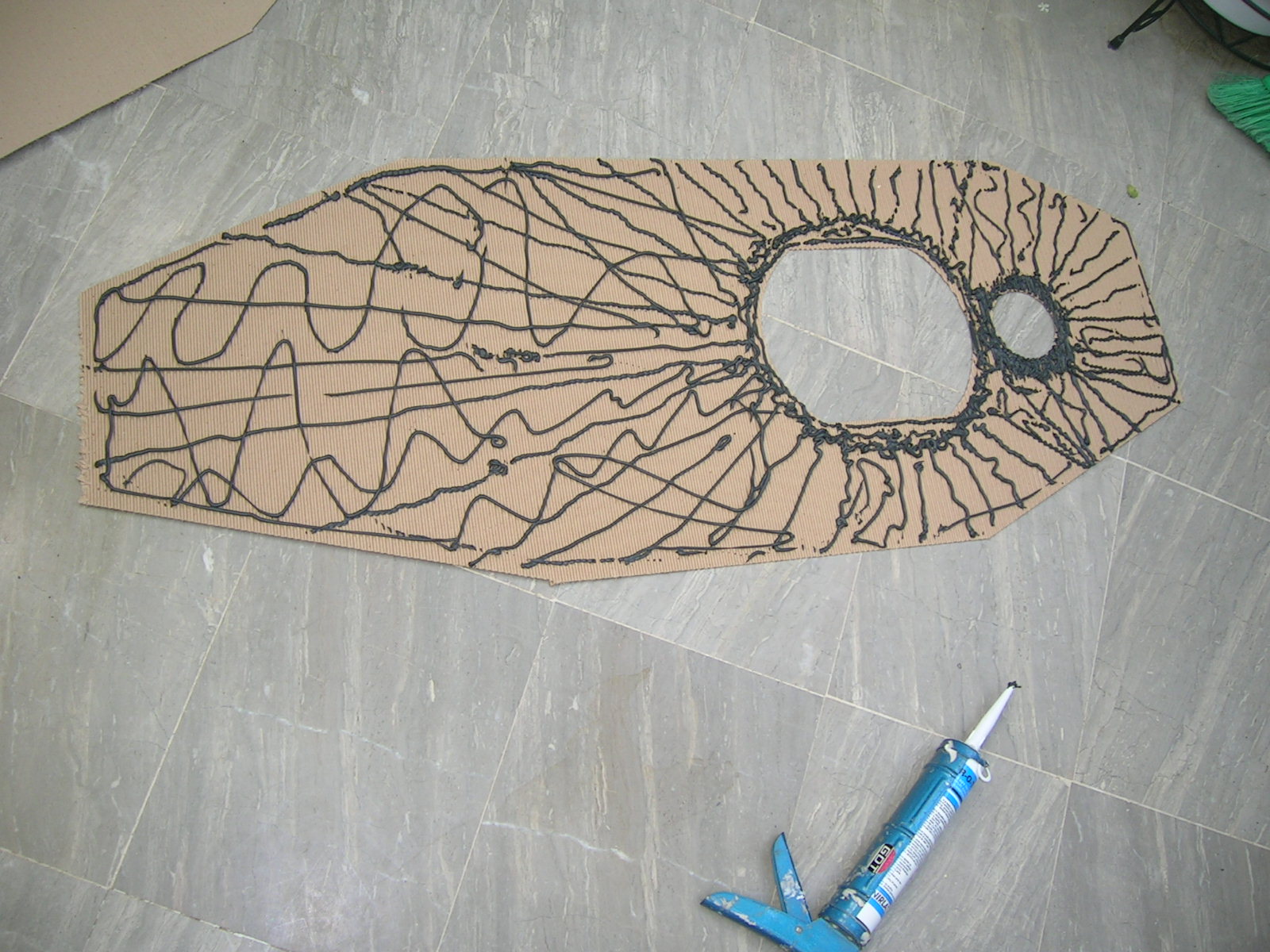

Hi all
You certainly have used the packaging paper for some proof of concept enclosure.
Used as a single sheet, is rather air leaky and doesn’t hold it’s shape above some large lengths.
But this material is IMHO capable of doing more than this.
It is very neutral in terms of own sound (it doesn’t support any appreciable amount of sound waves traveling over it’s surface).
It can be used to build rigid shapes by using it in sandwich: Two or more sheets glued one over the other, with their waving either parallel (so you can form it into curved shapes) or with an angle (90d for 2 sheets, 120d for 3 sheets, e.c.t.) for flat surfaces.
It can be “voiced” by brushing it with -or immersing it into- a varnish. The kind of varnish and the amount of it absorbed into the paper, alter paper’s acoustic properties dramatically.
In sandwich form, mechanical and acoustical properties are affected also by the way that the sheets are glued together (the kind of glue and how it is applied).
In sandwich form again, a given flat shape can be sectioned in unsymmetrical fashion in each layer to effectively kill any traveling waves through it by spreading the waves into different size and shape sections in each layer.
It can also be used as a core for sandwiching it with harder surface panels.
All these, added with it’s low cost (~0.4 Euro/sq.meter) and ease of cutting and shaping (*PS), makes it a very useful material for real speakers built in the spirit of diy.
I hope I am not repeating anyone’s input so far
Best Regards
George
*PS. It can also be shaped into some difficult shapes (up to a limit) by forming it over steam and then drying it with hot air
