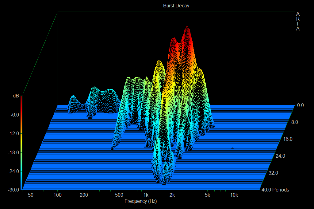

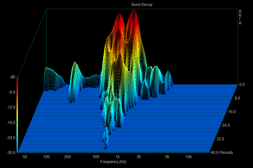

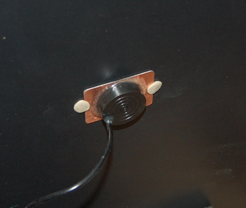

I built an accelerometer:
and I did some basic shmit with Arta to display the burst decay:
This is the broadest unbraced panel (the back) of my curved front 3-ways.
This one is from the smallest unbraced panel (the top):
Quite a difference.
I'm new to the Arta thing so I'll be playing with this for a while.

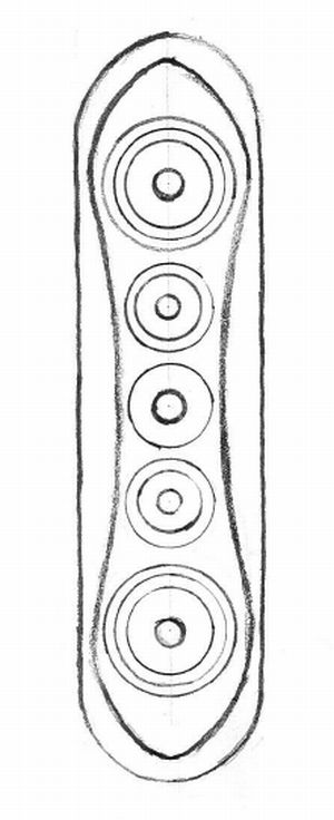

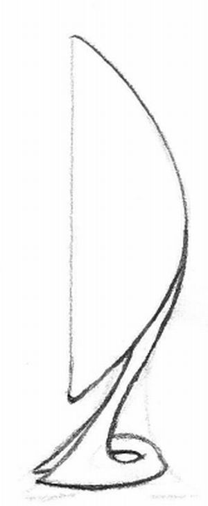

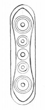

Because of the shape of the enclosure I will be building, I will almost certainly be using fiberglass to form the back shell. There will be a wood/mdf front baffle curved to meet the back shell something like the picture I sketched up below. Because the shape will be curved (almost bowl like), I anticipate the enclosures will have very good rigidity. In fact, I doubt any internal bracing will be necessary. The one issue I find with fiberglass enclosures is that because of their light weight, their resonant frequency is higher, sometimes making them (depending on size) sound sort of nasally.
I plan on building the midrange/tweeter enclosures as mdf/wood INSIDE of the main fiberglass enclosure to keep the volumes seperate for those drivers. The god thing about this is that the "shell" enclosure volume will be for only the woofers, which will be playing somewhere in the neighborhood of 300hz and down.
Would it be beneficial or just wasteful to (1) add a substance to increase mass to the resin mix (sand perhaps?) and (2) seperate some of the layers of fiberglass resin/matt with a damping product like neoprene or other foam?
