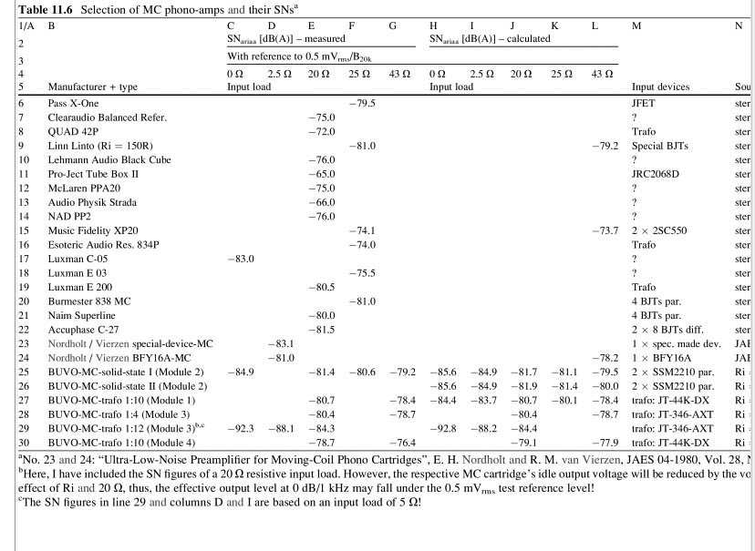

That works. As an historical point Nordholt and Van Vierzen ran a custom IC for the same Ortophon cart in 1980 (rbb = 1.4 Ohm). I have probably the only two left in existance. Your complimentary version is far more satisfying and simple (they used a HUGE coupling cap) even though they might have shaved a few tenths of a nanovolt.

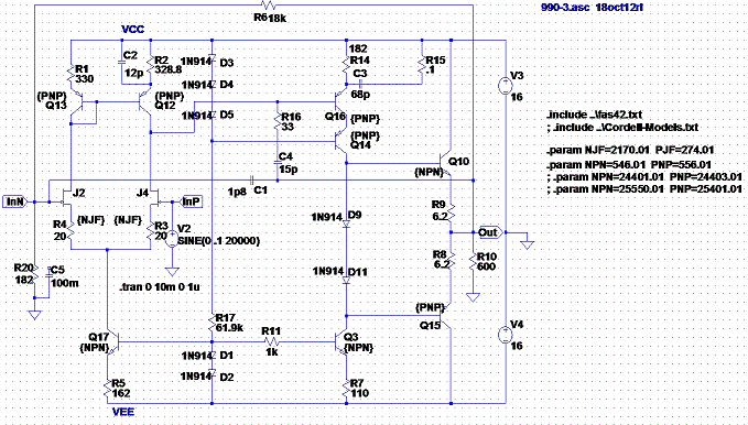

Here's a version which doesn't need the clamp and approaches Wurcer performance but I'm not 100% happy with overload. Still not sure what causes the stuff that needs the clamp in the original 990.
I've removed a complete gain stage and it still has supa dupa THD.
PLEASE let's get beyond SIM! We've talked it to death. How about a parts list with the latest additions for both the SWfetJE990 as well as the new SWOPA?
A new project needs to offer substantial benefits over tried & tested. Don't think SWfetJE990 is ready yet though if anyone has some JE990s they don't mind modding ... I now know it has the potential for SWOPA THD. Just need it to behave on yucky stuff like overload & PSR.
Gotta put back the i/p cascodes, look at PSR, do a cap vs CL gain chart bla bla ..
This is my first serious use of LTspice and I'm having fun finding out where it does (and does not) emulate real life.
Anyone know of a good tutorial on what da SPICE BJT & FET models mean?

[snip] Still not sure what causes the stuff that needs the clamp in the original 990.
[snip]
The diode prevents the output of the stage from saturating on overloads. BJTs recover from saturation a little slowly, depending upon the device type.

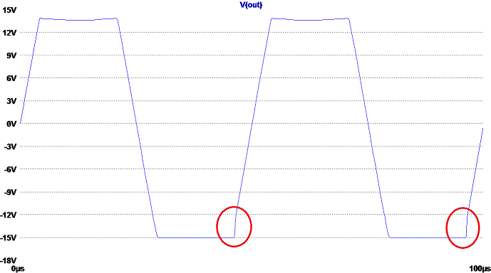

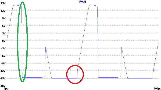

I'm not worried about saturation.
The red circles in noLatch.gif show the OPA coming out of -ve saturation. 280mV 20kHz i/p into 100x circuit with +/- 16V rails. Not a problem for audio as recovery is virtually instant.
Green circle in OL.gif shows what happens if you leave off the clamp diode on original FETje990. Something triggers on +ve overload.
