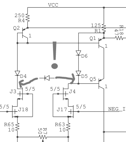

Found my power on latchup possibility. If the minus rail comes on first the input is tilted all the way to the negative side and the upper cascode collapses. The simple diode fixes this by powering the cascode if the input ever tilts all the way during turn on.
