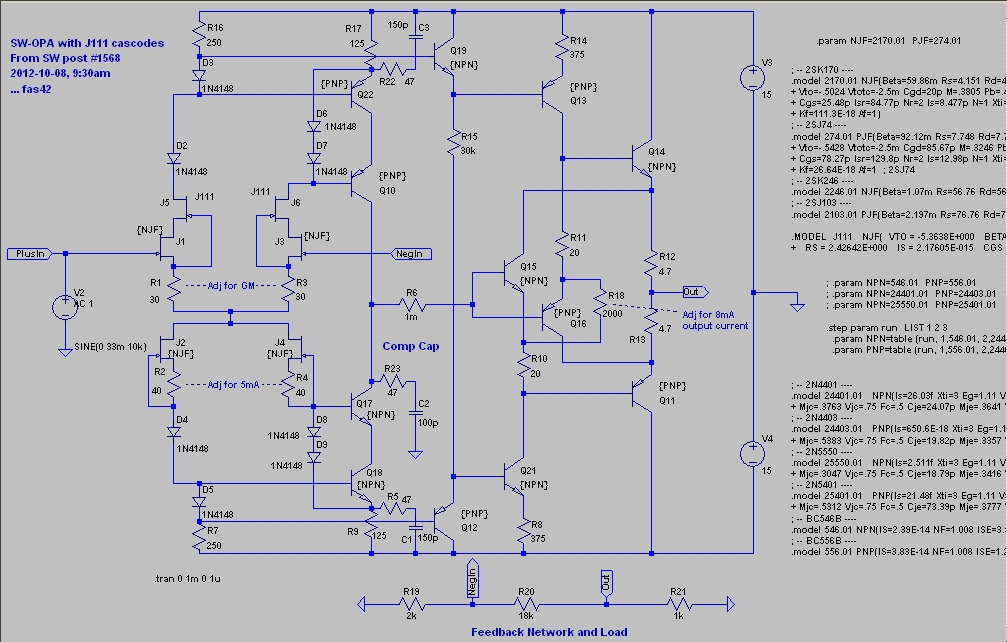

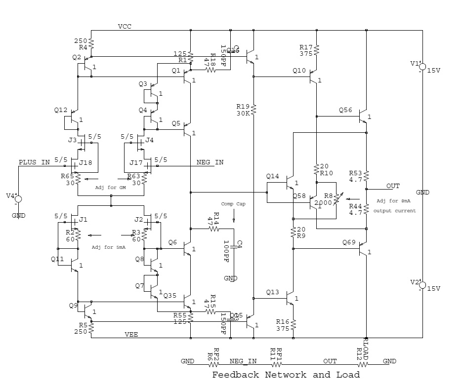

Latest schematic, I added input cascodes and tied the bias setting current surces together at the drains so only one cascode would be needed (for operation at high supply voltages).
As the whole left hand corner is now just 'constant current source' stuff, can't we get rid of J1, Q11, 9 and tie the bases of Q15, 35 to emitter & collector of Q7 respectively?
If you are using a discrete op-amp it's crazy not to take advantage of the ability to custom compensate it for each application. After an afternoon's work it looks like the compensation capacitance needs to be circa 250pF at unity gain and can be as low as 75pF for 20dB of gain. Now even the first circuit has 50V/usec symmetrical slewrate at 20dB gain. I suggest here components that can be adjusted to optimize frequency response and assure stability. I realize that the details of optimizing this circuit are beyond the abilities of some of the folks here so let's help each other and include placeholders for the optional components in any layout and those that can develop a parts list for a specific application can inform the rest of us.
I have added a zero in series with the compensation capacitance as well as a pole zero network in both sides of the gain stage. These values depend on closed loop gain and matter less at G > 10.

To keep the ball rolling, here's a quickie knock up of the schematic from #1568 for those who are averse to fiddling with the versions already posted. Appears to be OK, haven't checked everything, I'm sure people will point to any problems ... :)

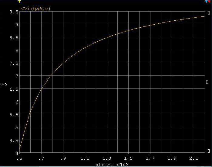

The PSRR looks much, much better of course. One thing though, can't push the output standing current up to 8mA easily for some reason ...
Frank

Fiddle around with R10 vand R11, make them a little bigger and then do the trim. There certainly are values that get the desired currents.

Here's a plot of the trim, looks like a 2k pot would be better once the small resistors are picked. Depending on the devices I would pick R10 and 11 to max the bias out at 10ma or so then the trim always goes down to the desired value. You could also just select R10 and 11 to get around the right value the absolute Vbe's won't vary that much.
Checked over supply and temp should be no problems with simple thermal contact between the four output devices.
