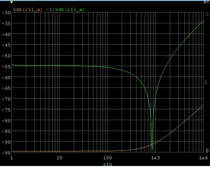

OK I was talking about the post #1380 circuit. Here's a plot of PSRR (at the output) at 20K vs source impedance when the feedback network is 1k,9k (20dB gain). Notice the suckout at exact source resistance match in the un-cascoded case.
This is with and without the J111 or depletion mode MOSFET cascode on just the two input devices. So without you need better supplies. The two devices I now would consider essential.
Does this make our results line up?

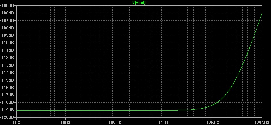

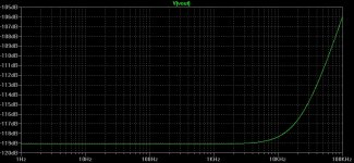

This is what I'm getting when simulating Scott's BF862 circuit with the buffer.
I have also attached the schematic I'm using, showing how I do the PSRR simulation. Maybe I'm doing it wrong?
Stein
G=1 does change it a bit but the cascodes appear to make all the difference.
And much like your post 1542 Scott, the pseudo complementary front end is better than the complementary version for PSRR. Looks just as flat in LTSpice, but even more optimistic for rejection.
I was just about to ask about the effects of impedance match at the two inputs, for which this confirms the importance.

OK I was talking about the post #1380 circuit. (duu.uuh!) Here's a plot of PSRR (at the output) at 20K vs source impedance when the feedback network is 1k,9k (20dB gain). Notice the suckout at exact source resistance match in the un-cascoded case.
Isn't this a consequence of using big geometry FETs on the i/p LTP?
You have similar effects with BJT LTP i/ps but much smaller ... especially if you use NPNs. I found this in a low feedback Power Amp design.

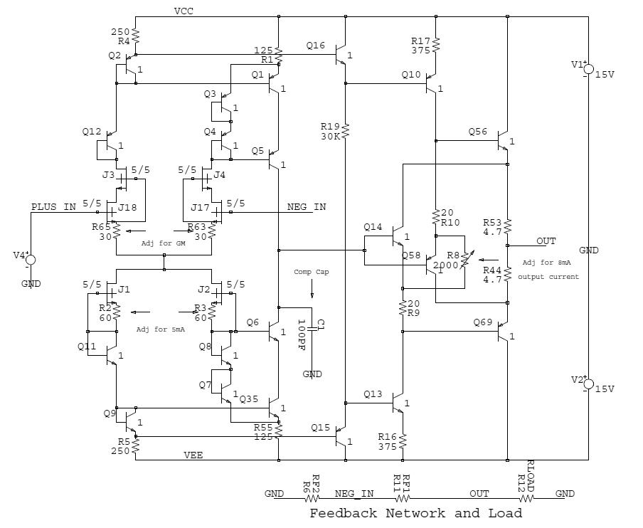

Latest schematic, I added input cascodes and tied the bias setting current surces together at the drains so only one cascode would be needed (for operation at high supply voltages). The two .1uF capacitors no longer seem to do anything (it could have been a simulation artifact) so they are gone. This should be fine gain of five and up, still looking at lower gains.
Cascodes are J111 or a depletion mode MOSFET as we discussed.

Hi Scot,
What are the NPN and PNP transistors?
