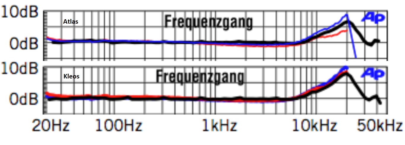

At the curves that Joachim posted, what is the black line?
(is it the “best fit” from the red( R ) and blue (L) lines-data points ?).
I see that red and blue lines stops a hair above 20KHz.
How does the black line slops down up to 30KHz?
There is not enough data in these graphs to show that red and blue also only peak at 20K. How can one tell from these graphs that they would not continue to climb past 20K (the linear slope of the blue line seems to be a data mistake)
The real form of these lines way past 20KHZ might give some clue as to what really happens and what one can do
