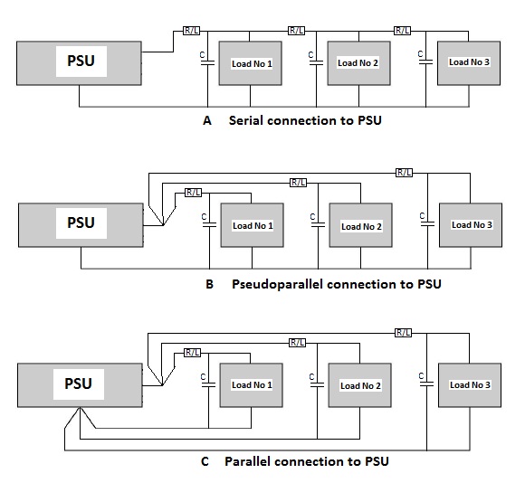

George,
Your diagram shows explicit filter elements or intrinsic resistances and inductances?
It showed intrinsic resistances and inductances.
A bit of this depends on exactly which, since serial filtering *might* yield vanishingly low noise and hum at the end of the chain.
_-_-bear
This is correct bear. It comprises a cascaded RC or LC low pass filter.
In terms of noise and hum reduction is very good and is an economic solution. In theory and more so in practice though has one drawback: Each succeeding stage's DC, rides on the modulations of the previous. If you probe there with an oscilloscope, you will see low frequency modulation. This, together with the voltage drops at the common return line which are different at each stage, cause the signal input from stage to stage to low frequency wander up and down. Visualize a coupling capacitor, the two ends of which are on different, -unequally moving- DC potentials. This, in severe cases may give rise to low freq. oscillation (motorboating).
All these do not occur with parallel connecting the amplifying stages to the PSU
For clarity, I have attached a new sketch, this time with explicit filter elements.
Circuit B is no good at all. It is not a parallel connection (common return) and it lacks the cascaded low pass filtering of the serial circuit.
jana good way is to determine the stage with lowest PSRR and put the psu closest to that.
With series connection, the circuit closest to the PSU has to be the one with the higher current demands. The furthest away has to be the least hungry for current.
And, if you're serious, use remote sensing for the regulator at that stage.

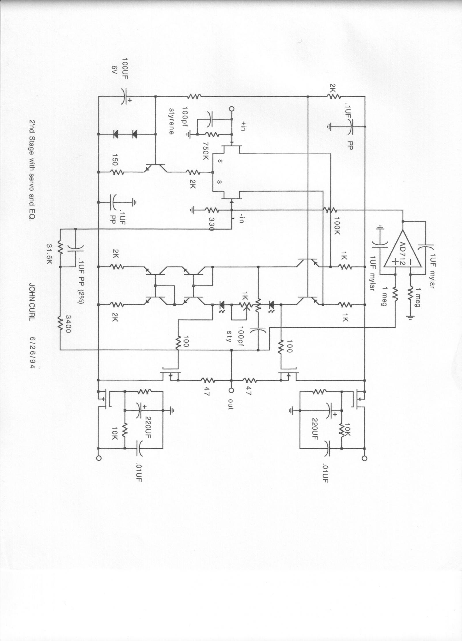

I hope I´m not too late to ask a question regarding the schematic
John showed in post #971:
http://www.diyaudio.com/forums/atta...013-discrete-opamp-open-design-scott-type.jpg
What would the approx. open loop gain be ? Would it be usable as a phono preamp
(withsome sort of buffer added to drive the RIAA network) ?
Don't agree. The idea is to give the stage with the worst PSRR the best supply, so you place that close to the reg and/or use remote sensing. This *can* be the one that's most power hungry, but is not so necessarily.
