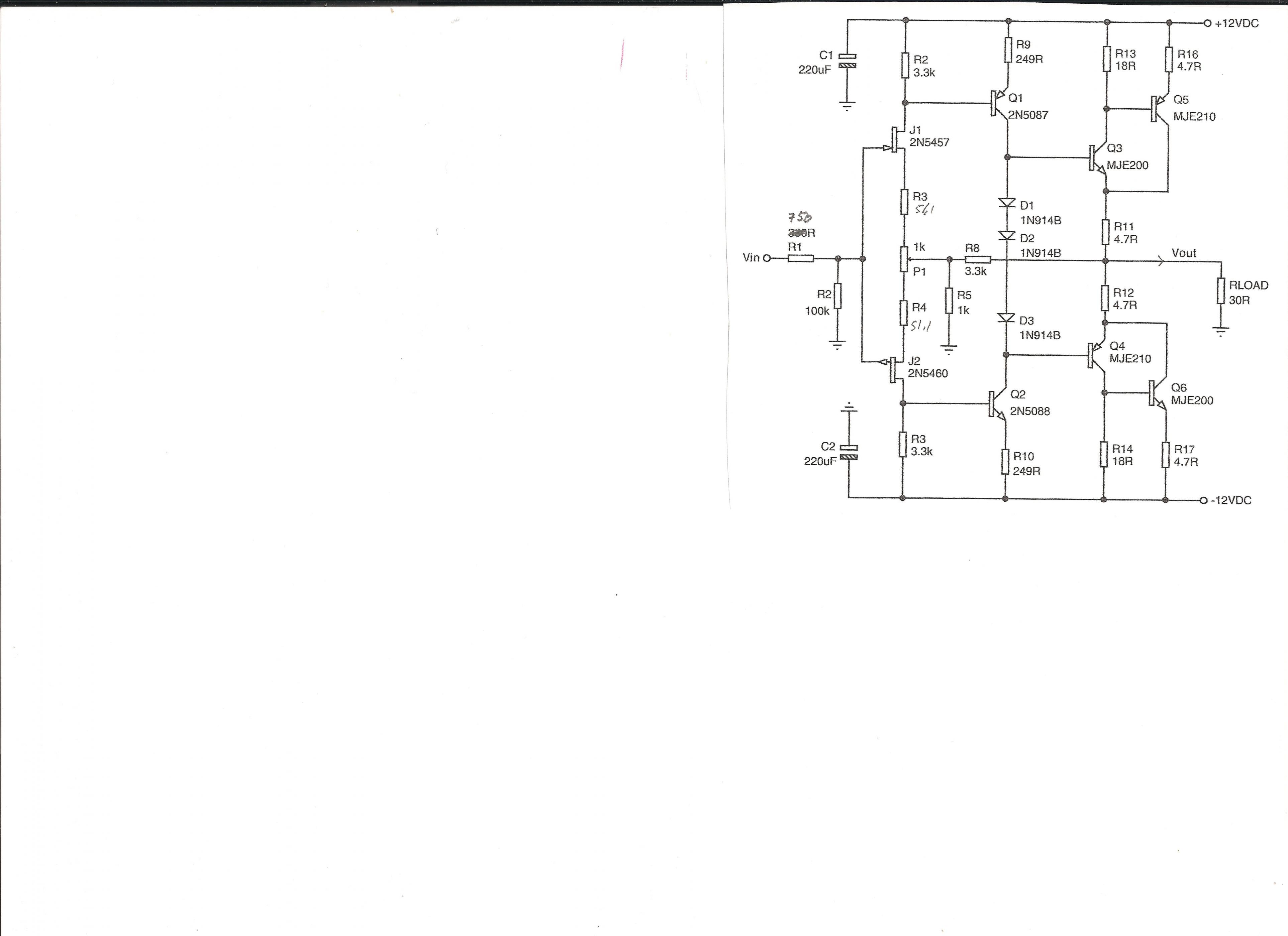

Simple circuit -100db thd and no servo needed -
Here is a really simple topology and circuit that meets my goals:
open loop bw is 25khz
open-loop h2 = -55; h3 -65
open loop gain = 62db
closed loop gain = 12db
open-loop noise (30khz bw and no wgting) = -85dbv
ref 1v into 30 Ohm load
It only uses 8 - 12 cent - transistors.
Is rock stable against dc offset changes and temp drift W/Out a dc servo appendage. And, does not have the input devices touching each other and the output does not have massive heatsinks... only individual ones. The simple diode string is not touching the output devices, either.
It can be tuned-up further. It meets my needs for a line amp. SIM the thing and let me know why you think it is so temp stable on output offset/drift. Then use what you found in your new opamp. Thx-Dick Marsh

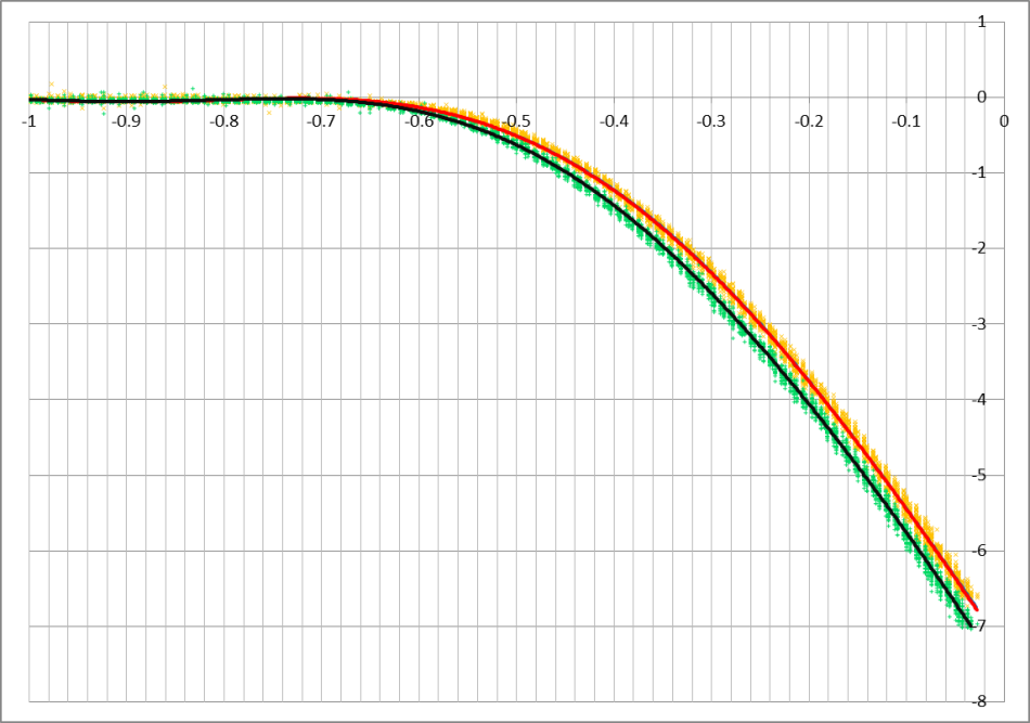

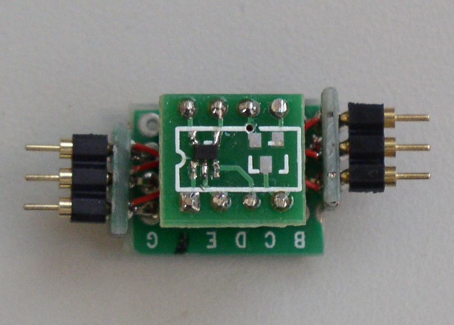

Below our own measurments of a Toshiba 2SK3320GR, same device but smaller package.
Red line = FET1 DS-reversed
Orange X = FET1 DS-proper
Black line = FET2 DS-reversed
Green X = FET2 DS-proper
X-axis is Vgs in V, Y-axis is -Id in mA.
So as one can see, decent matches between FET 1&2.
And no measureable differences with reversed Drain-Source.
More measurements to come in the next weeks....
XEN Audio at your servive. ;)
Patrick

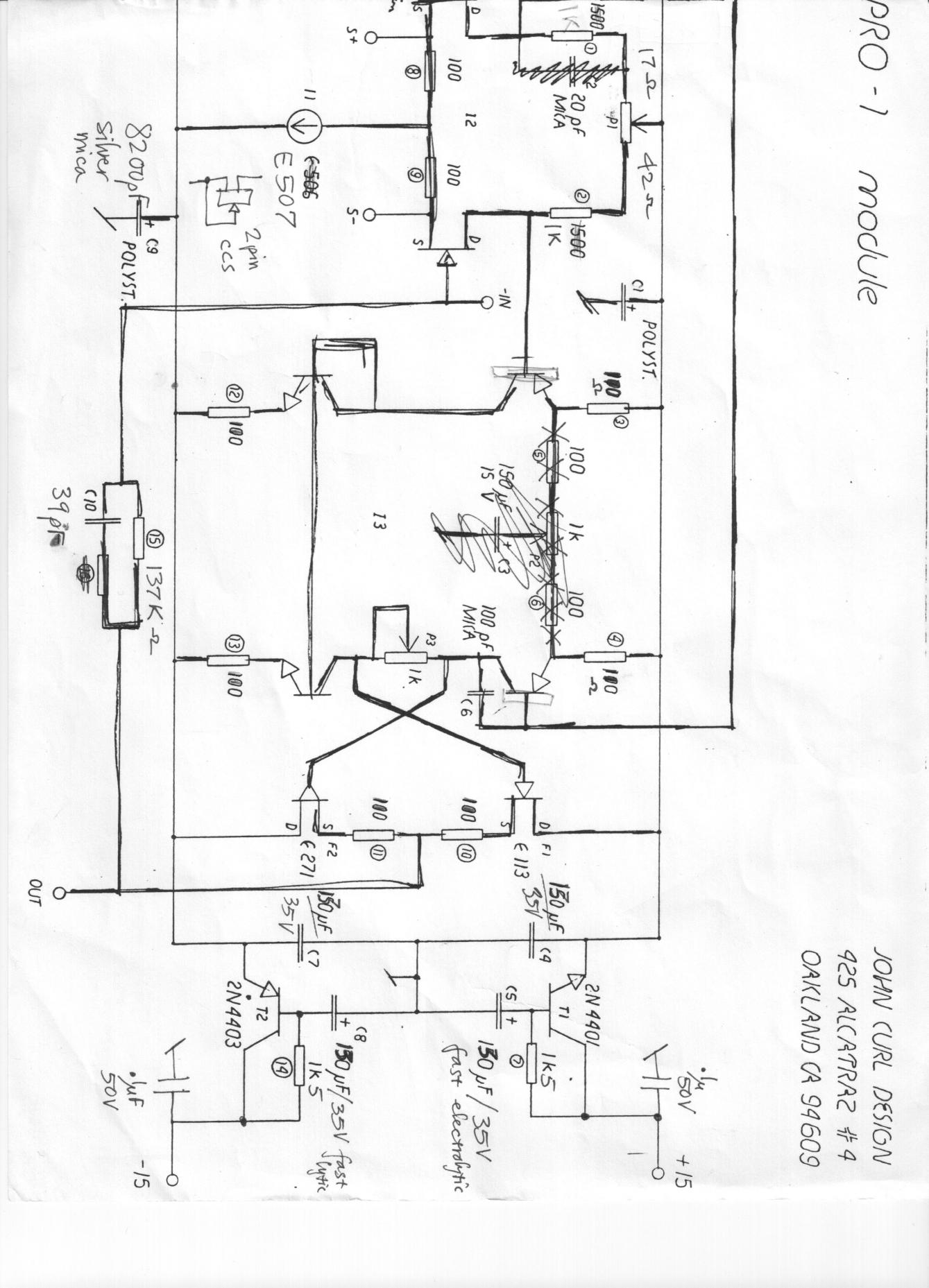

I used Google to translate the website I linked in an earlier post :
http://www.diyaudio.com/forums/anal...discrete-opamp-open-design-9.html#post3143146
As you can see the topology is essentially identical to the "Constellation" circuit John posted here first.
This particular topology is known as the Kaneda topology and is extremely popular. You can find hundreds of DIY projects from IV converters, preamps, power amps, .... based on the same. The first circuit was supposedly published in 1973 by Professor Akihiko Kaneda. I guess in those days the rest of the world was not paying much attention to Japanese audio design.
I post the translation here for your interest. The author also has a few interesting device choices.
