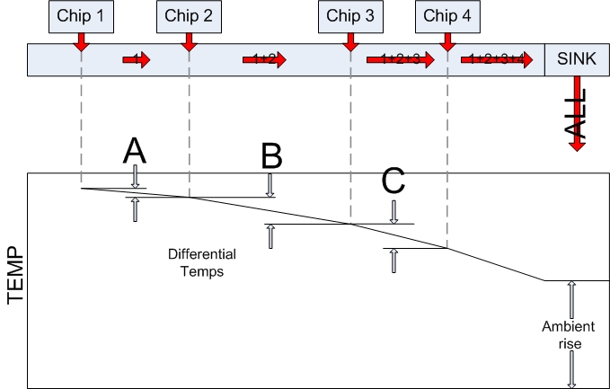

Here's a rudimentary semi-1D drawing. I have 4 chips, each dissipating equally. I put the dissipation exactly at the center of each chip for simplicity.
The sink is on the right, so all the heat flux must go towards it. While doing so, it causes a temperature rise in the substrate.
Note the differential A, it is the rise caused by chip 1 heat flowing towards the sink. B is the rise caused by the sum of chip 1 and 2 heat. C is of course, chip 1,2,and 3 causing the rise.
Note that the ambient rise is on the far right. The chip to chip rise is determined entirely by the power dissipated by each chip and the thermal conductivity of the substrate. If the substrate conductivity is not temperature dependent, then the rise chip to chip will remain independent of the ambient to sink rise.
Note also, the slope of the line between chips is proportional to the power flow. B is a large drop simply because it is a longer one. I made sure the slopes of the temp were correct with respect to the power total in the region.

I have hilted in red the salient point we disagree on. The local delta T will not increase as the entire widgit increases in temperature.
The local delta T will be dependent on the heat flow between the components of interest, not on the absolute temp. As I pointed out, if the thermal conductivity between the local chips changes as a result of absolute temperature, so will the delta T between them.
I believe bcarso and I are agreeing, and we think differently from you.
Perhaps when I get the time, I could draw it up, verbal descriptions are not easy to express nor follow at times.
cheers, jn
