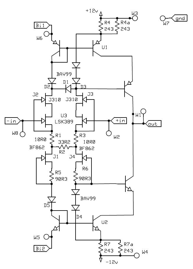

This is the input stage that I tested with the output stage I posted a week or so ago. Everything looked good, the distortion was hard to measure and the amp was stable well below a gain of 10, so I see no problems in proceeding. I have spent a lot of my personal time on this and will stop now.

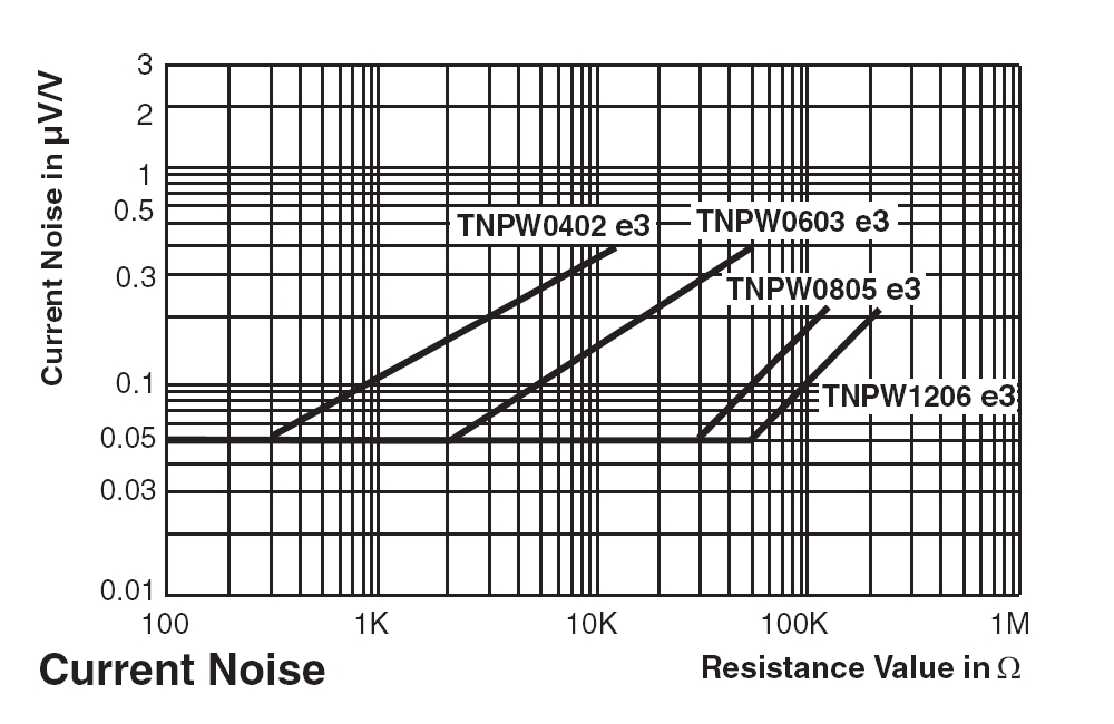

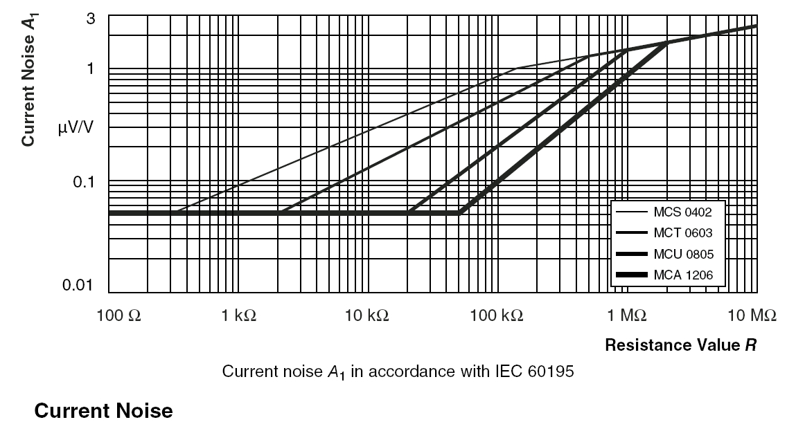

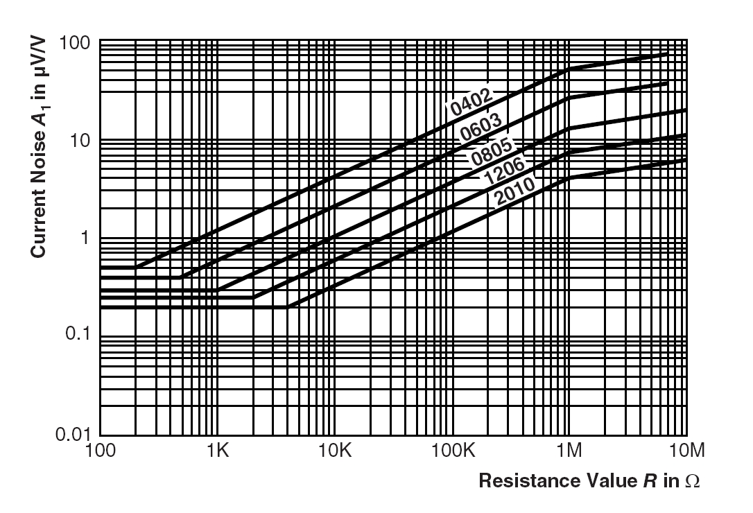

Concerning thin film resistor noise, I use these rules of thumb when doing parts selection.
0402 (or smaller :eek:): don't bother
0603 : ok up to 2k
0805 : ok up to 20k
1206 : anytime if space allows
Of course we still need to consider max. Pd, drift, max. voltage, tol. ...
I cropped a few graphs useful to ilustrate the "size matters" aspect. The last one shows the thick films...in a class of their own :rolleyes:
Interesting but there are counter examples of thick film on ceramic hybrid circuits of excellent performance or how about strain gages which operate at large DC currents.
Then there's IC thin film resistors orders of magnitude smaller where excess noise is nearly non-existant.
Interesting but there are counter examples of thick film on ceramic hybrid circuits of excellent performance....
Indeed, I noticed that the Caddock MP9100 (100W, TO247) in the LIDO link is almost as good as a thin film. Tends to correlate with the last graph I posted where different sizes don't follow the same base line so at some point thick films will meet the thin films on noise performance.
Thin films in ICs...maybe there's a catch, but I wouldn't know :eek:
Research literature indicate that noise is higher due to thickness... sheet R. bulk. I suspect that not all "thin" films are as thin as others. IC thin films might be some of the thinnest. Thx-RNMarsh
Scott,
What is the recommended offset nulling scheme?
WRT the schematic of the input gain stage in your post #2643, a trimmer between the upper current mirror emitters (U1 emitter and W6 terminal) with the wiper connected to positive rail?
Also, is output current limiting necessary / advisable for the output buffer?
WRT the schematic in post #2593 a diode clamp (two anti-paralleled connected diodes) between output and the center tap of the 30K9 resistor to be split into two resistors?
Thank you (for the great learning experience)
Giorgio
