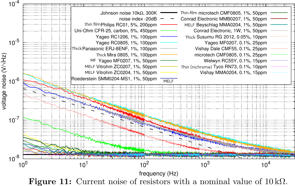

One immediate comment: although 0805 are not as bad as still smaller ones, I've seen horrendous excess (or so-called "current") noise in thick film parts. Rohm ones were among the worst. Although their availability is limited to 0.1% tolerance which is not of any particular benefit here for the most part, thin film parts tend to be very much better. But they are a good deal more expensive.
MELF parts are also fine except for their tendency to roll away :)

yeah I have to concur, using thick film in a design of this caliber is a waste and you would not expect to get anything like what its capable of.
There are a few circuit positions where thick film noise probably wouldn't be noticed, close to the output for example, but only a few. That noise source bit me badly on a front end of a subwoofer amp once and I did a fair amount of study resolving the issue, and "published" the results on the old prodigy-pro forum some years back. As I recall Panasonic parts were better than some. Susumu seems to be the go-to brand for thin film in readily-accessible distribution.
Although you need current in this case to produce the excess over thermal noise, it's also important to realize that can be signal current, not just "standing" bias current. So your results for dynamic range based on peak signal versus zero signal noise can get quite overly optimistic with excess noise a function of signal.

hey thats a nice little reminder, cheers! and yes susumu RG are excellent parts that we could push the price down on pretty dramatically with a GB

... resolving the issue, and "published" the results on the old prodigy-pro forum .... As I recall Panasonic parts were better than some. Susumu seems to be the go-to brand for thin film in readily-accessible distribution.
