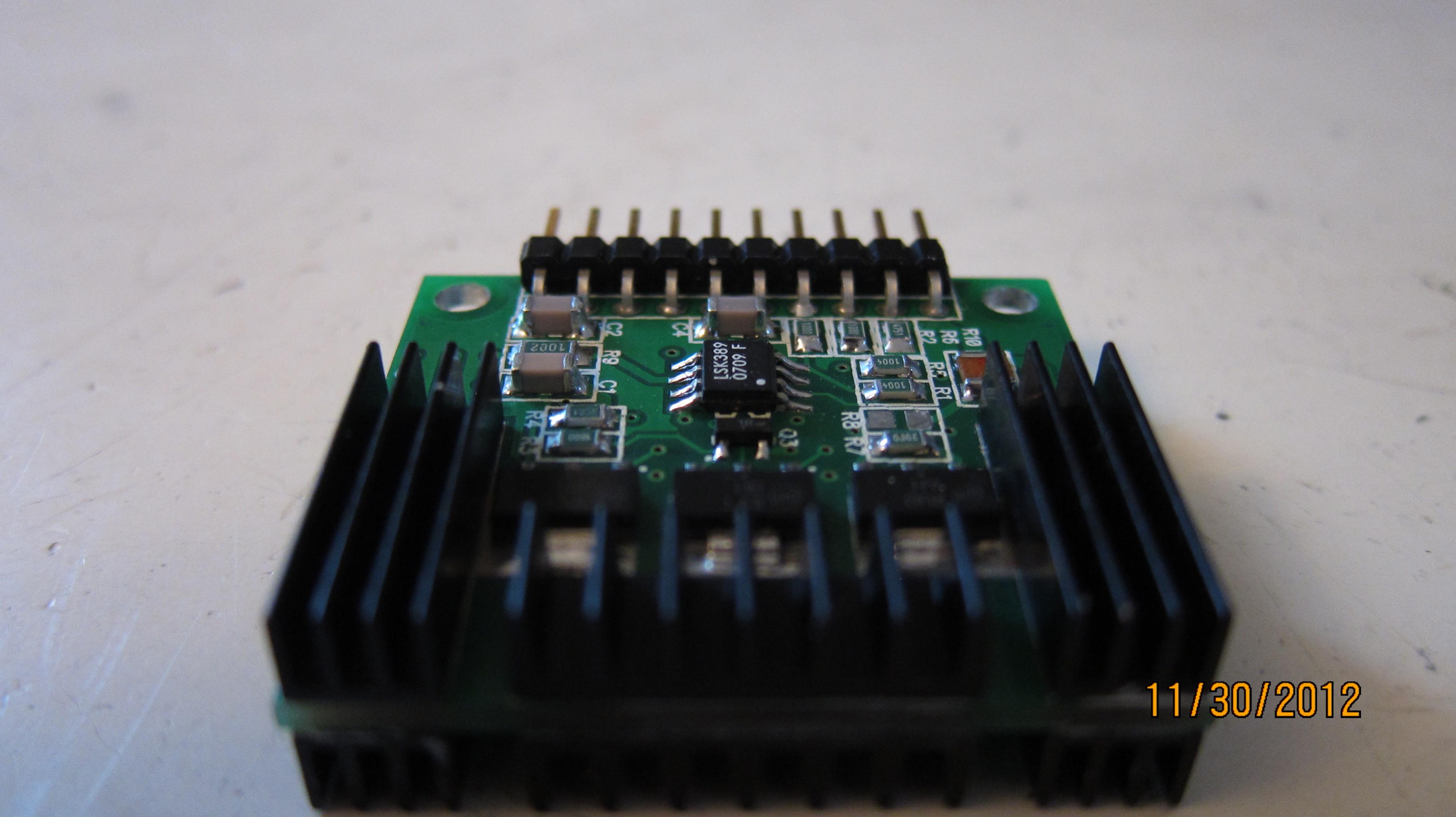

I've been a lurker in this thread since it's inception and decided to try my hand at this.
I was wondering if someone could gently outline what sort of tests would be needed to qualify a design that meets the original design goals, in both LTSpice and real-world measurements. Ideally, even a set of LTSpice files with the appropriate tests and maybe even plots, so that we can follow along. For the bench-tests, I think the descriptions can be less verbose.
In order to show this isn't a total troll, I'll post my current progress :) I'd just like to verify the design before posting details, and would greatly enjoy learning how to do this and not rely on my own presuppositions and self-learned processes.
(In case it's not clear from the photo, which it really isn't, this is a dual opamp with one on each "side". Standard SIP-8 pinout, but I also bring out PSU ground and signal ground (which I don't think is necessary, as it's a differential input circuit))

referencing compensation to signal gnd is opportunity for discrete design - can greatly improve PSRR
Cdom PSRR compensation is shown by Self, "Negative Supply-Rail Rejection" p290+ in the 5th ed of his amplifier book (and he's up to 11 in his numberd distortions)
and one of my favorite references:
“A General Relationship Between Amplifier Parameters, And Its Application to PSRR Improvement” E Sackinger, J Groette, W Guggenbuhl, IEEE Trans CAS vol 38, #10 10/83 pp 1171-1181
CiteSeerX — A General Relationship between Amplifier Parameters and its Application to PSRR Improvement - clik on the cached PDF icon
treats the problem, shows several options to improve PSRR
compensating for 2-pole TMC network can be done by connecting to cascode or duplicating the network and connecting to gnd and mirror or cascode
