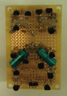

IMHO, all have various pros and cons, but if I had to build yet another line-level discrete-opamp to actually listen to music, I'd probably go with a Kaneda/Constellation derivative, despite the fact that it's not an ultra-low THD contender. Why? Because it's simple and only requires a few parts to be matched, and by most accounts, has clean wide-open soundstage and resolution.
I've seen it. Used a similar but improved version for a passive RIAA phono preamp - decades ago. I like the newer designs -they are better, more refined performers and some are simple as well.
Breadboard, Bench
Not that ugly...

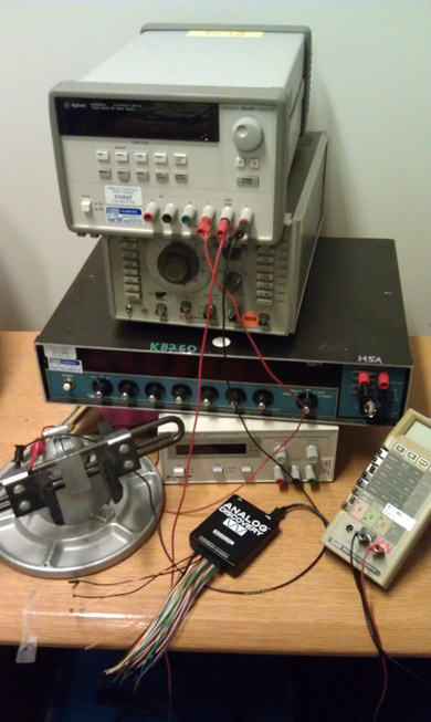

What! you don't like my stack system?
I rate that stacking as particularly uninspired, especially compared to the originality in the discrete opamps presented in this thread. Unfortunately I don't have a photo showing how I used to stack a microwave power meter, frequency counter, spectrum analyzer, and sweep generator in the superstructure of a satellite earth station antenna.
By the way . . . what is the test equipment list (Mfgr/model #)?

p.s. - I see generally how the SW-OPA works but even with Scott's "Circuit Description" document, and several hours of poking around with LTSpice, I can't work out a real analysis of the VAS and output stages.

Scott what is that multi-input pod on your testbench? . . .
Read about the Digilent "Analog Discovery Design Kit" at :
and:
It has received passing mention a few times on this Forum; e.g. Post #2022 in this thread. It certainly looks like a useful tool - though if I had the money for it, I'd have to first decide whether it was a supplement, or a replacement, or a duplication, of my Tek TDS1002.
