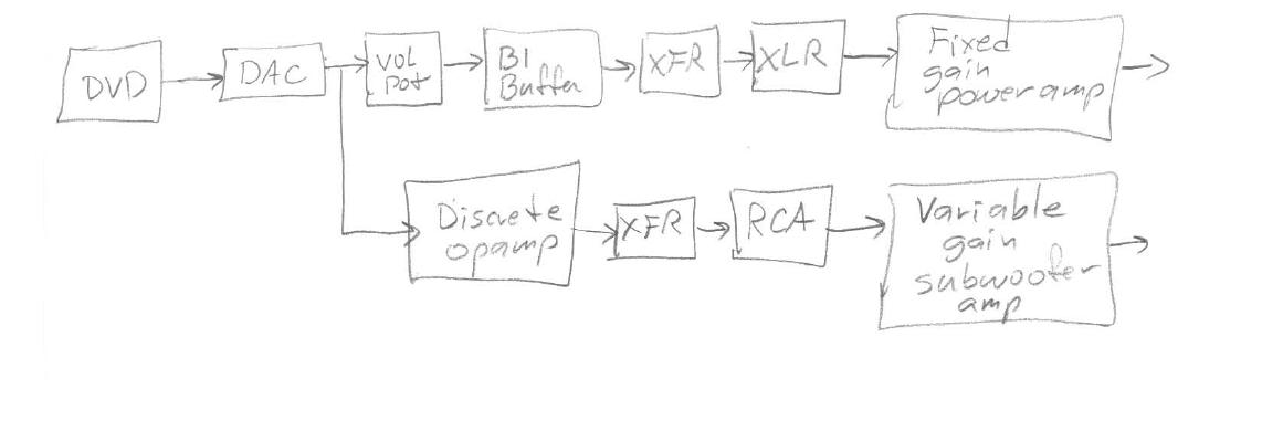

In other words, this discrete op amp is just one part of a much bigger system.
Some of the circuits that Jensen shows for their audio output transformers shows them connected to both balanced and unbalanced jacks, but I don't know if they intend that both outputs be driven at the same time. I sent them an email with that question a while ago and they have not responded, so I don't know. It seems to me that it would be wiser to have separate driver/buffer/opamp/whatever for each output. So, that's where this whole thing got started.

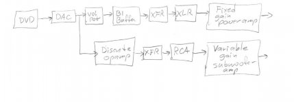

What's the purpose of the two transformers in that post30 diagram?
You said they were 4:1, that implies a 16:1 impedance ratio.
Are you sure what you mean when you said, they are high impedance transformers?

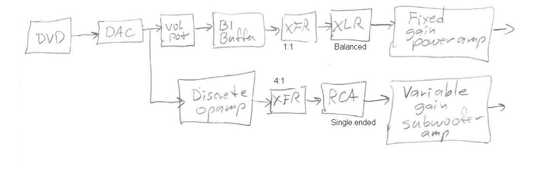

Sorry I wasn't more specific. Only the one for the discrete opamp output is a 4:1 type. The other, which is attached to the B1, will be a standard low impedance 1:1 output transformer. The transformers provide a host of advantages, including rfi filtering, ground isolation, and single ended to balanced conversion (for the one attached to the B1 buffer). The reflected impedance of the 4:1 transformer will be about 45kohms, so the drive transistor Q4 of the discrete opamp will have a reasonably high load. It's sort of like a single ended tube arrangement.
There is no point in using a 1:1 output transformer between an unbalanced output and an unbalanced input.
What is in the Fixed gain power amp? If it too is unbalanced input, then that's another output transformer going to waste.
Sorry if the sketch is confusing. The 1:1 transformer is connected to the single ended B1 on the input side and to a balanced XLR on the output side. The fixed gain power amp is yet to be built. I just mean it doesn't have a volume pot on it like the subwoofer plate amp does. The fixed gain amp will have a balanced input.
I ask again:
what is the purpose of the transformers?
A balanced to unbalanced input transformer inside the yet to be built power amp will perform far better than an output transformer at the Source.

The 4:1 step down transformer provides a high load impedance for the wimpy discrete opamp. The 1:1 transformer obviously converts single ended to balanced. I believe I need balanced connections because of the high RFI produced by the plasma TV. Obviously the yet-to-be-built power amps will have transformer balanced inputs. Sorry I wasn't more clear.

This gets more complex by the minute.
I don't think RFI from the plasma will be an issue in practice. A bit of distance works wonders.
Driving a transformer from that opamp... that's an unknown quantity. Obviously very transformer specific, my feeling is I don't think it would be satisfactory. You need a purpose designed circuit to get the best from any transformers. Just hanging them on the output of an opamp, discrete or IC may show problems on test (overshoot, or it might provoke instability etc). You need the test gear to prove it all works OK with the very specific parts you have.

OK, then how would you drive both a balanced and unbalanced output at the same time?
Administrator
Joined 2007
I wouldn't want to use transformers tbh... but you do which is fine :) and so that is why I would want the parts in front of me to work with and develop something suitable for driving them.
For unbalanced to balanced and vice versa I'd probably look to an all opamp (and not discrete for this) configuration as a preferred solution. Problems such as ground loops should be able to be taken care of in the overall design and implementation of it all.
