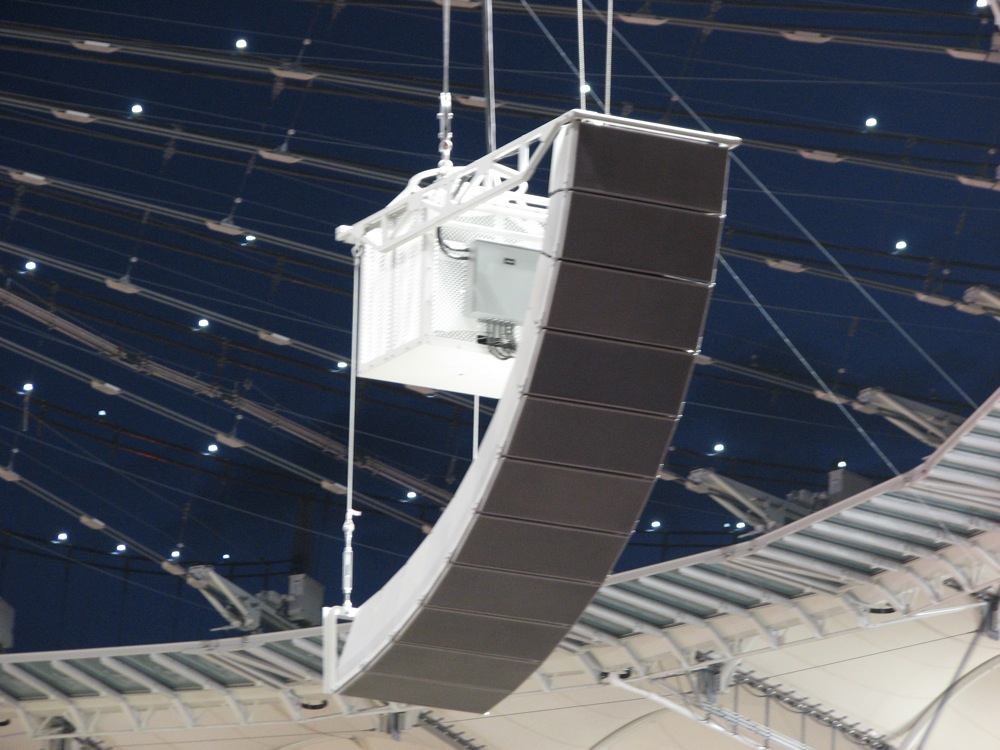

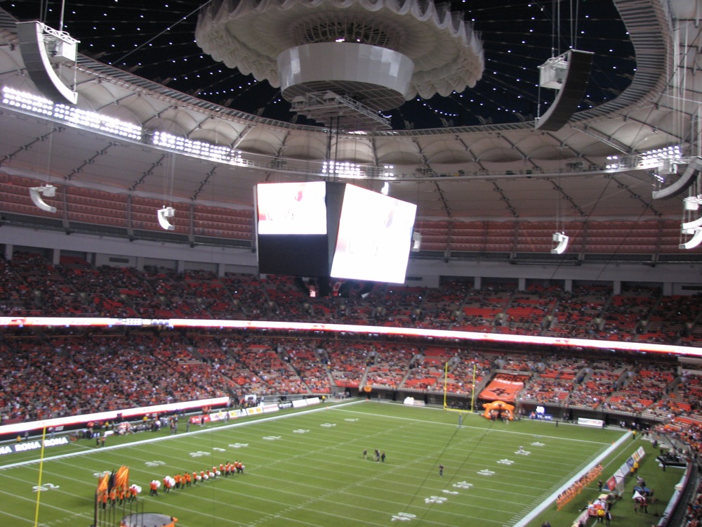

First is it right to criticize what was installed vs where it was installed? Seeing the picture and past experiences listening to bigger venues, it seems those arrays are hung far too close to the stands and too far apart from each other. Maybe they have good coverage, maybe they don't. After reading the article, it almost sounds as if they would have preferred to hang them closer to the center of the stadium by the screens, but due to the roof it wasn't possible?

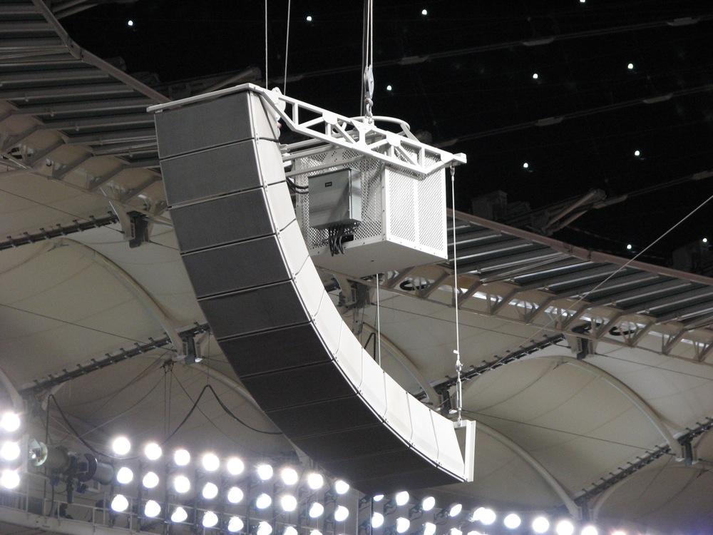

"Installing the loudspeakers was a challenge, according to Devenney. “We deployed 12 clusters of 11 speakers each, arranged in an oval ring to cover the seating areas, along with 28 VLA601-WRC’s under the scoreboard to cover the field,” he said. “In addition, we placed two JBL PD Series loudspeakers to fill the area underneath the scoreboard.”
BC Place previously had an inflatable dome roof, with the audio and lighting equipment hung from the roof. The new retractable roof has an open space in the middle, and all of the JBL VLA601-WRC clusters hang off winches. "
If they were hung closer together, would they not have better clarity even with possiblities of interference patterns (although coverage angles could be utilized to prevent)? I always though more centralized monophonic was a better solution in such large echo chambers rather then distributed scattered sound? Afterall, is that not a similar basic concept to the Danley point sources....i.e. less scattered sound?
I wonder if they could use the winches to pull the arrays closer to the center of the stadium, but then distance plays a factor too. Still I hypothesize it would still be better. It probably would be better to have gone towards the 30deg coverage ones instead of the 60deg as well if doing this.

What I see is that the arrays need to be where those screens are in the middle. Delay is not going to fix your problem. Look at it as the stadium as a round bowl of water and if you stick your index finger in the center the waves created on the surface ripple to the outside edge. the goal is trying to receate that but with sound waves. Regardless of eqing etc. Some slapback is always there, but can be controlled by signal level.
