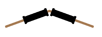

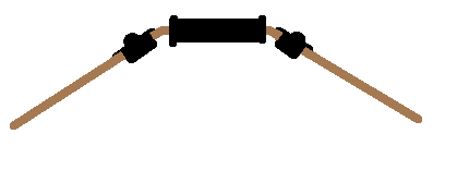

And sure they have roughly the same dispersion as a 1'' tweeter, but what if you add more tweeters, maybe also at angles like in my very professional example image (rear firing tweeters also ofc) and then cross 6/12 db at around 10 khz or so. Just too slightly help off-axis so that off-axis dispersion is the same at 10-15 khz as at 2 khz. The question is though if you need to add an array of tweeters not to mess upp impulse response or if it is so high in frequency it doesn't matter?

Sat some more and thought about different solutions around the off-axis problem, and thought of one that should be the ultimate of simplicity:
If one planar has a non-ideal off-axis response why not just use two, and mount them at an angle?
And if I use two, I'm considering using two RD50 instead of RD75 and raising them 40cm and placing them ontop of the subwoofer. Would it be a problem to raise them from the ground by that height or is the only "problem" that if I lie on the ground in front of the speaker I might not have perfect output?
