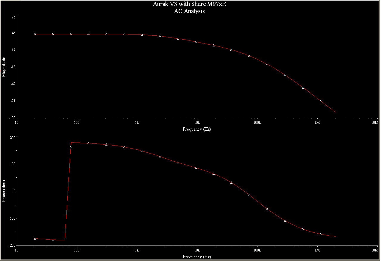

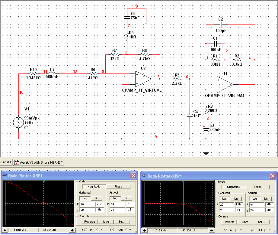

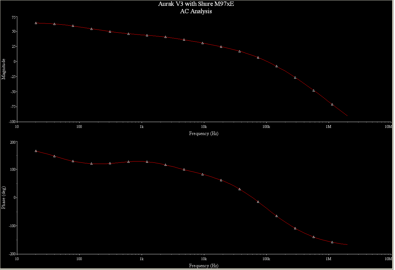

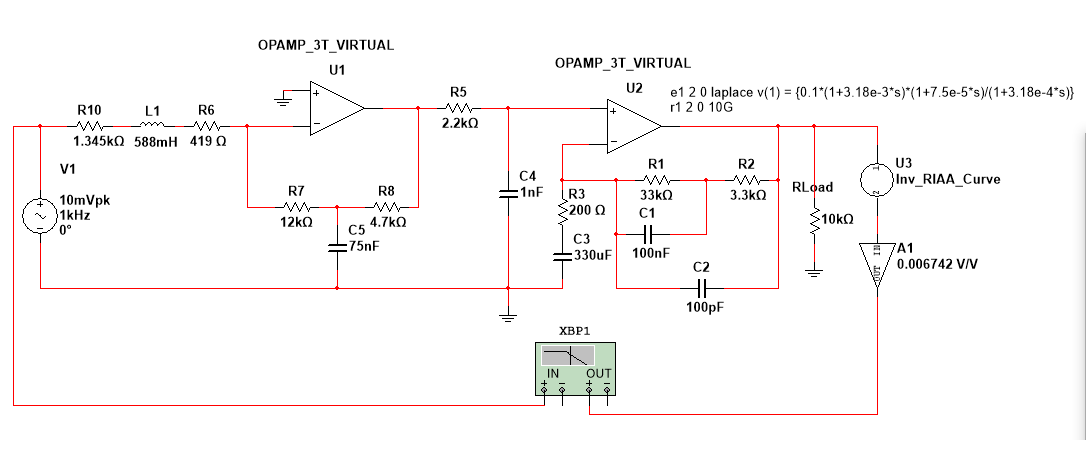

Bill, your density is normal. I was wrong.
The first stage of Aurak can’t be used as a flat preamp.
So the two options are Aurak to be used either as the intended RIAA preamplifier, or as a preamplifier with the 2120Hz roll off by placing a short across R1.
R2 can be adjusted to control the gain of the second stage.
George

gpapag said:
I may be a little heretical on this but on the subject of frequency response I don’t neglect the results of the signal generator in series with the cartridge.
I may be being dense but as the transimpedance loading effectively puts your HF pole at 150Hz. If you don't take the free roll off then that's an extra 20dB of gain that you need to add which can only make noise worse?
My method takes into account ALL response wriggles including those introduced by loading, preamp ...
We just have to trust what we measure on the Test Record. It can also correct the cartridge/arm bass bump.
But for de-clicking, Wayne's flat preamp without EQ is probably best. The less EQ, the shorter the clicks and the easier to identify & kill them.
BTW, the transimpedance is probably (in theory) one of the best LN methods and this is independent of the gain required. Aurak doesn't take full advantage of it. But it does introduce EQ which will lengthen pops & clicks.
Also if DSP EQ something like a speaker or cartridge, what you DON'T EQ is as (if not more) important than what you EQ.
There are many naive digitial EQ methods that give poor results because of this isn't take into account .. some from really big names in academia & industry. :eek:
George

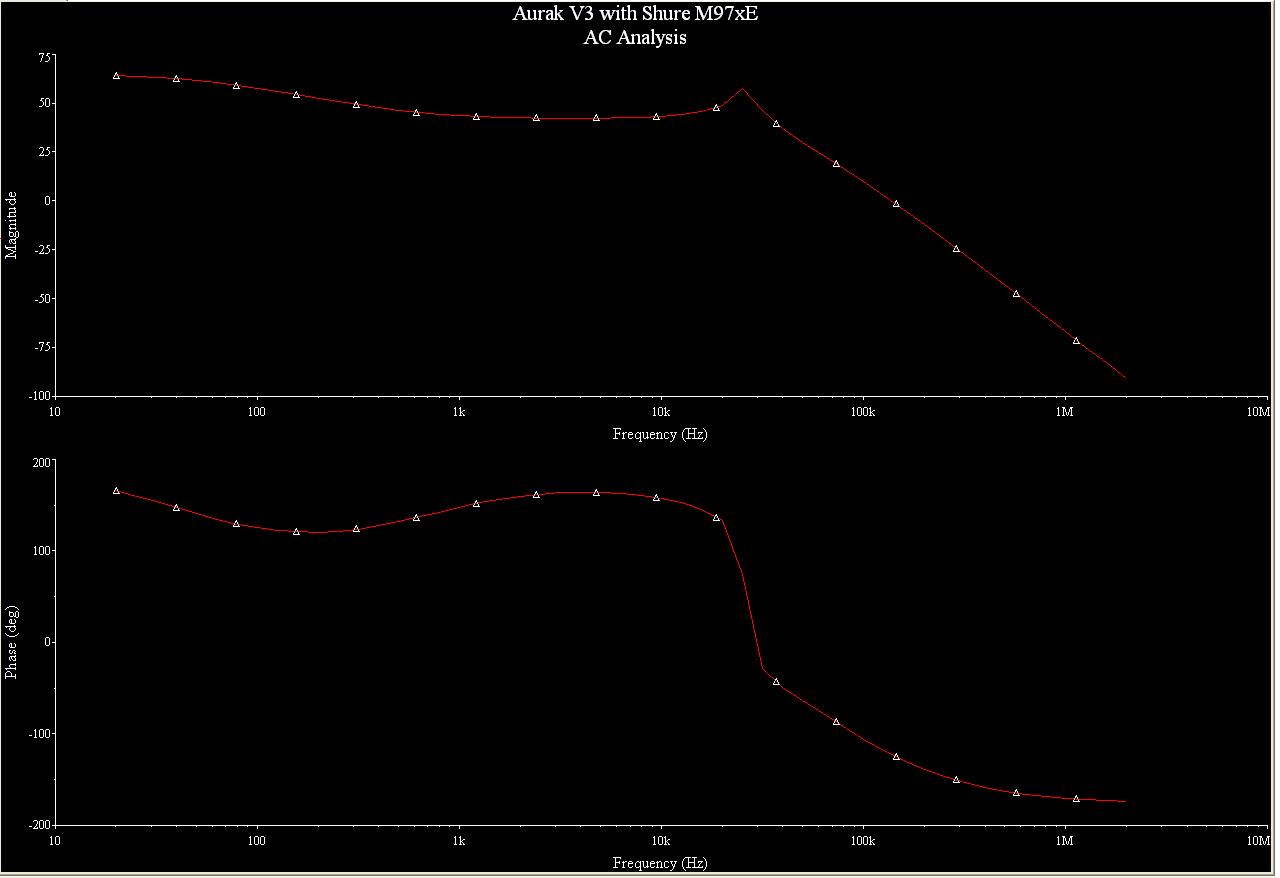

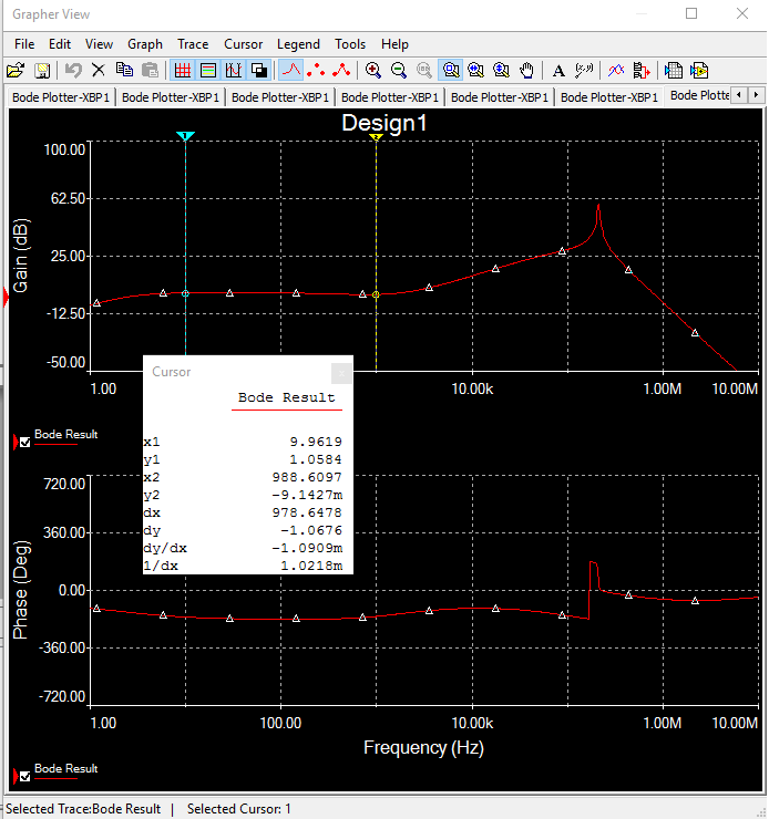

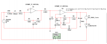

You might want to run that example out to 2 MHz --
That's some old script I quicly made about a year ago and even in that script p2 and z2 are variables! You sure noticed the mention in my earlier post that I be able to prepare these filters with different quality characteristics ... using and changing only value z2 for that won't work.
Sorry I missed that, when all poles and zeros are adjusted simple optimizers don't work. Adjusting only the last two still under constrains the problem. I was going correct my oversight but the site went down for me last night, I apologize.

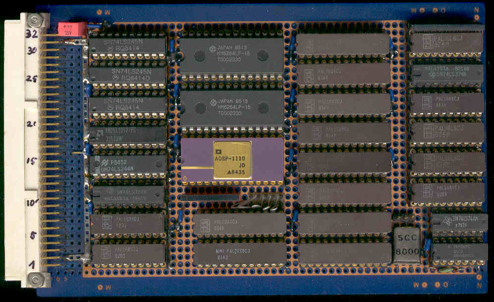

We had a similar problem when we made our first 16 bit DSP multiplier, how do you test it? Try all 2**32 possible inputs and check each one?
But you did a good job! :D
Gerhard's FIR-Filter, 1984:
The algorithm was first written and debugged in Turbo Pascal on a Z80. Then the Pascal programm was divided into states so that at most one data and one address transaction were done in parallel. The resulting state machine was rewritten for CUPL on a VAX11, translated, simulated, optimized and sliced to many PALS by CUPL. Barring one wire wrap error, the board worked right away.
