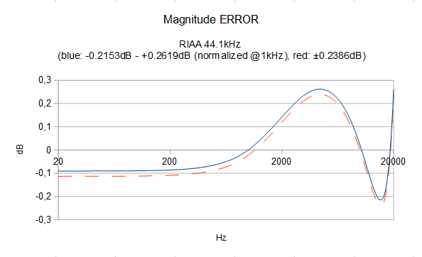

IIRC, biquad coefficients for 44.1kHz RIAA EQ filter my EqualizerAPO script spits out has magnitude error of around +-0.3dB
I doubt anyone can hear a difference, that's not the point. I saw you asking around the DSP forums for better solutions with a single biquad, there are none.
Attached comparison between Orban's and my MZT based RIAA filter against analog model (notice that error in my filter is quite small at below 10kHz area).

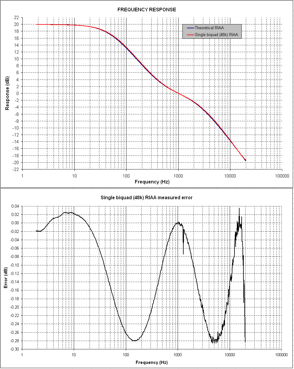

For comparison, here are results from Scott’s single biquad and dual biquad at 48KHz
Please notice these are measurements at the output of 2x4 MiniDSP. Droop at LF and spikes are not due to the DSP coefficients.
See this post for details

44.1kHz biquad RIAA EQ prepared using programmically fitted s-plane coefficients with MZT method (MZT transformation method seen in my recent EqualizerAPO script) already gives good enough results (though alternatively I'm able to produce same filter programmically the way that the error below 17kHz area is less than +-0.1dB ... who prefer which) --> see attachment.
IMO, it's all the same who has the most accurate filter for 44.1kHz or 48kHz because of the less than 0.1dB difference between them is not even hearable.
