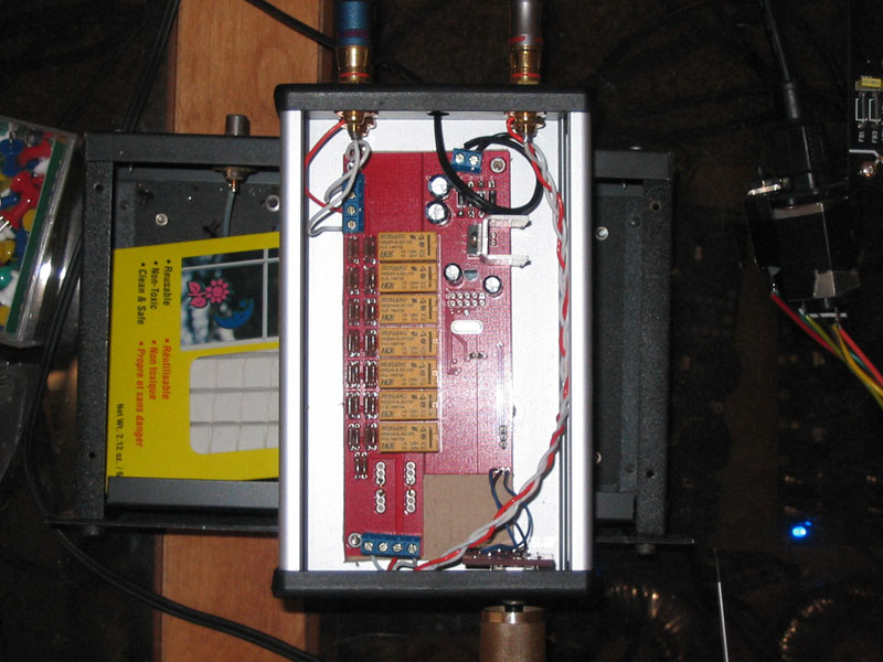

I would like something like this..> http://www.audio.webd.pl/projects/rel_vol.html
Or http://eshop.diyclub.biz/product_info.php?cPath=85_186&products_id=112
