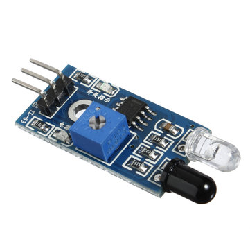

I'm not familiar with the obstacle avoidance sensor. Any sensor that produces an accurate pulse to ground once per revolution will work. By "accurate" I mean that it occurs at the same point in the rotation each time. It should also have fast rise and fall times. People have used optical interrupter circuits, reflective tape with LED emitter/detector pairs or Hall Effect sensors.
I've been using this sensor which is plainly an IR sensor for Arduino and Pyramid's Hall Sensor, both work nicely as long as the sensor is mounted or adjusted within optimal detection range. No need to alter the code.
I own a VPI Classic 1. During some tests, I stuck a 5mm disc magnet at 10-15mm from the outer edge of the platter underside, positioned the Hall sensor pcb directly underneath and it read well. Currently, I've not mounted anything permanently till I complete the SG4 speed controller sometime in the future.

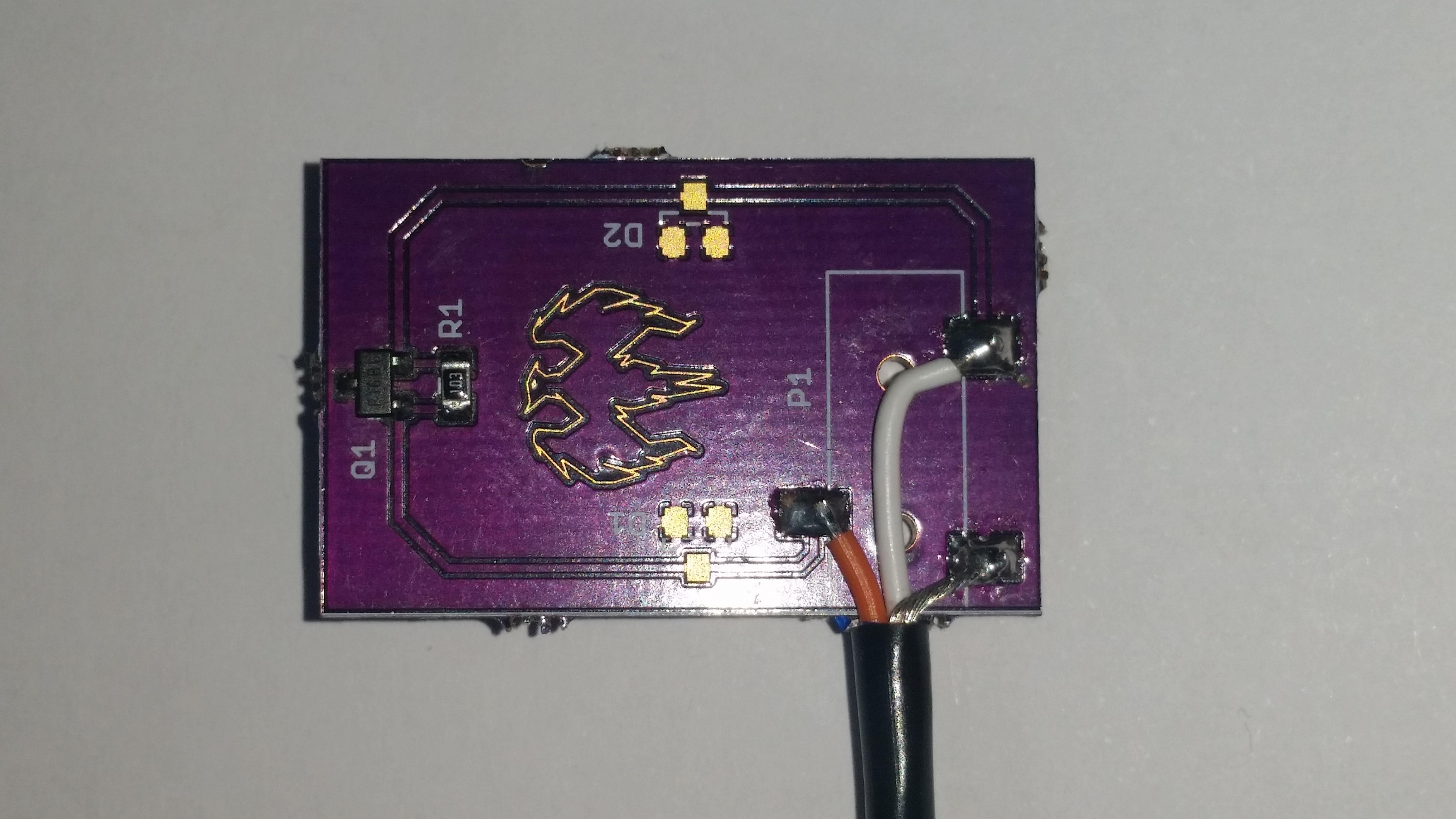

OSH park Magnetic halleffect sensor connection 3.5mm lead
Another question to Mr Pyrimid (i think?)
With respect to the Osh park Roadrunner magnitic sensor PCB, I have looked at the digikey website product info for the surface mount socket- respect to a 3.5mm Plug,
ring (+5v) -----to P ? on PCB
TIP (O/P) ----- to P ? on PCB
SCREEN (GROUND) -----to P ? on PCB
I think I allready have it correct haveing buzzed it out with a multimeter -- but could anyone please confirm the above prior to me applying 5 v to the PCB and sending to heaven if i am wrong!!
Thanks, i dont think my nerves will stand another "surface mount session this week?
Me regards
johnny

I didn't do more experiments to feel which type of sensor is better but both work very well for purpose and intent. With the IR type, you've to make manual adjustment to the on board preset for best usable sensitivity and adjusting for best distance from the platter reflective tape. I used some reflective tape material, not exactly ideal type but it works. As for the Pyramid's hall sensor, I didn't have much choice but slapped a disc magnet under the platter and the sensor board flat under the platter hoping it work and it did work fine. I managed to find individual TCRT5000 photodiode locally and swapped it out at the Arduino IR module (thinking it would perform better) and it worked fine too. I'm guessing there's no performance difference except the TCRT5000 LED is smaller size and look nice. No issues using either type. Due to the VPI Classic design, I intend to use Pyramid's Hall Sensor where I can mount it at the rear left corner. I can't do the same for the IR Sensor. Its a matter of how I want it to look, best hidden away.
