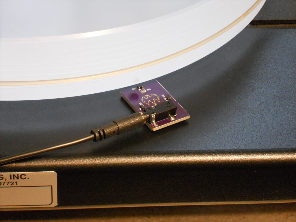

Yes it will. You have to supply 5VDC to the sensor on the "Ring" connection (3.5MM TRS). The output pulse is on the Tip. Sleeve is ground.
I've posted the link to the OshPark site for this several places. The BOM is on the OshPark site.

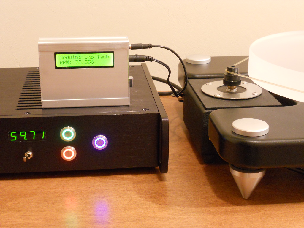

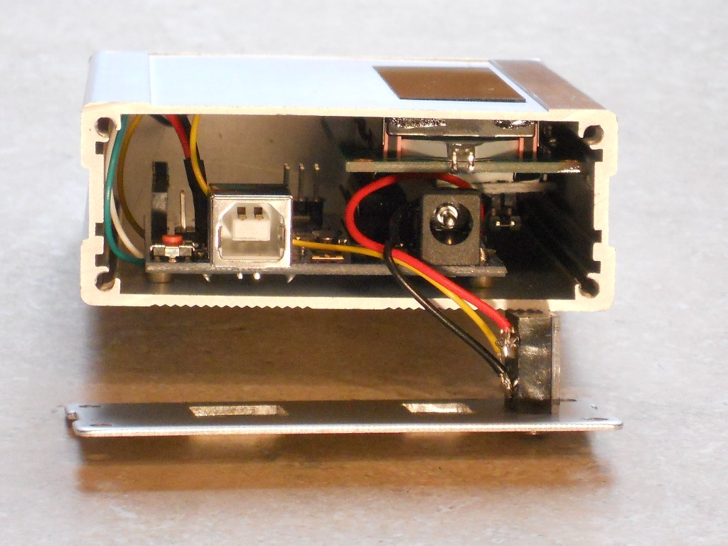

Finally got all the parts for the tach and was able to put it together in a 4" x 3" x 1 1/8" aluminum case that I bought on ebay several years ago for $5 IIRC. I had to remove the analog and power header on the Arduino PCB and I pressed some 2-56 x .125" standoffs into the mounting holes on the Arduino. The Uno mounts to the back of the enclosure with 4 pcs of 2-56 x 1/4" screws.
I drilled and filed a rectangular opening in the front of the enclosure and press fit a 1/16" thick smoke plexiglass window into the opening. The LCD display is then super-glued onto the inside wall of the case, centered in the window.
I ordered the hall sensor PCB from oshpark and attached it to the plinth with double sided foam tape. It seems to work very well.
