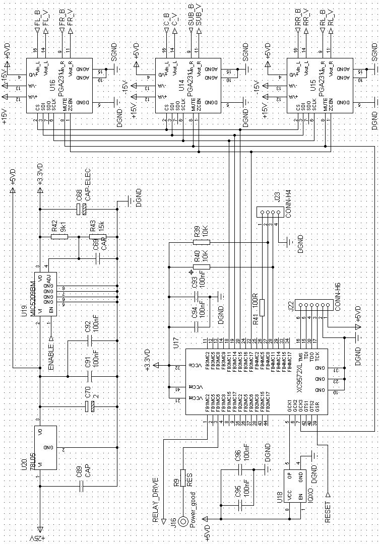

If you could send in s/routines for PGA2310 that 'd be good for a start, but what programmer I mean for PIC u use and what the software?
all could be found on my page linked before. http://home.tu-clausthal.de/~tpa/
the sprut brenner 5 i use is linked there, I use MPASMWIN, free assembler from Microchip. Main diffrence between the PIC16F628 and 877A are the number of pins used and the configuration settings.

I recently came across a digital pot specifically suited for multichannel control. The Ideas for Design article 'Manually Operated Digital Pot Doesn't Need A Microprocessor' explains the use of Catalyst Semiconductor's Cat5113. The circuit is designed around LM339.
Using the idea, DIYs can redesign using other digital pot ICs.
I do not have the Website. Windows LAN/viruses created problem for my MAC and my browser does not store the links. Any body wants the diagram, please e-mail me.

Errata
Kindly read as
The Design Brief 'Use Rotary Potentiometer to Drive Solid State Volume Control" explains the use... ...339
