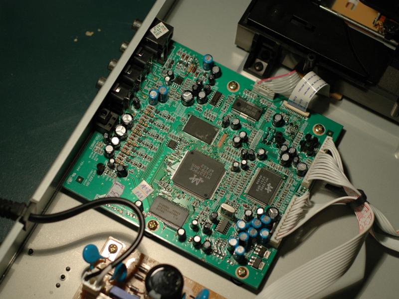

Clarification time.
Got a cheap (eg Apex) DVD player? if so, open it up and peek inside. You'll probably find a miniscule board inside which has a DSP chip of some sort, 4 or 8 megabytes of SDRAM, 1 or 2 megs of flash, a few audio/video codec ICs and not much else. Cables connect this stupid little board to rear panel I/O jacks, front panel user interface, a small switching power supply and the DVD transport.
Now consider what this 'stupid little board' does: it plays MPEG audio/video realtime, plays MP3/WAV/ASF/etc audio formats, displays JPEG and PhotoCD pictures, and possibly more. Half the front of your DVD player is probably covered with icons representing the different things that the board can do.
Now take this 'stupid little board', strip the audio/video codecs off and put on a basic I2S audio interface (no video). Replace the proprietary transport and control interfaces with IDE and RS232. You now have what I'm building.
Here's the insides of my Apex.
Flash chip is an 8-bit, 1MB Fujitsu 29LV800.
SDRAM chip is a 16-bit, 8MB Hyundai HY57V6416.
I'm probably putting 4MB/32MB on the first revision of my board. Call me generous. :D

Now I understand "clearly" what you're talking about.(I was understanding it would be the controller board, but I haven't understood how you would interface it.
