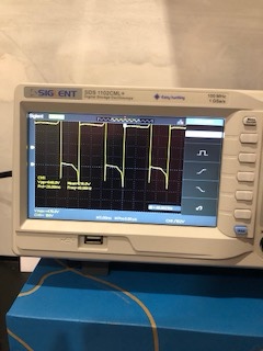

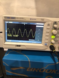

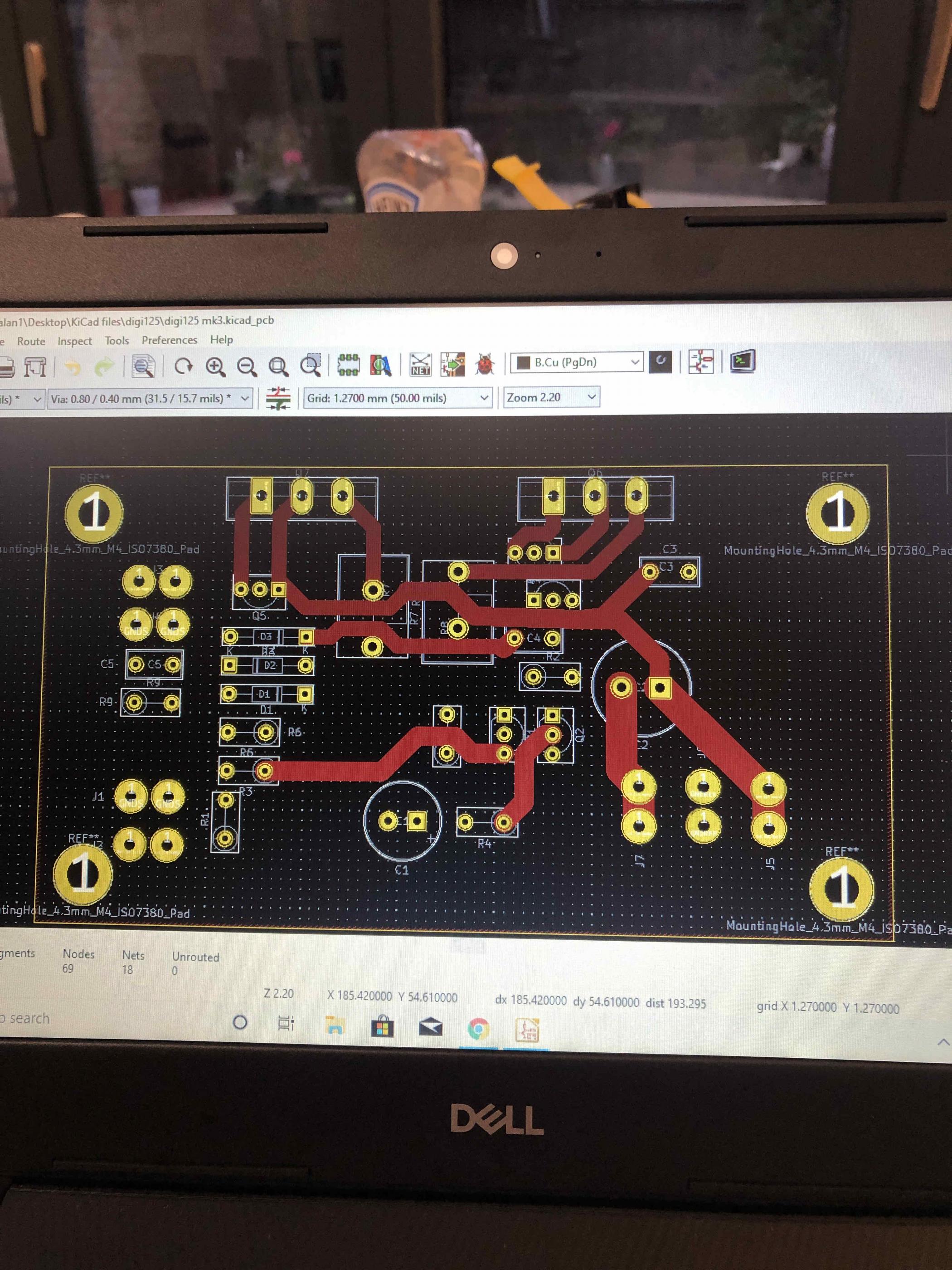

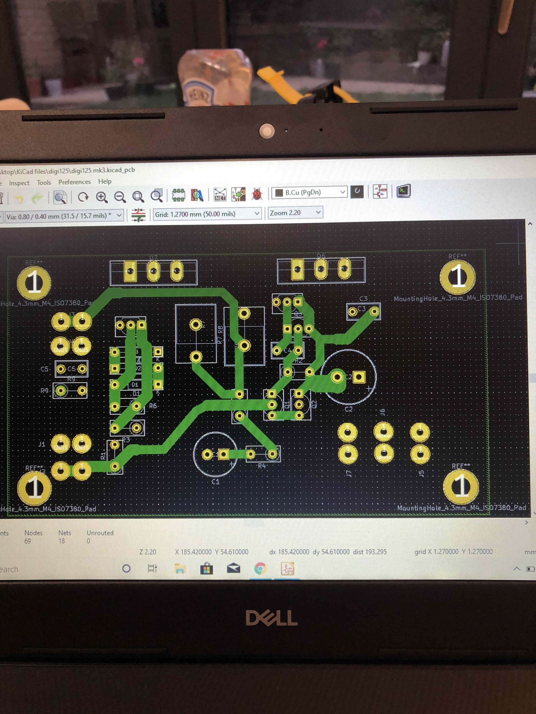

I simulated the circuit Ok, used Kicad and had some prototype boards made (cannot breadboard to save my life!) but when built I’m just getting a 50hz oscillation at the output. I have checked all pin outs on their respective data sheets and confirmed connections are going where they should. I have built a 2nd board with fresh components but still the same issue. Anyone have any ideas that I may not have tried? Thanks in advance.

Is there any transistor getting too hot?
Check also the output if there is a DC value.
If you cannot hear anything just by touching the input wire, probably there is something wrong with your LTP. It was previously mentioned that LTP should have a enough gain for it to work, try using different LTP parts.
Is that with no input?
A1943 is not conducting, check your connections.
Measure your Vbe if Q4 and Q6 is on.
Emitter of Q4 should be connected to Base of A1943 not to the negative rail.

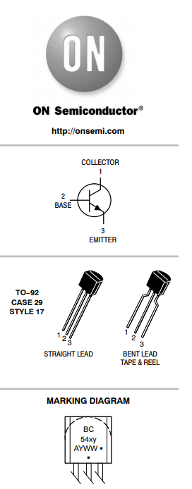

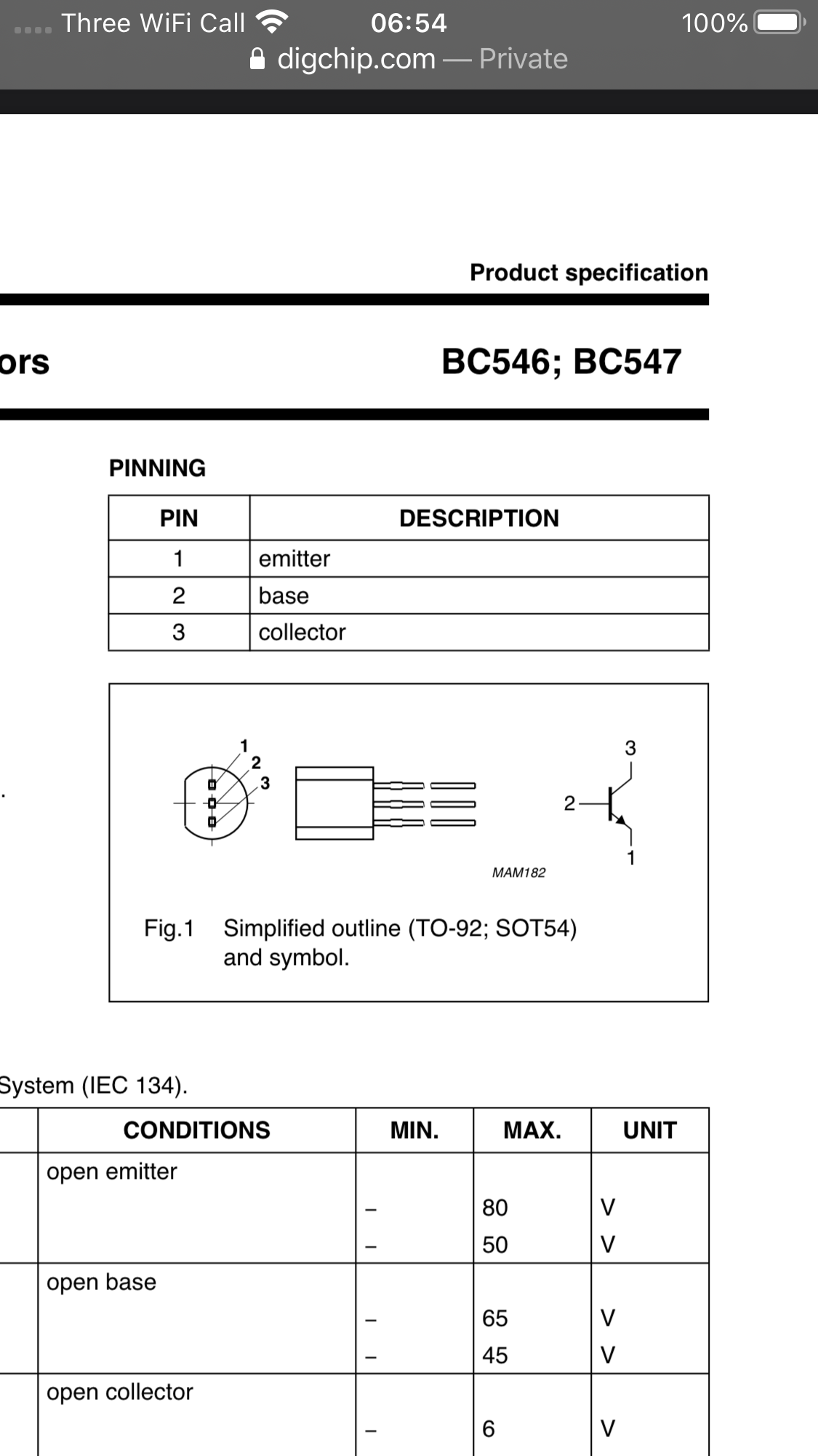

I have attached a snip of the datasheet for BC546 from OnSemi
