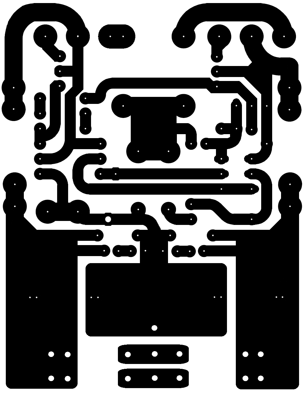

Hi all,
Just in case someone is interested, I have uploaded a PCB (and supporting files) for the DIGI-125 that I designed many years ago. I haven't actually made or tested the PCB but I have had a good success rate so far and wouldn't expect any major issues.
My thinking when designing this PCB was to remain "close" to the original schematic but make the PCB as small as possible, so the amp would compete with a gainclone type amps based on size and cost.
The zip file contains a schematic, a PCB etching file, a couple of stuffing guides, a BOM and a 3D picture.
regards

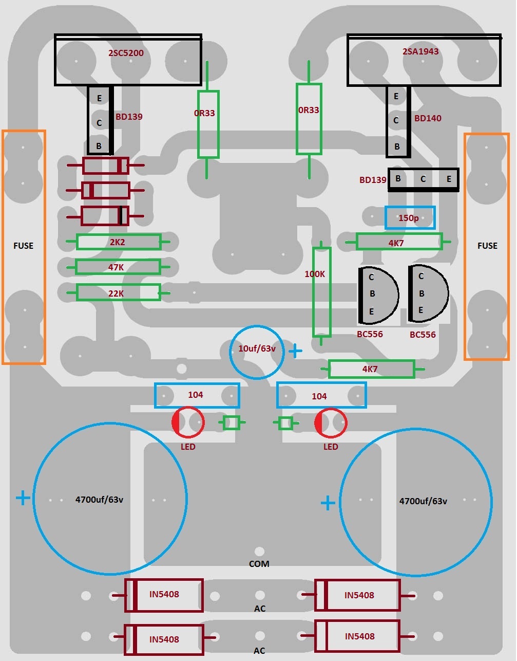

Yes, you can - I used a similar design for my guitar amplifiers.
Use 100pF capacitor around VAS.
Use the THREE diode bias.
Use "Bone's" suggestion to split the 2K2 resistor to 1K2 and 820, along with 47uF bootstrap.
Use BD139 or similar for the VAS transistor - this does get HOT !!!
Use 0.47/5W emitter resistors for the TIP142/TIP147.
It will not be "hi-fi", but it actually sounds pretty good, better than LM3886.
Rakesh,
If you move your BD140 about 2mm to the left, you can then use a simple bended metal heatsink for both devices which will make them both more rigid and reduce any chance of touching each other..... use mica insulators on the devices, of course.
The angled piece need be no more than 1cms on each side, and 1cm deep.
Nice layout!
Hugh
Thanks AKSA Sir,
I have updated the PCB layout accordingly.
Just want to know that as i have changed BC546/557 to BD139/140, will this effects on the performance of this amp when used with 27-0-27 ac Transformer in powersupply.
Will BD139 on the extreme left also need Heat sink.
Thanking
Rakesh Sharma
