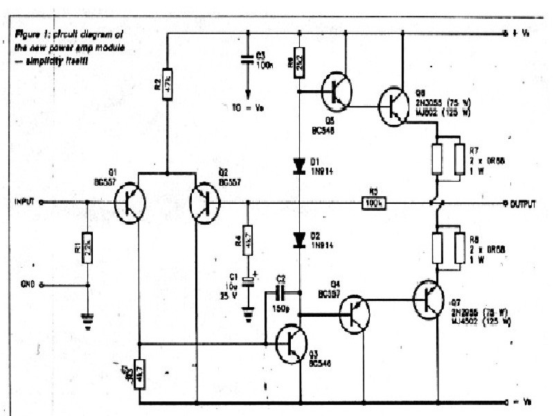

Secondly nobody has suggested any changes or modifications or additions
If Q1 and Q2 are matched for both HFE and VBE, temporarily fit a 10K trimpot in series with the collector of Q2. Adjust so that the difference between the collector voltages of Q1 and Q2 is as close as possible to 0mV. Then replace the trimpot with 1 or 2 MF resistors (series or parallel connected) , chosen to be close to the trimpot resistance used to obtain balance.

I was thinking about building this (Digi-125) for my first amplifier project, as it has the advantage of being very simple and (hopefully) easy to build, while still producing what many have claimed as decent sound. I plan to fab the PC board myself, so as to beef up the inadaquate solder traces as noted by G.Kleinshmidt. I was considering the following mods, some taken from previous posters on this thread, and wanted to get you all's oppinion on them.
- 2SC5200/2SA1943 for output devices.
- BC556/BC546 for the predrivers. BF459 for the VA transistor.
- 2N5401 for the input stage differential transistors.
- Replace the two 1N914's in the collector of the VA stage with an amplified diode, for more accurate control of the bias. Also mount the amplified diode transistor to the heatsink for better thermal compensation.
- Lower the value of the pole cap in the VA stage to 68pF (possibly replace with a trimmer cap for experamentation)
- Add an output inductor and a zobel network to improve stability.
- Add capacitive coupling at the input.
- Add decoupling caps and/or a low pass filter on both rails to improve power supply rejection.
- Metal film 1% resistors throughout.
Once again i am sort of a noob at this so please be gentle. Thank you to all who have contributed to this tread ... it has been a very intresting read.
Sry but I'd rather suggest some more sophisticated design, especially if it's your first project.
Digi-125 likes oscillating (one reason for that is the OP/driver stage has gain), especially with the fast 2SA/2SC OP devices you mentioned.
Try Rod Elliott's P3A or something similar. Choose a straightforward, stable, and TESTED design. Digi-125 with the modifications you mentioned isn't tested yet. You would be the first prototyper! As first project it's a bad idea.
Gain
Sorry, but I agree with Andy. I think you will run into trouble.
If you really want to try it, don't deviate much from the original design and components.
Also,what we thought sounded decent back then, was very different to what many of would regard as decent these days.

hi gain,
If you look at posts #25 and #26 you will see I did similar mods to what you are suggesting. I found the project very satisfying, starting with the basic circuit (with 2SC5200/2SA1943) and changing or adding extra features as suggested by members on the forum.
I found that increasing the bias and adding a bootstrap to the VAS made the most difference, the other changes only made minor improvements.
I changed the VAS trnasistor from a TO92 because it got hot.
So, if you are more interested in learning about amp design and building then do what you suggested, if you want a guaranteed result look for other options.
Soundwise, the final result was surprisingly good, but not in the same league as SandyK amps.
WARNING: I only ever tested with 25 volt rails.
regards
The output transistor choice is good.
I don't know how he got away with those little BC transistors for drivers, you could try ZTX653/753 as beefier but still small package. You could also try ZTX653 as the VAS transistor.
Keep the BC transistors for the LTP as they have better noise performance and gain than 2N5401.
Using an amplified diode is a good idea.
Using a trimmer capacitor for stability is probably a bad idea, I dislike trimmers be them capacitors or resistors, unless absolutely necessary as they can go noisy.
By the time you add the other modifications you have changed the amp quite a lot and you might as well throw the Digi-125 name to the distant memory.
The output stage does not have voltage gain, only current gain. The oscillation problems may have been due to lack of Zobel and poor PCB design.
Feel free to add your mods, but as has been pointed out by experienced tweakers already, make sure you do things incrementally so you can observe the differences.

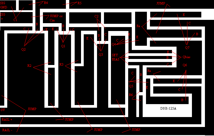

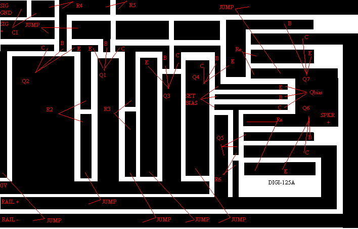

warm greetings all. i have finished a first draft of the layout for the PCB i plan to fabricate for the DIGI-125. the ONLY difference from the original circuit is the addition of a bias transistor, however by simply soldering two 1N914's across the E and C terminals for Qbias you have the bone stock circuit.
the black areas are the copper. all comments welcome and appreciated.
thank you
