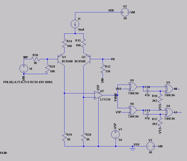

Hi All,
not to hijack the good thread, but then I didn't want to start a new one just for this.
Working on a self-clocking board for the egan half-bridge module, I came up with this scheme to drive it.
Although phase is split twice, the idea is to keep timing under control. Due to Sunday brainfog:xeye:, I'd appreciate comments. Notes:
- left out for clarity: feedback network, feedback for PS rejection, supply bypasses, current source and obviously the power module.
- Forget the ground symbol at VSS. System ground is mid-supply (VM).
- The LT1719 is real fast (4.5ns) and comes in a small sot23-6 package but I am thinking of a more standard package just to keep (slower) options open.
- the XOR split-and-deadtime circuitry is actually part of the egan module (it has a PWM input).
- The power module uses 5V for logic input and gate drive.
Thanks again
E

...I am not 100% convinced that you definitely need U7, except you have really small signals at the BJTs.
In fact, there is redundancy overall: Compare; split and level-shift; re-compose a PWM; split again, and finally dead-time. I could put the comparator first, then level-downshift the PWM. But it would need two low-voltage rails around ground to feed the comparator... Other ways I tried (I know; I'm limited:xeye:) to re-compose the PWM at the bottom of the differential pair invariably result in phase-asymmetry, hurting the output DC level which needs feedback to correct... Didn't like that.
What is the egan half-bridge module going to be?
Well it's still developing, it uses EPC2001 eGaN FETs plus driver and DT control, all packaged in a 10-pin SIP module. Haven't updated its own thread in a while...
How about...
R7 = 560
R8 = jumper
R9 = 1k2...1k5

Try LT1711, nearly the same performance while it provides already symmetric outputs, perfectly time matched. BTW I'd be a bit affraid using a comparator that fast without any hysteresis whatsoever.
I decided to use the LT1711 as one of my private standard comparators, because it appears to be an almost perfect comparator including the option to run the output stage at +/-5V.
In the beginning I was also afraid to get 'ambitious output reactions' in applications without hysteresis, but even when running it on a bread board and using a noisy triangle it worked fine to generate pulses down to approx 10ns without uncontrolled panic at the output. Amazing device.
Please note the LT1719 does have a small hysteresis build in, could be the reason for elevator's choice.

[...] the LT1719 does have a small hysteresis build in, could be the reason for elevator's choice.
Yeah, that small hysteresis sounded comforting:) Since for this particular board, 5V is ok and complementary outputs are not needed, I'm also looking at the LMV7219 and the slower, pin-compatible LMV7239.
