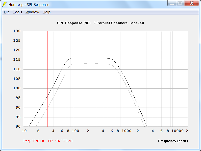

I just showed a pic of a simulation of a tapped horn single vs stacked. It doesn't look like an improvement to me. I can show you a dozen other pics of other models of tapped horns that will look quite similar and a dozen examples that are much worse when stacked.
I agree that stacking changes the response. As far as "improves the response", that depends entirely on whether the change is viewed as an improvement or not. Clearly the flh sim I showed is an improvement, while I would not consider the tapped horn sim I showed to be an improvement at all. (But as I mentioned, this particular tapped horn does not measure as the simulation indicates - not sure why not - so this may not be a bad thing for this particular tapped horn.)
I've simulated some of Danley's tapped horns and seen measurements. Clearly those were designed with stacking in mind (at least as a possibility, not as a necessity). Those tapped horns do improve when stacked. This is not true of all tapped horns though, and not necessarily true of any particular example of any alignment.
If you want to argue again that Hornresp is not accurate for simulating multiple cabs, I'm not interested in going down that road again.
Hi just a guy,If you want to argue again that Hornresp is not accurate for simulating multiple cabs, I'm not interested in going down that road again.
Arguing is not necessary considering the words of the creator/writer of HornResp:

I think what you are saying here is that there is no problem whatsoever with the response curve shape prediction but there may (or may not) be a problem with directivity (depending on overall dimensions, which could theoretically change the measured response).
If that's what you are saying, it makes no difference whatsoever if you simulate a stack of 8 speakers or one large speaker with 8 drivers, 8x the chamber size and 8x the cross sectional area of the horn flare, as long as the mouth shape is the same in both instances (and as close to circular as possible). And that stands to reason, since there's really no physical difference (except the stack will have dividing walls, which doesn't really change anything, since we all know a single large speaker can have dividing walls called bracing with no detrimental effect).
Djim is arguing that this is not the case and the Hornresp multiple speakers feature is inaccurate.
Just to be sure, I simulated the same tapped horn model I did a few posts ago as a stack of 8 with the multiple speakers feature, captured the results, and then redid the sim as a single speaker with 8 drivers, 8x the chamber volume and 8x the horn flare csa. Then I compared the results and they overlay perfectly.
This means the multiple speakers feature is no less accurate than the regular simulation mode. As I said previously.

As I mentioned the last time we discussed this, if you take the time to simulate what you build ACCURATELY and make the mouth shape as close to circular as possible, the sims will be very very close to the measurements. Much closer than we have any right to expect. This has been proven over and over again by people that take the time to simulate accurately, as I mentioned, soho54 did this all the time and proved it to be true. Unfortunately he's MIA so he can't add to this discussion.
As far as I can tell, the only issue being argued here is directivity of a large mouth (or combined mouth) but this is very old news by now. It's been repeated over and over that as long as the mouth is not ridiculously large in comparison to the wavelengths in the passband and care is taken to make the mouth (or combined mouth) as circular as possible, this is NOT an issue. Even if you COMPLETELY mess up the mouth shape the worst that can happen is the on axis measurement won't match the sim, but the power response is still accurate.

David, please correct me if I am wrong (anywhere) but the current HornResp approach is basically modelling a larger enclosure with a larger driver in a different acoustic environment. This approach means that all drivers, ports, mouths ect fully operate in the same enclosure volume and the same hydrodynamic nearfield since every element is considered 'one'. The response of the 'multiple speakers' function, is therefore the theoretical sum of the radiated power of the multiple drivers coming from 'one' system. HornResp does not use a specific model that actually models the complexity of ‘mutual coupling’ that is different for each type of enclosure but also different for each type of array-setup.
Mutual coupling means the extent of the 'hydrodynamic nearfield'. More important is that mutual coupling is determined by the distance between two or more sound sources. For instance, with the current HornResp method both drivers act like 'one'. It means the distance between the two drivers has become zero and they fully operate in a combined pressure zone (hydrodynamic nearfield). In reality the drivers of two mutually coupled tapped horns have a physical distance of at least 2 times the distance from driver to mouth. This distance is too large for the drivers to operate in a combined pressure zone. For the 'taps' the distance with the current method is zero again. In reality they have distance of at least two times from 'tap' to mouth. Although there is still a significant distance, often it is 'close' enough to speak of a combined pressure zone.
The Hornresp multiple speakers model considers just one of the speakers in the array, but with the input voltage and acoustical loading for that single speaker adjusted as necessary to reflect the multiple speaker configuration specified by the user.
Mutual coupling is taken into account to the extent that the resulting bass enhancement at low frequencies is seen in the Hornresp results.
The paragraph below is an extract from a description of mutual coupling of loudspeakers given on the following website:
proAV / data and information, lists, tables and links
" With two loudspeakers next to each other at a distance of more than the wavelength of the reproduced frequency the average measured volume on-axis and off-axis adds up for +3dB (double power). With two loudspeakers close enough to get mutual coupling the volume adds up for +6dB. "
The results produced by Hornresp are consistent with the above description (6dB increase in radiated power at low frequencies and 3dB increase at high frequencies) - see attached screenprint.
Kind regards,
David

Hi David," With two loudspeakers next to each other at a distance of more than the wavelength of the reproduced frequency the average measured volume on-axis and off-axis adds up for +3dB (double power). With two loudspeakers close enough to get mutual coupling the volume adds up for +6dB. "
Consistent in summing coherent signals? That is not what I see for Tapped Horns in the results of the "multiple speakers" function.
Just an example:
Measurements do show a 'consistent' gain of 6dB...
