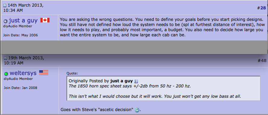

Difference Between 1850 and 186 FOLDED HORN!!!!
Yes i meant 140 @1m !! lmao In terms of measuring my music, ive tried various genre's and most of them will reach down to around 34hz.
I've seen a bunch of measured dub type music that hits 27 hz (and sometimes but rarely even lower). If you only need to get to 34 hz that opens up the options, there's a bunch of horns that can do 35 (IIRC).

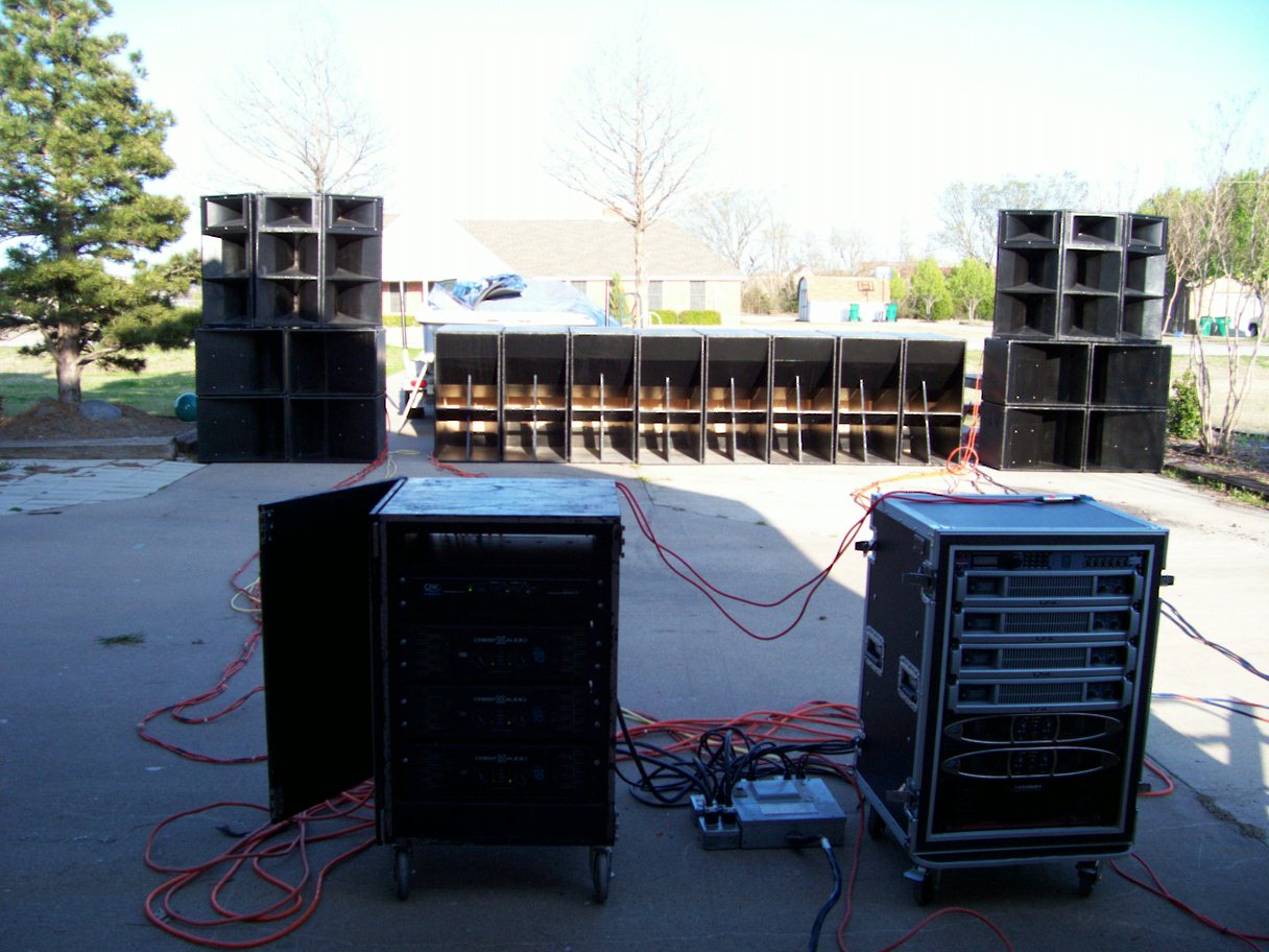

140 dB 30 Hz open field system (110dB at 100 feet), and what it takes to power it. Note the #6 240V feed (which would need to upgrade if you were a long way from the pole)
You're right - it would be an ongoing project. This was started in 2001 and finished in 09. I ended up building something a bit more sane to actually do 1-night DJ gigs with (subs the same form factor as the T36, but with real response to 40). But that is fixing to be 'upgraded' with four of Xoc1's TH18 to get better power handling. Already have the TBW100's. If they end up putting out more at high power than the labs do, there may be more of them on the horizon.

I live in farm country (actually I live on a farm) and it's pretty unusual to have a plug within 100 feet of an open field. There are two open fields around our house, one is about 300 or 400 feet from the plug to the nearest point, the other is probably 800 feet or more away.
The point here is that attempting distances of a couple hundred feet or more with regular extension cords and this much power is a recipe for starting a fire or just generally breaking something.
