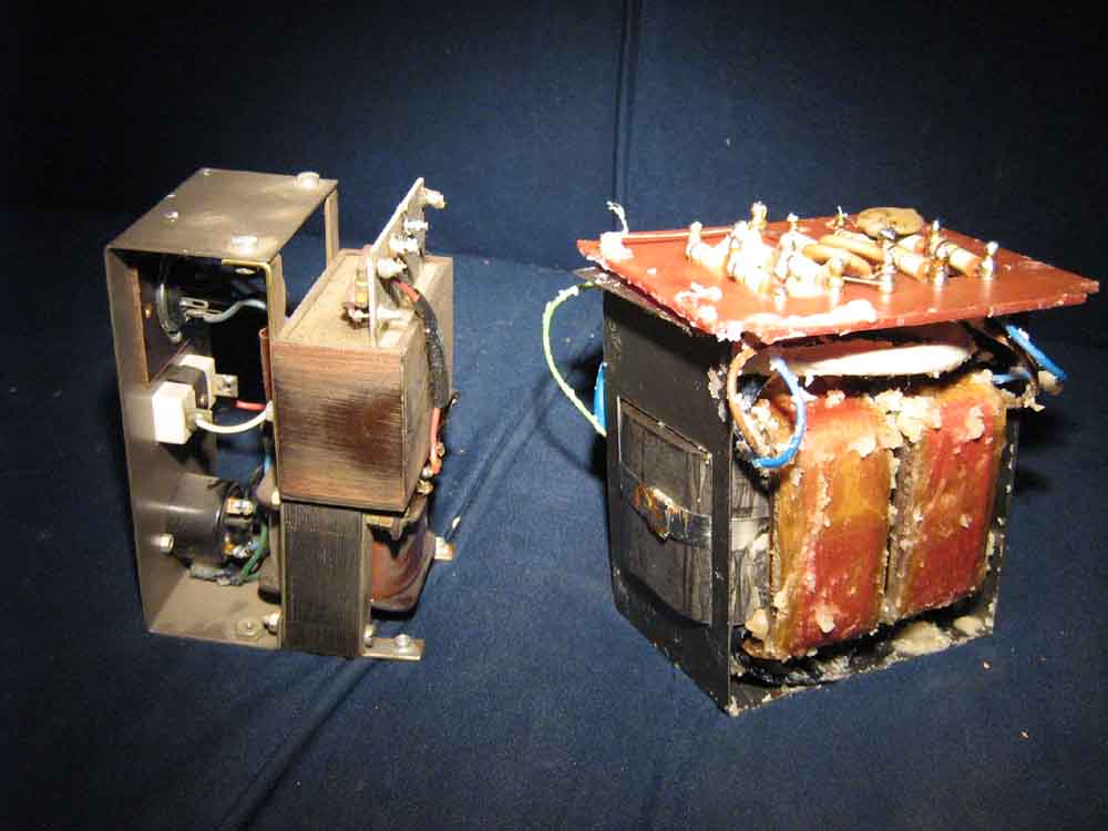

Maybe I can give it a try with this one, and either use one from another panel later, or buy another single unit from ebay...
Any thoughts on this?

That's quite a find. Have you got them working? Here's a page from Sheldon's website that you may find interesting. Take a look at his Quad ESL Book for service info and schematics.
Yes I've got them working.. Only thing is I find the treble panels really great (not to say incredible :bigeyes: ), but the bass panels don't quite thrill me.

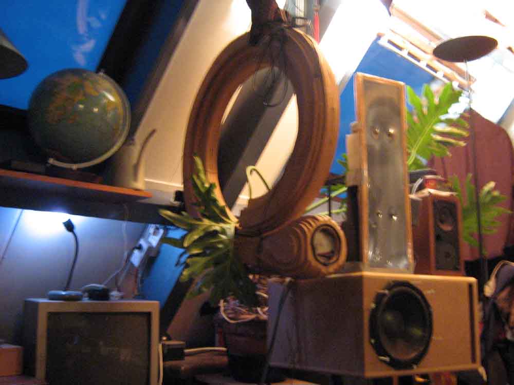

I changed the bass panels for a dynamic speaker in a transmissionline enclosure (got these subs from a collegue who designed them). The basspeaker measures 10" and is from the brand "precision devices". My collegue had the drivers custom built with custom thiele and small parameters (and rubber surround, a real hifi speaker). He sold me the drivers for 150 EUR. and I got the cabinets for free...
It's the sound I'm listening to at this very moment that inspires me to experiment with it more myself.:eek:
I've looked at Sheldons page, he also uses a transmissionline sub with the DIY ESL 1.0 , very interesting info on the quads too! :angel:

Here's a pic from my present speakers (only the ESL and sub underneath are connected offcourse):

v-bro: Yesterday I put the spare step-up device in the oven to melt out the sort of paraffin grease. It looks like a pretty neat tranny
in there...
They are pretty good transformers. But I would suggest to pour the stuff back in, as it will do a great job preventing electrical breakdown (it's bee wax).
