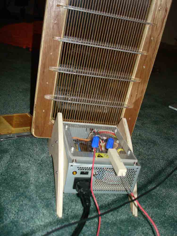

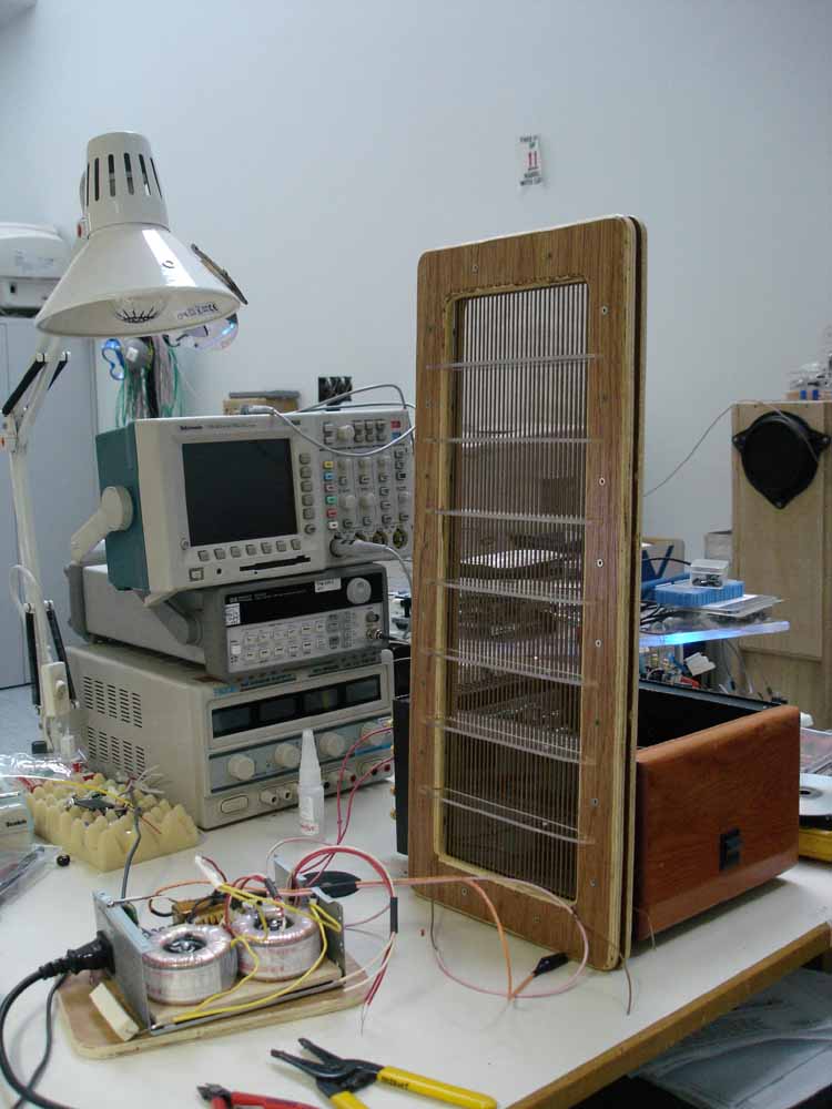

..Wonderfull ..
.. i really cant find anything to dissagry with anyone . you have all made strong and justifiable points . now i can even make some additional conclusions .:
. every maker uses his own ink compound and membrane, it only happens that to achieve same specs they have to use more or less the same chemicals . they seem to use Mylar like film 4~8ì and that carbon black thing wich conducts, with waxes to melt at a temperature and stick to paper . so exact properties for our use of a given product cannot be known until after purchase . luck is not something i like to mess with when it comes to money ..
. given the films commercial width dimension it is almost impossible to strech it mechanicaly and have acceptably wide panel . heat streching will not give the tension most people say they desire . .
. it is nice for long term stability the coating not to reach spacer . impossible for this ink film matterial . but . i feel that with high resistivity coating and a small point contact to charge membrane its difficult to equally distribute the charge over the entire surface , especialy with voltages above 3 some Kv's the charge fly's away to the air leaving less charge on surface as you go further from that point . i noticed this with my high res. graph coating where my screwdriver was sparking at the membrane near the perimeter but not in the middle area . thats why i used the "diffuser ring" approach to minimise this effect compromising long term dirt-leakage stability (i dont realy care for a 30yr use). one could use "dust cover" approach as QUADS do maybe compromizing clarity ..
. my main goal here was to have a nice "free" ride wich makes it even more enjoyable for my specific personality . zero money were spent for an astonishing to my experience result and the film discovery was a great solution to a big problem for nothing . i was limited to 15ì packaging film and graphite and now i have 4ì Mylarlike factory coated film @ favorable resistivity i can immediatly use . seems to me like a gift from above ..
.. i will now refilm other panel with depleted ink version to hear how 4ì's sound .

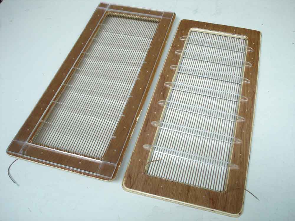

I don't think it is much of a problem if the conductive ink extends to the (inner-)spacer. But it would be nice to remove part of it which is 'on' the spacer. So you won't have any conductive parts that stick out of the sides of your ESL and touch the frame assembly. Since the frame is usually made from wood (conductive) you don't want any conductive membrane to touch it.
The easiest way is to glue the membrane first on the uncoated side (best adhesion!). After that you can remove some of the ink with for example thinner (outdoors, unhealthy vapours). You can reduce stray capacitance as well by not driving the area which can't move.
.. and presto .
. here it is . the depleted thinner version .
. not opaque any more . ~1MÙ @ 1 inch
. carefull listening will show vertues regarding sound detail.
. at 1st minute listening i'm pleased enough.
. film resonance is low, somewhere it can't hurt my feelings.
. i surely need 1mm aditional d/s distance and some more charge to make some room for bass notes to feel more comfortable.
. overall its way better than graphite regarding performance and ease of use.
. cheers
. cheers

v-bro said:Also the stators apear to be made of non conductive material (DMM works fine on real resistors, it's a Fluke 10...) I guess the stators are fitted with conductive layers inside the panel.
Yep, there is some kind of graphite paint under the grey isolation paint ojn the inside of the panels. And only 0.5 mm between that and the membrame See the need for overvoltage protection ?
Only the panel is put together with rivets and I fear I will damage the stators with drilling them out.
You're right, be carefull with drilling, the plastic melts easily fromthe heat generated. Also the rivets tend to turn along with the drill bit.
Better use a pair of small pliers to pinch them twice, under 90 degree angle, then you can push them out to the other side. Worked fine for me. I replaced them with M3*8

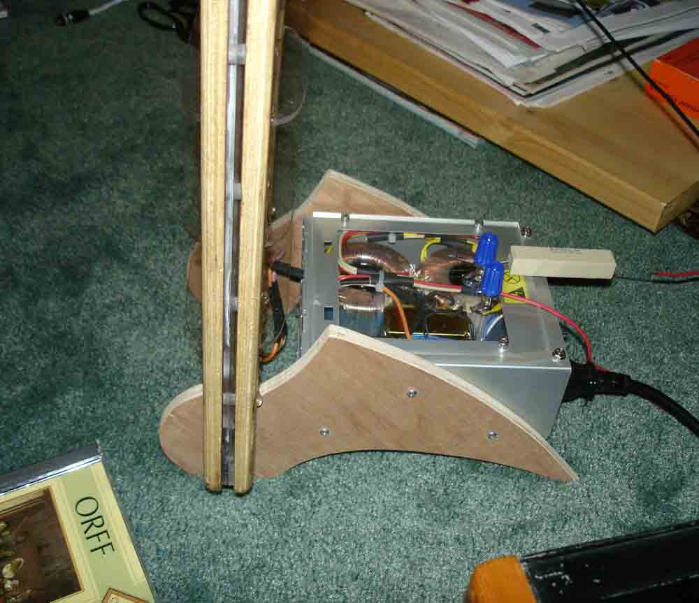

tmyr: Do you have a high value resistor between your power supply and panel? That actus as a barier to slow the charge migration into and out of the power supply and makes the cell work in "constant charge" mode. It's not as big a deal with high resistance coatings, but with really low resistance coatings like the fax film (f'ing brilliant by the way, and I just threw away two rolls of the stuff) it does get more important. I have 20 megohms on my big panels.
A comment about quality: Quality stuff can be critical to success. For example I bought Seas excel woofers for my transmission line bass modules. I was concerned with how well the bass would integrate with the panel even at the couple hundred Hz I was planning on using (130 Hz now). so I bought the best performing woofer I could find, regardless of cost (within reason). It turns out that I wasted my money and could have gotten as good a performance from the lower Seas metal cone line.
I bought transformers from roger sanders, which are pretty plain looking EI core units but he said they really were quite nice. After getting the speakers built, I bought a set of Plitron toroids and swapped them in. For my 130 Hz and up, there wasn't much of a difference at all. In fact I've still got the EI core units in place and the Plitrons in a box.
Quality is important and in many cases it can make your life easier, you can buy your way out of limitations from lesser products. But in many cases, the price difference is for features or aspects that aren't important for your intended use. I suspect if I was building a full range ESL, the plitrons would kick the living snot out of the EI core trannies, but above 130 Hz they don't. And the multiple copper shorting rings that I paid for in the Seas excel woofers are for better midrange performance which I'm not using.

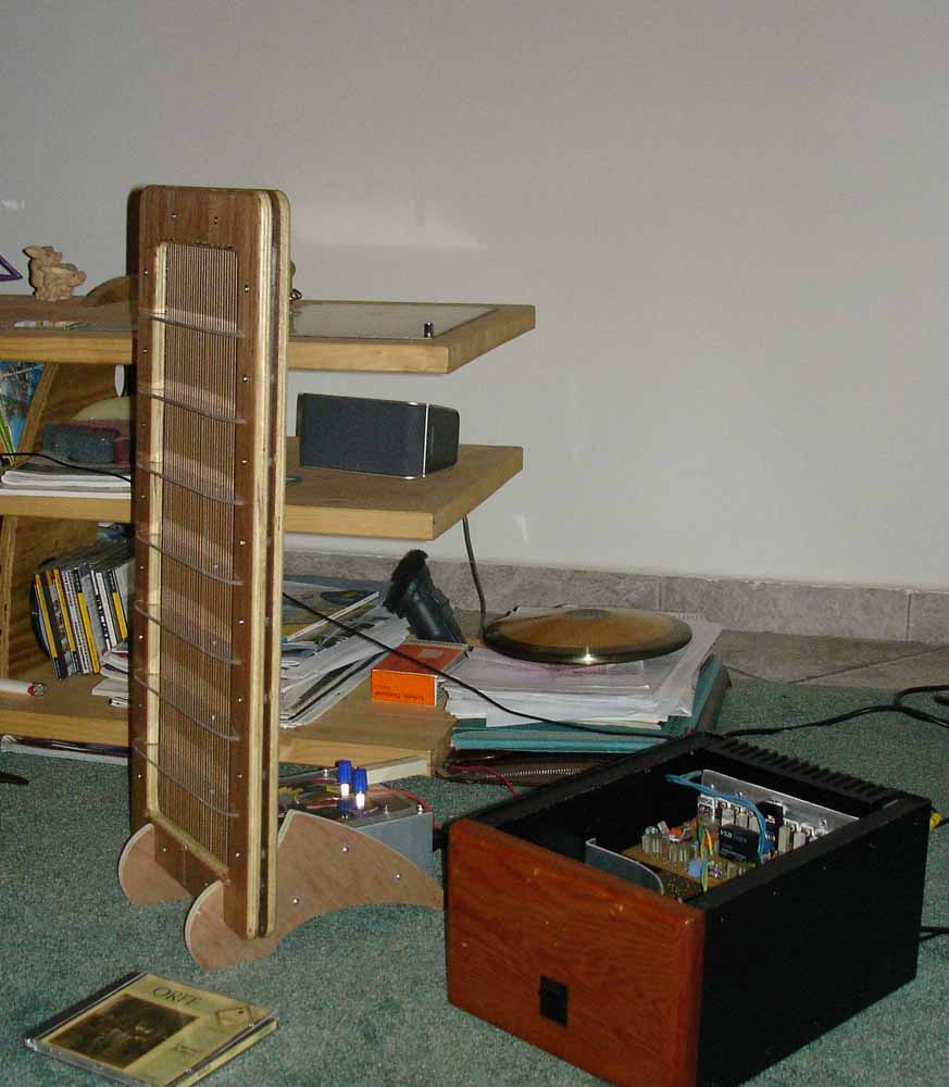

.. aaa a baffle is a very interesting accesory and it does lots of work preventing compressed air from the forward movement of the membrane go around the frame and hit membrane at the back helping forward movement some more . simple words aerodynamicaly speaking but this is the case as i persive it.
using it helps extend bass region (less dipole canselation) and reduce membrane movement thus more spl in general _if u have the additional amp power that is..
such a baffle should be heavy as it is hit from both sides with opposite air presure and is prone to vibrate.
my experiment showed the bennefits of a baffle and the weeknesses of a light carton constraction.
the whole idea is not that beautifull . maybe thats why people dont use it much . but is very effective..
can make your esl sound bigger depenting on the size of that baffle ..
stokessd .. yes i use a "DALE ROX-2 40MÙ GK" cyan in color big (for hv) resistor .. another nice find at work.
